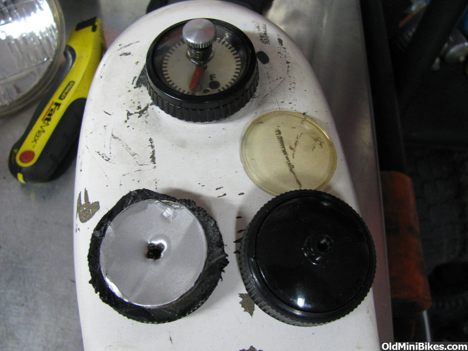

Like mark said, Kelch made most fo them, I never heard of them replacing parts, I "made" a vented one as an experiment for my Bonanza. It took 3 caps to make one, and it was not something I want to do ever again :1orglaugh: the plastic is all formed/glued/melted together even to the metal cap.
After doing it this way I may got at it a different way with a new kelch cap thats still avaiable. They still sell one that that uses the correct face that 'naza caps had (different outer ridges on the cap though) but it is much longer. If my idea works, it will only take 2 caps to make one instead of 3 :cursing:
