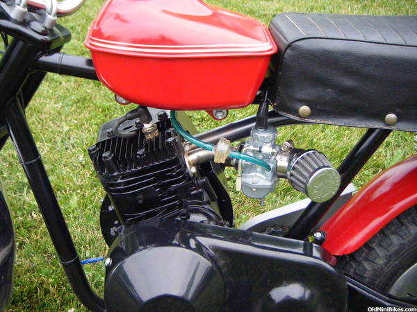

This is how I like my carburetors to look like on a Tecumseh on my Rupps.
