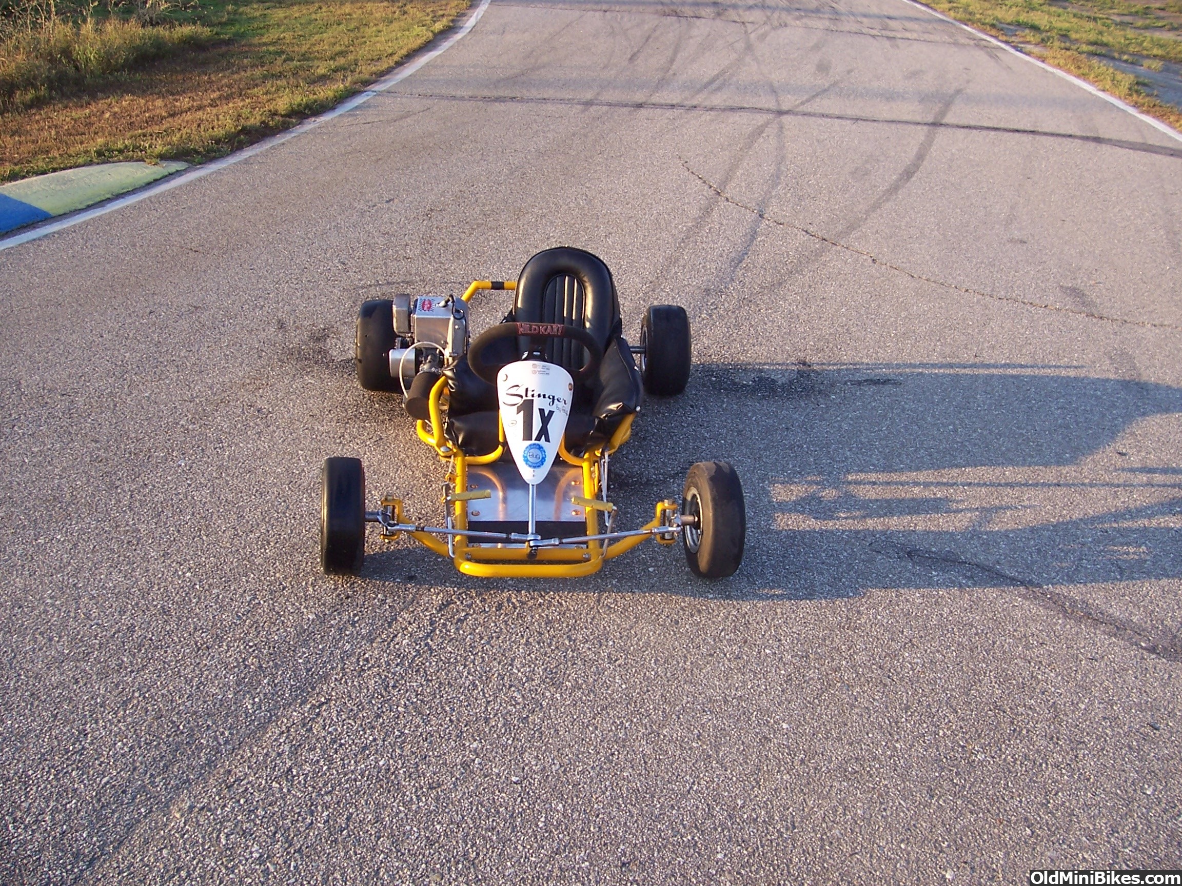

That looks very nice chainsaw, I can see the frame extends past the front axle considerably more. Mine is a competition orange color (which would indicate mid- 70's?)The tabs are there for the motor mount. I just need to cut off the "twin steel chair leg mount" on there and clean up the tubes.$2700 for a repop. Wow. I paid 13% of that.I guess I did alright. Thanks guys.
#9
Some one did a good job mounting that engine without messing up the frame. Mine came from the factory in blue, just like the yellow better.
