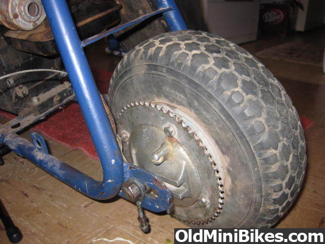

no. I am using the axle that came with it and looks similar to this.
OldMiniBikes.com - Discount & Replacement Mini Bike Parts
I am not sure but if i were to use a nut on each side of the tab i definately wouldn't have clearance for the brake drum to fit into the retaining post. I do see your point however about the axle being locked in place with that method.
It might also be the spacing in between your brake hub assembly and the the wheel bearings them self. If that space is not deep enough for the internal axle hub parts to come together other stuff will hit first... Brake shoes pushed horizontally into the face of the drum, or outer brake hub pinched against the brake drum....
If you take the wheel off and assemble it in your hands.... Can you lay the brake hub in your hand and place the wheel into brake hub, with the axle ran through it like it all belongs in the bike... and SPIN the wheel in your hand by holding the brake hub, and MAKE FOR SURE that the wheel IS spinning on it's bearings correctly WITHOUT something rubbing? :shrug: That will happen and need to have a washer or shim of some kind to push them apart so the offending part no longer rubs wherever it is rubbing...
YOU ALSO need to keep in mind when building axles to make SURE that whatever washer or shim you use in spacing parts DOES NOT rub on the face of the wheel bearing itself... :doah: The very inner most piece of the wheel bearing is the ONLY PART of the bearing, wheel, and any other moving parts that is allowed to make contact with another bushing, shim, washer, frame.. any NON MOVING parts..
You have to make sure the pieces that are supposed to be stationary and bolted tight.. DO NOT make contact with any of the pieces that roll and move.. :thumbsup:
ANOTHER THING that will bind up is the bearing it self being over tightened.... :glare: MANY wheels do not have a bushing as a spacer IN BETWEEN the two different wheel bearings... :doah: Sp even if you have all of your spacing built correctly and everything works beautifully... When you tighten down the axle, the guts of the bearings get pushed out of whack, and causes it to bind... :glare:
