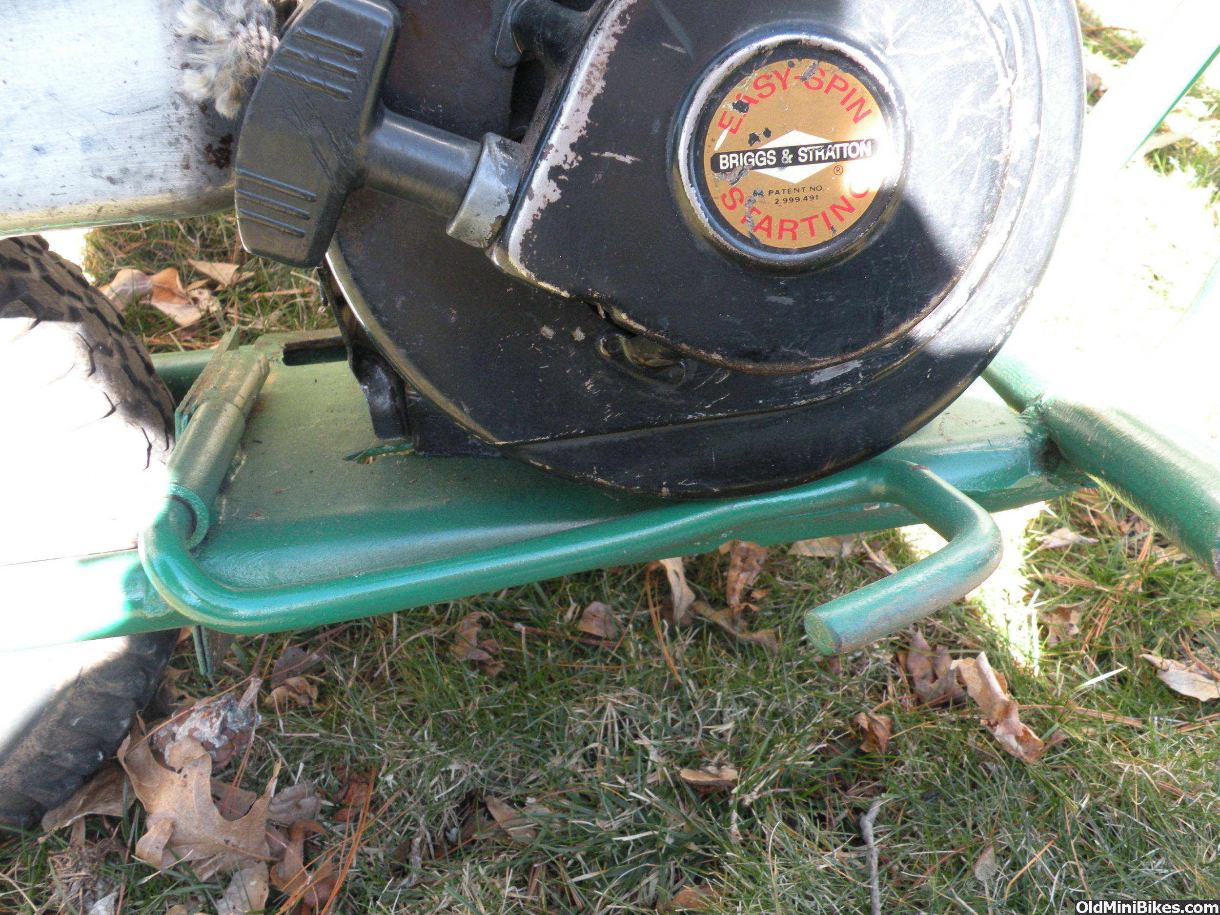

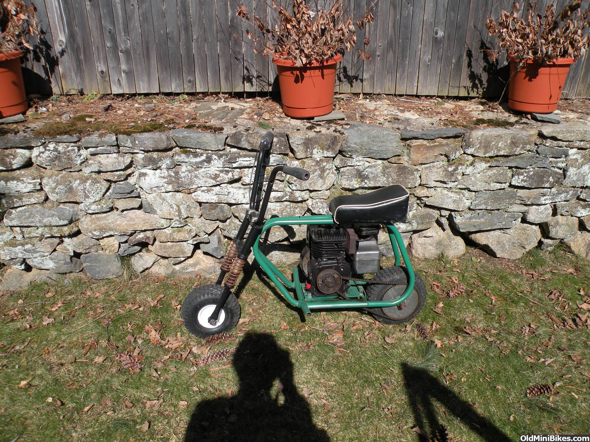

It has a 1965 Briggs and Stratton 5hp engine, which doesn't look to be original because it's an extremely tight fit. I just repainted it and stripped it down to bear metal so I am sure this green is the original color or is at least very close. The foot pegs have been moved forward from the center of the big to accommodate the large engine. I am not sure if the handle bars and forks are original because they were orange or red when I stripped the paint, and that doesn't really go with the green frame. This thing had so many layers of paint it was unbelievable. Here is a pic.

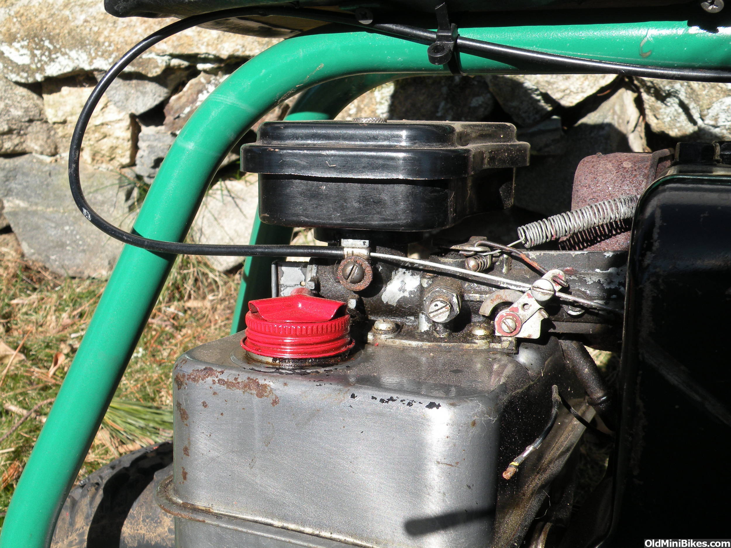

It looks to be a Cat of some kind.. You should get a few more pics more close up of the engine and engine cradle and stuff.. What is the model number on the motor?

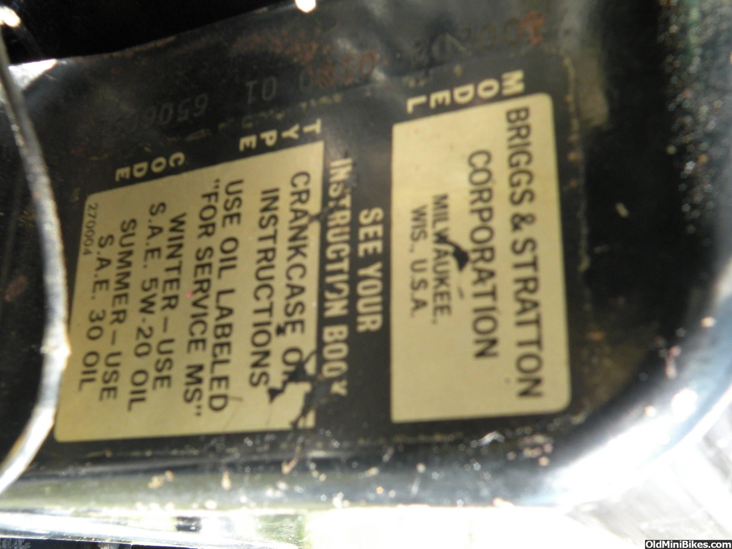

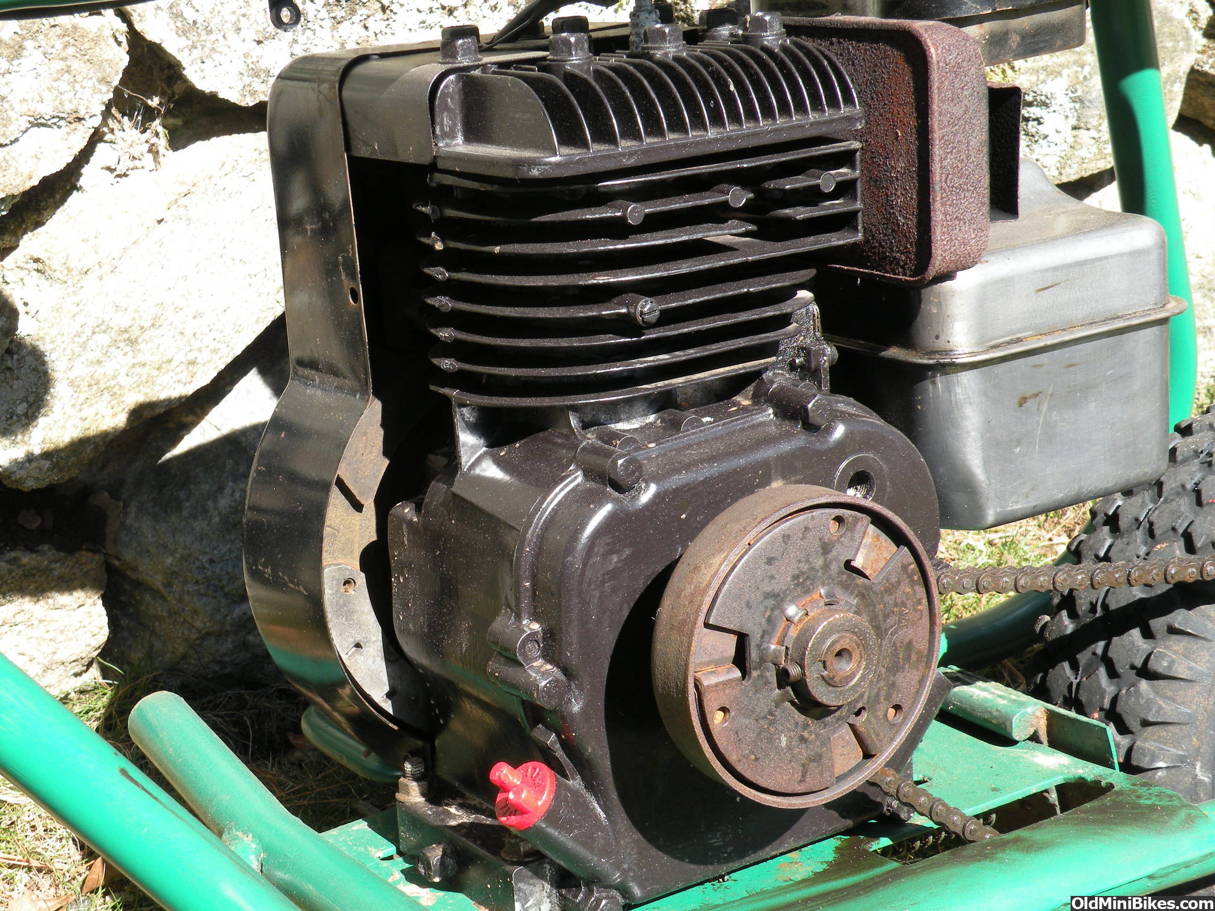

here are the rest of the decent pics that are on my computer. The engine series is 100202. type:0180 01 . Let me know if you want a better pic of anything.Thanks
code:6506091.
Looks like a 250X frame. ????????forks. The engine should be a 4hp, going by the model#.
Thats what I was thinking too.. The forks don't look right for a Cat, but it's a smaller Cat frame I'm pretty sure.. 250 probably.. :shrug: The engine is a 4 horse if it is the correct shroud on the motor.. It looks like it might be.. It looks pretty old..
like ya said, 65XXXX makes it a 1965 .... 10XXXXXXX in the model number makes it 10 CC which is the 4 horse power engine.. You can confirm by looking at the cylinder head.. 5 horse engines are 13 CC's so the head is also marked with a 13 in the back left corner.. 4 horse engines are 10 CC so MOST of the heads are marked 10 although SOME don't have any mark at all.. If it's the 10 head or unmarked it's the 4 horse head and it's a high compression head.. :thumbsup:
