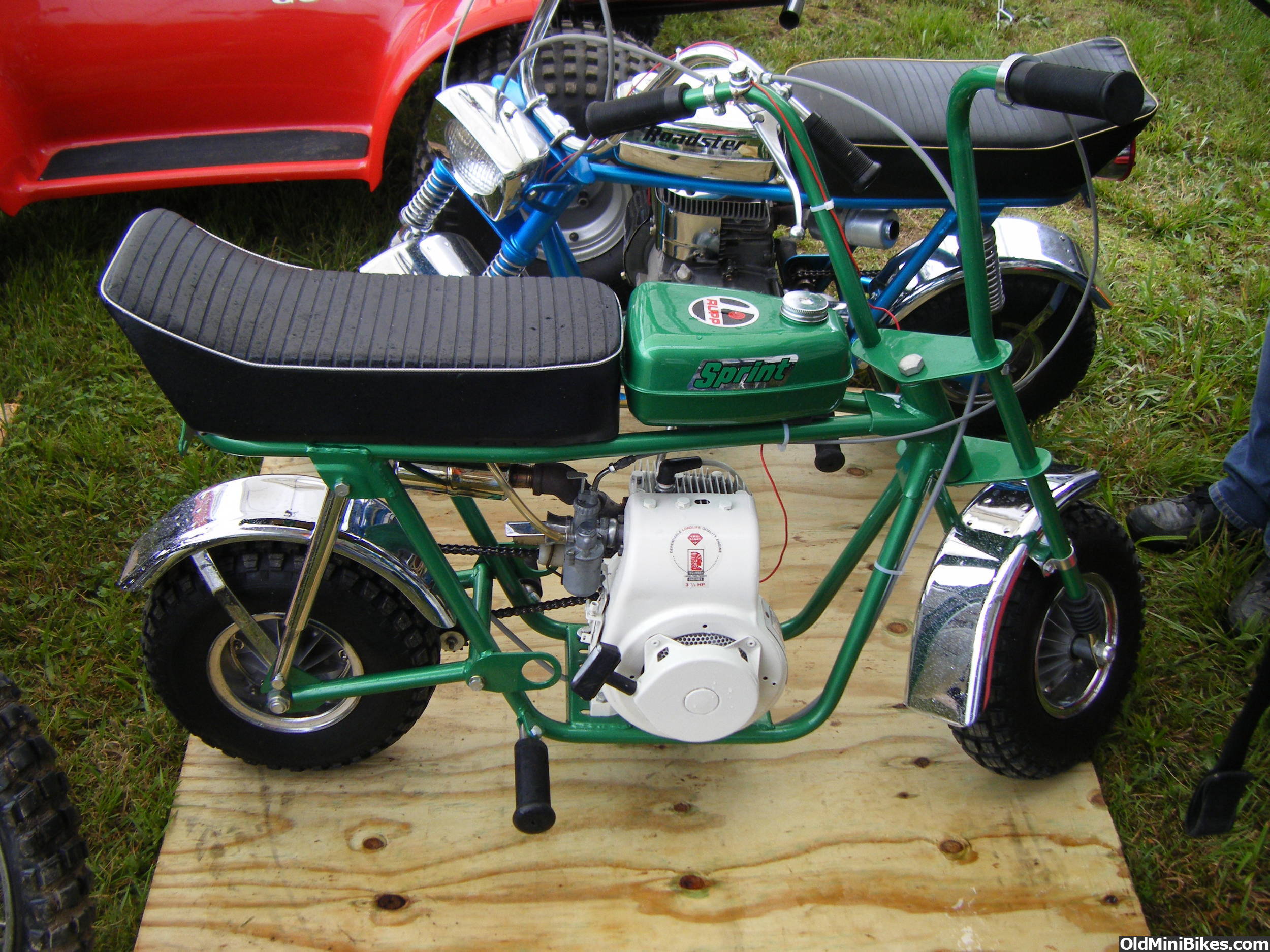

Brandt from Ruppparts is running his Sprint with a Dellorto,The engine was a good running engine when he got it,He put the Dellorto on it and its been having no issues since. Its has a H35 on it.
