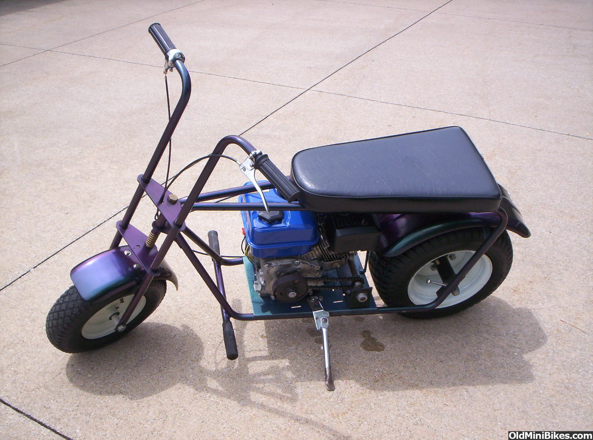

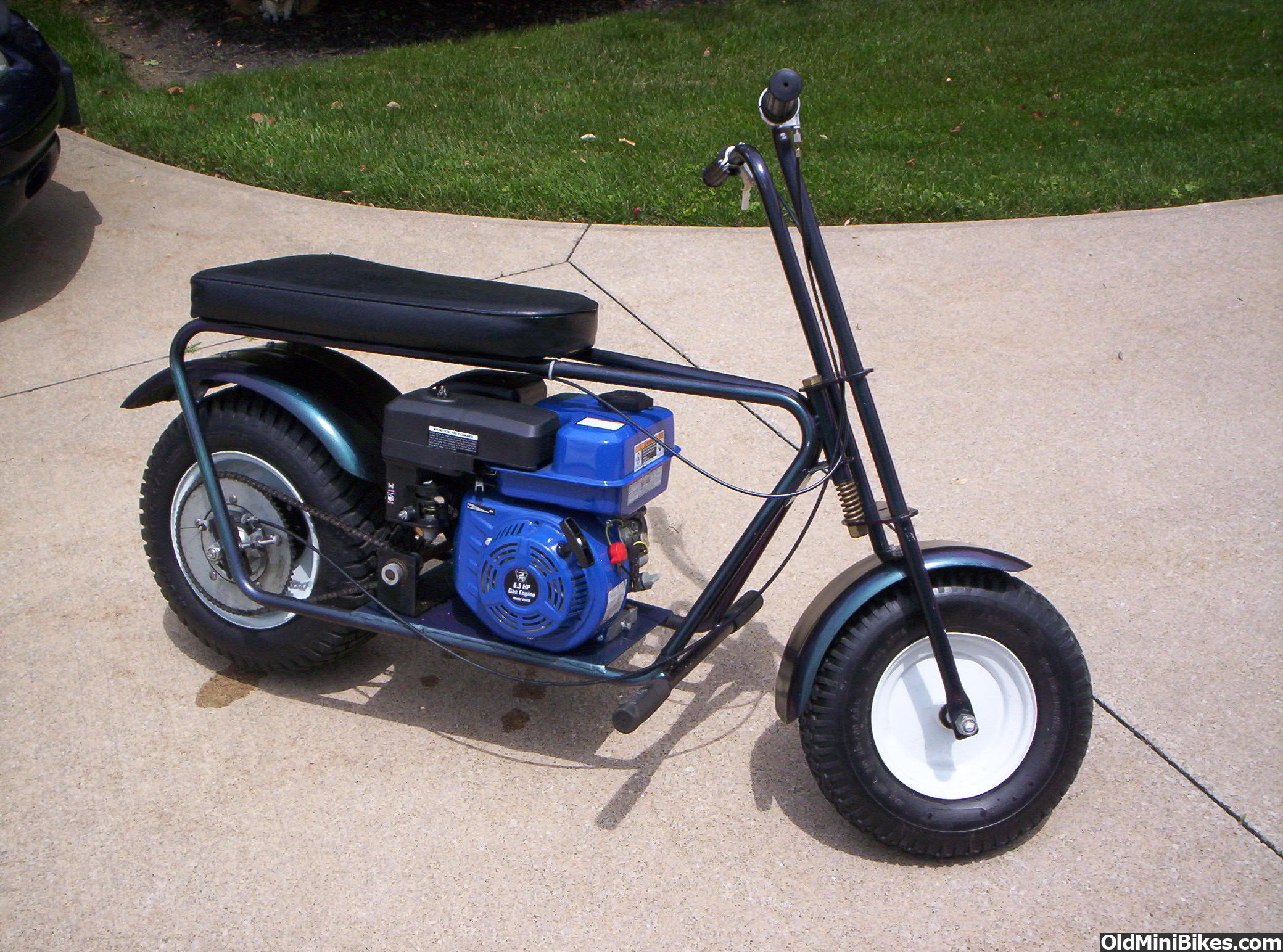

What motor are you running on it ? I personally have a boonie with a clone on it.. and my sprocket sizes are 12, 12,14 72 . And it pulls like a horse and is pretty damn fast
