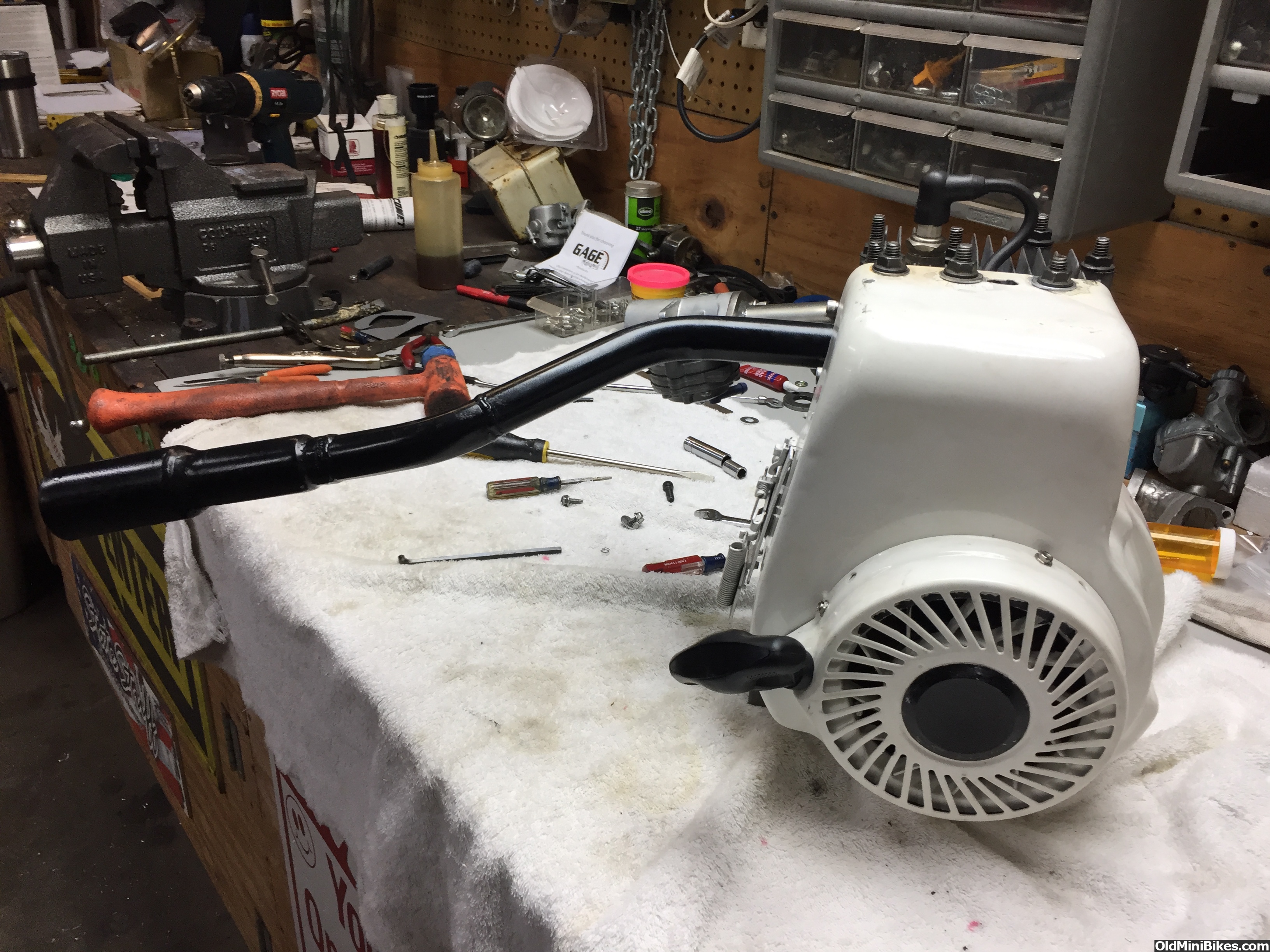

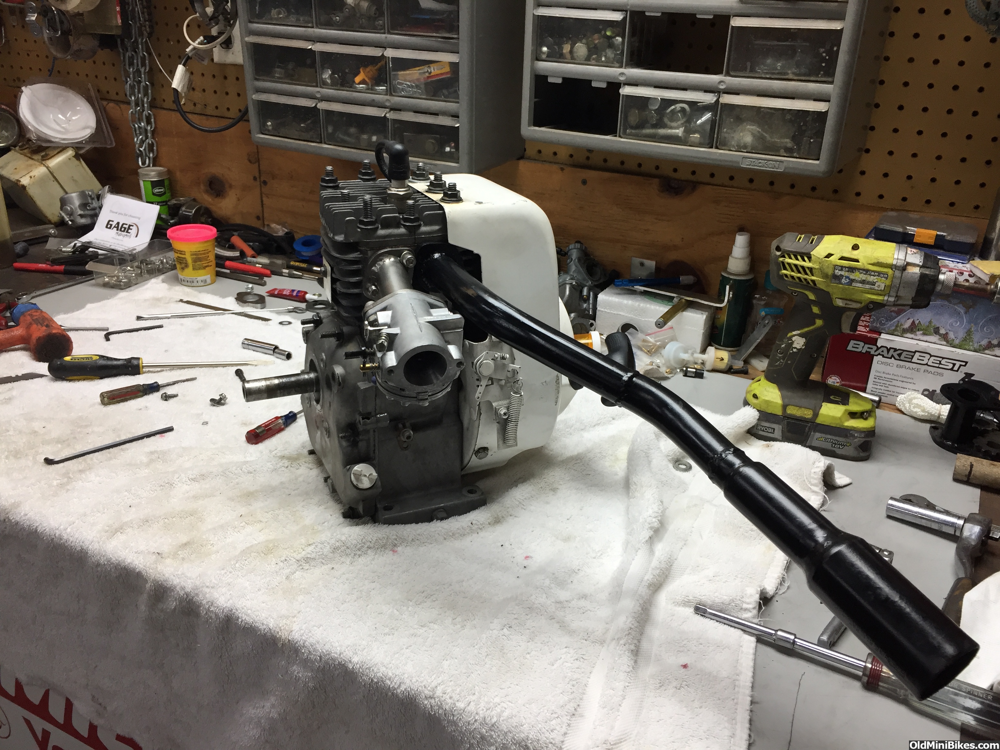

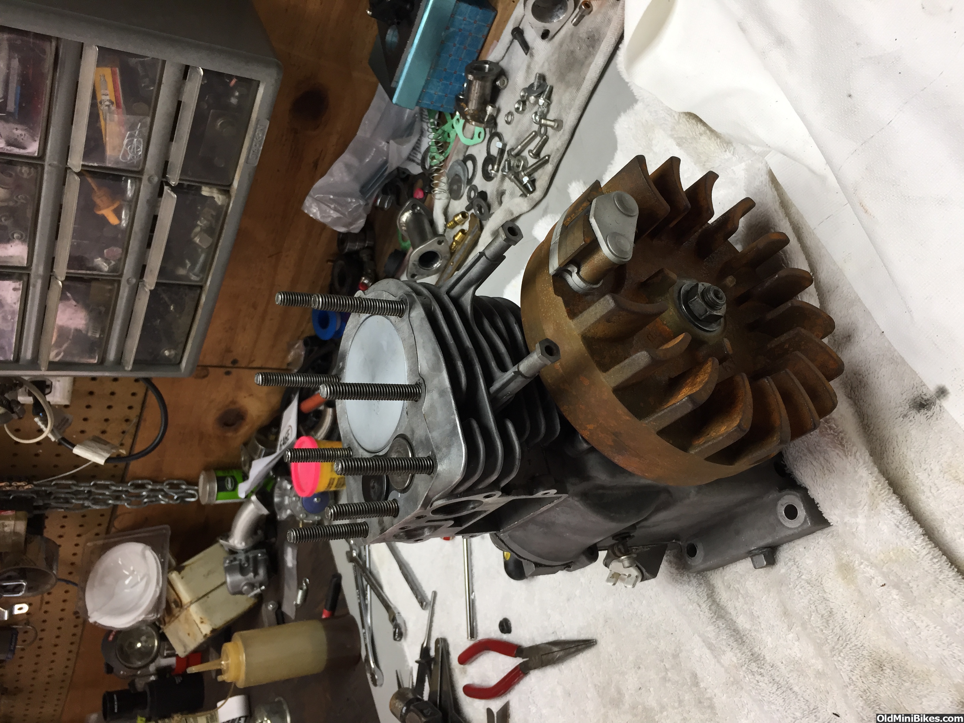

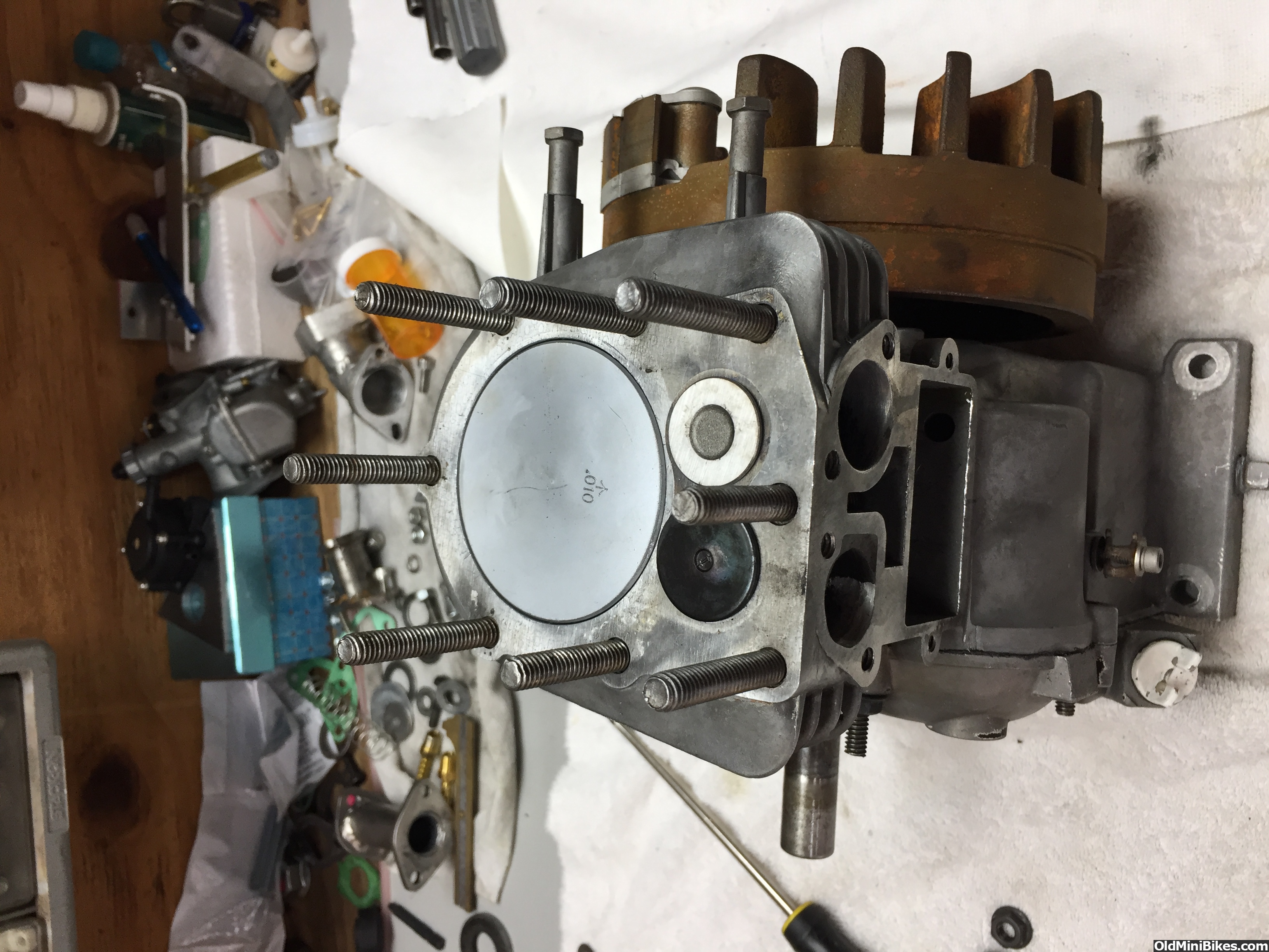

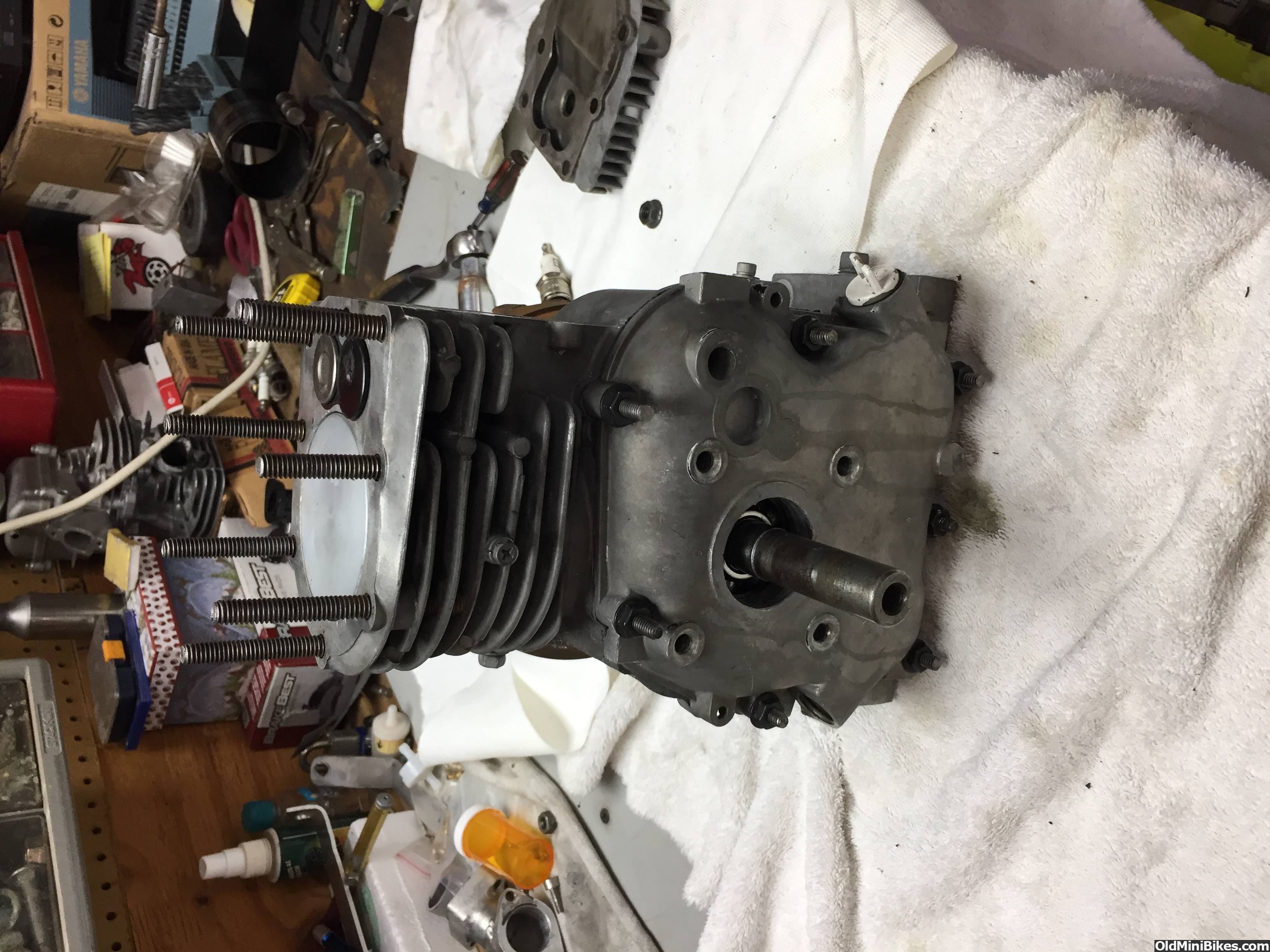

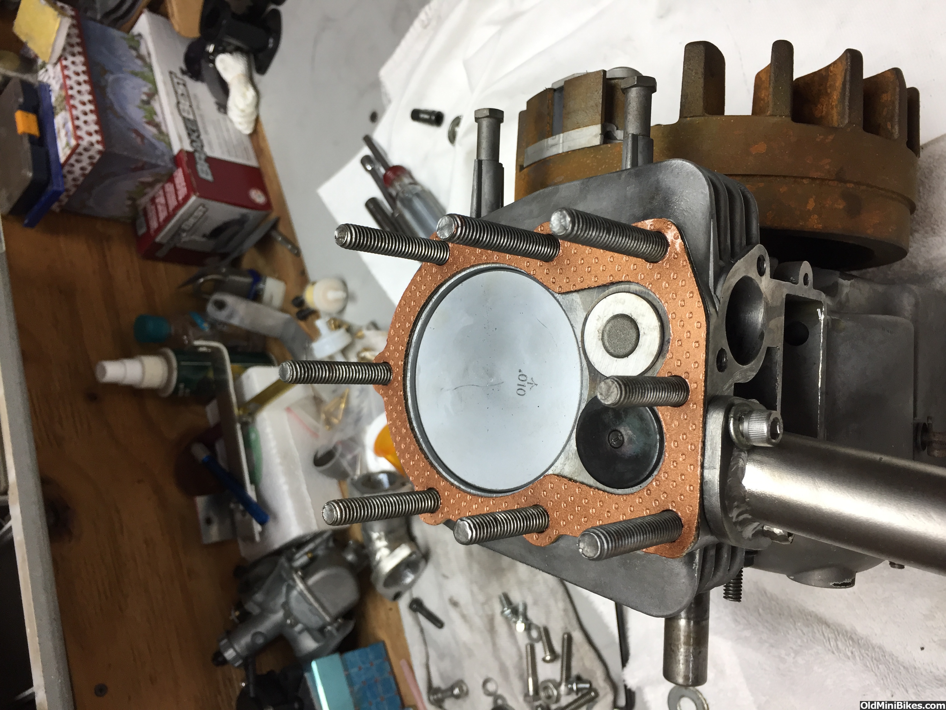

I've had this little HS for awhile now . Last time I did some port work I didn't pull it completely down and got some trash in it and scored the piston and Cylinder. So I had to find a 10 over TEC piston which took almost 2 months. I got her back together today .

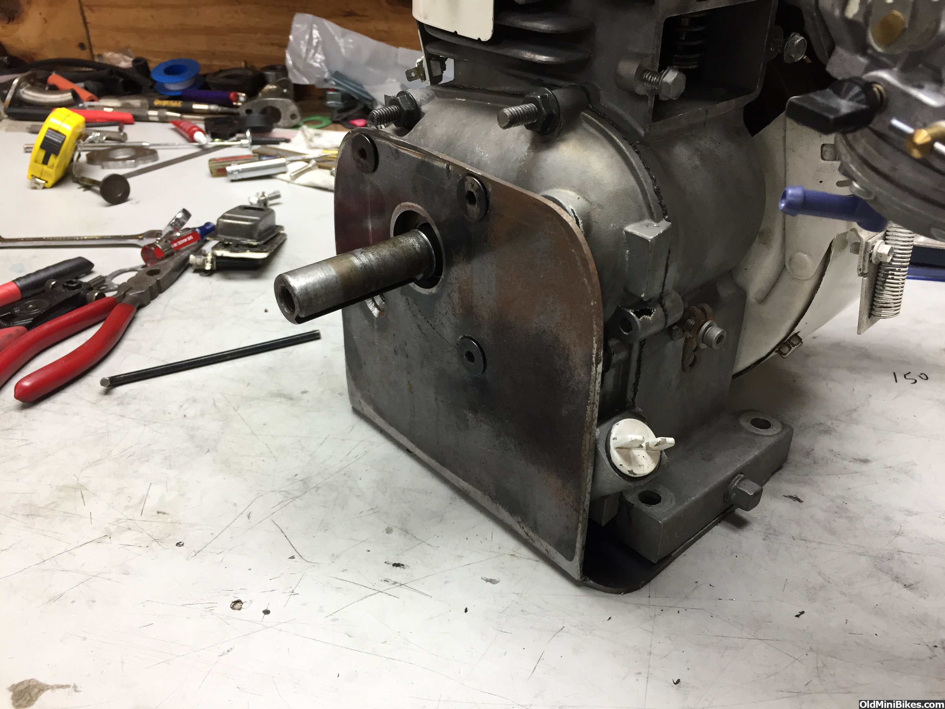

This motor is pretty much stock besides some different parts that are in it . Which are a ARC billet rod and a dyno 255 cam . Also running new stock springs that are shimmed some , should get 7 k out of her this time around . The intake port has been epoxied up and reshaped to round and the back of the bowl has been filled . The exhaust post has has the bowl epoxied and ported , and yes it's still there .

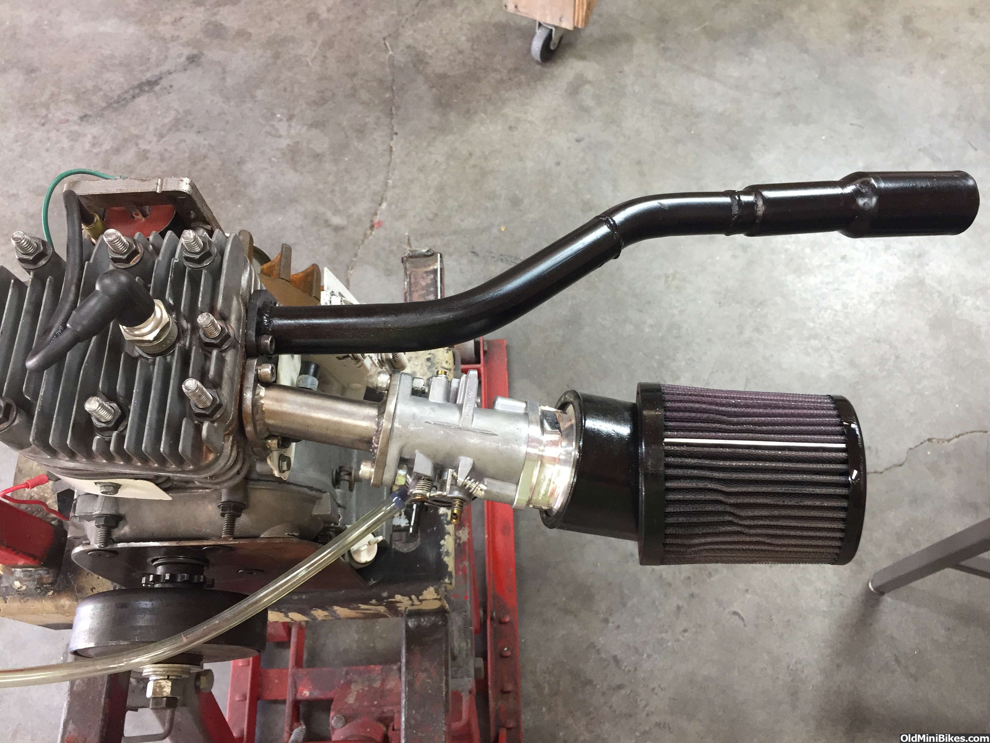

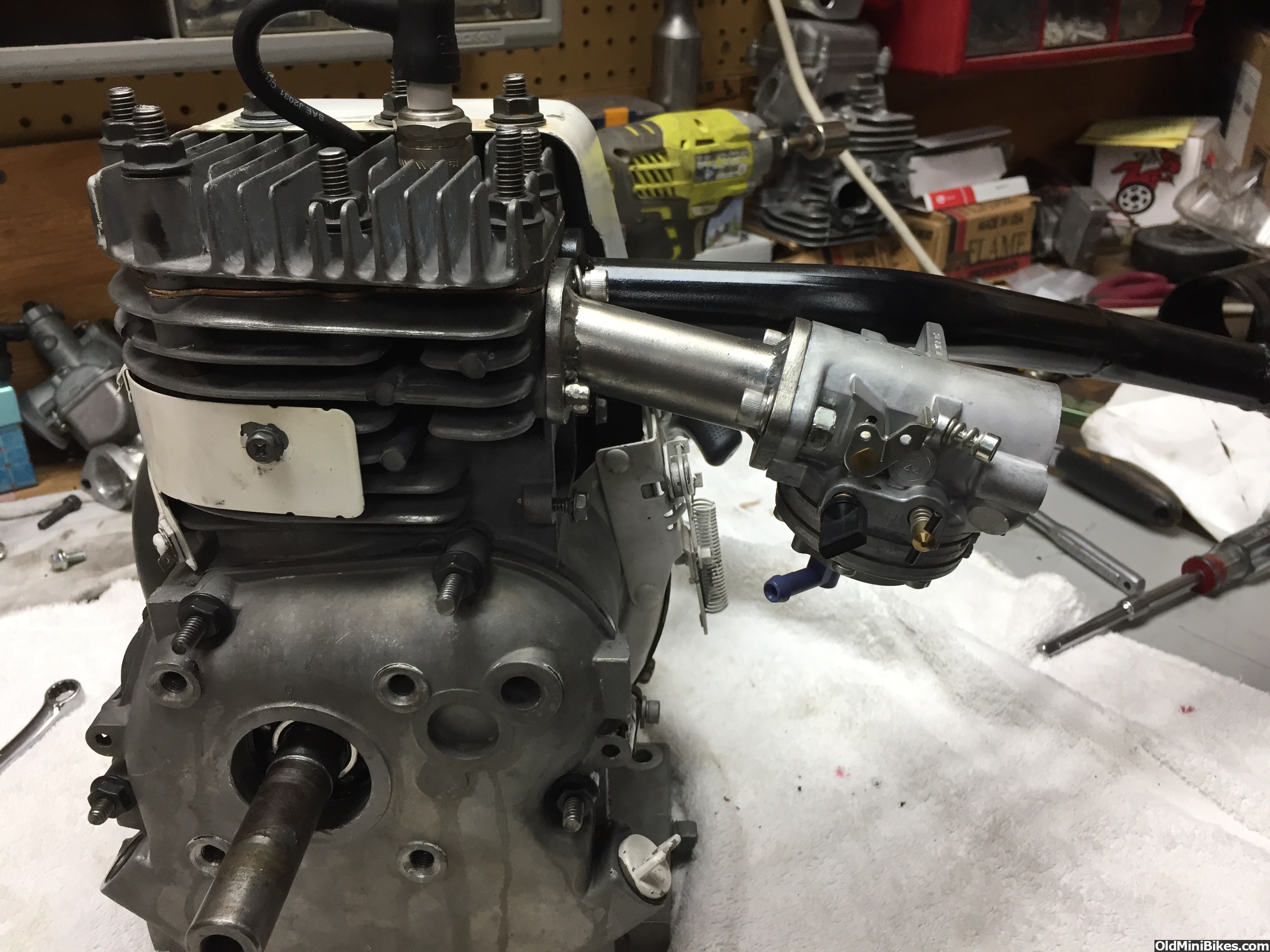

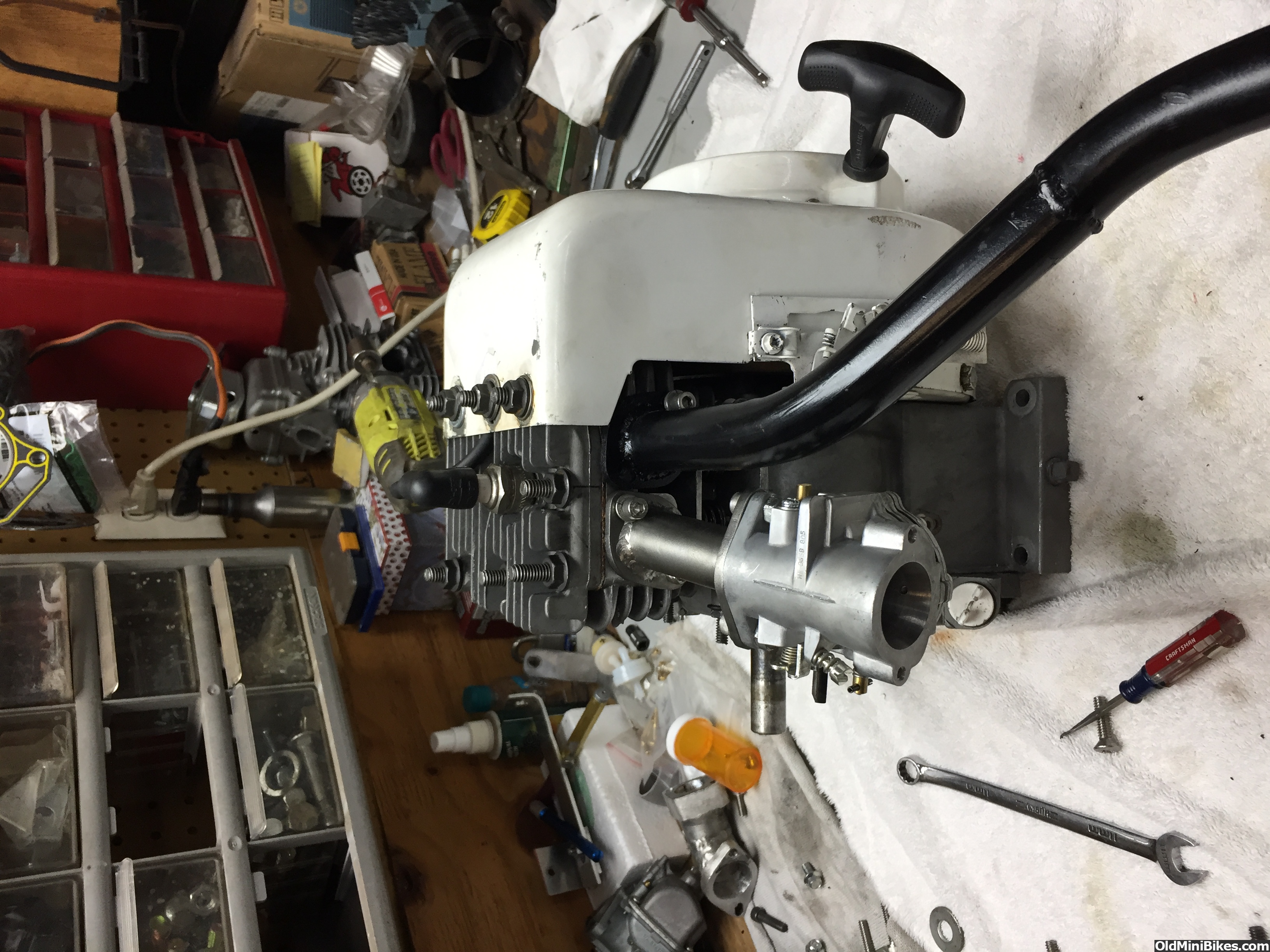

We have a new carb this time around , a Tec Motorsports H50 tilly . I got it from my good friend Karl . Should get her running tomorrow.
