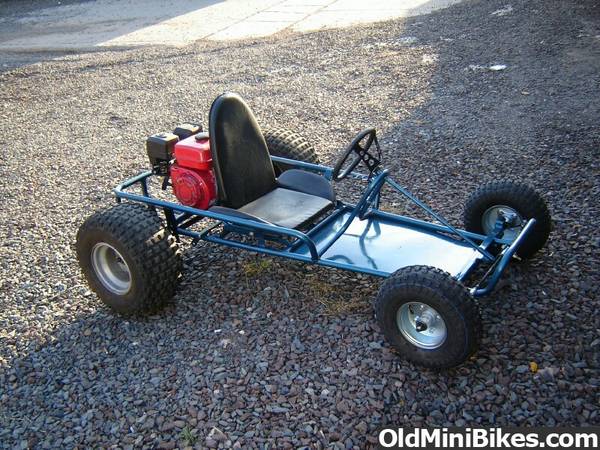

When we painted Viki's go-kart, someone had suggested using a arcylic urethane paint - (Westhane) and I think it turned out pretty well. It was a two-part deal, and I think the quart of it was $40 and maybe another $40 for the activator (which is good for up to a gallon so I still have some left.
You do need to spray it really wet again to get a nice finish, and there is no clear cloat needed. It has a pretty tought finish to it so it doesn't chip as easily.
