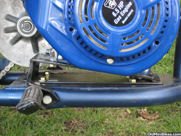

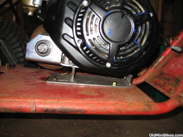

I live in Ontario. Not much detective work since its about the only common bike these days.
Building a drag bike is a little out of my league but from my own experiece beuilding modified offroad bikes these clones are fairly tollerent of tipping as long as they have enough oil to catch the dipper leaning forward. Back wards is a different matter. Too much oil gets sucked into the head up hills if your not leanng forwarda little and that can cause some trouble.
I am aware of many people running a 15 deg mount that and keep the oil around 15 - 16 ounces.
