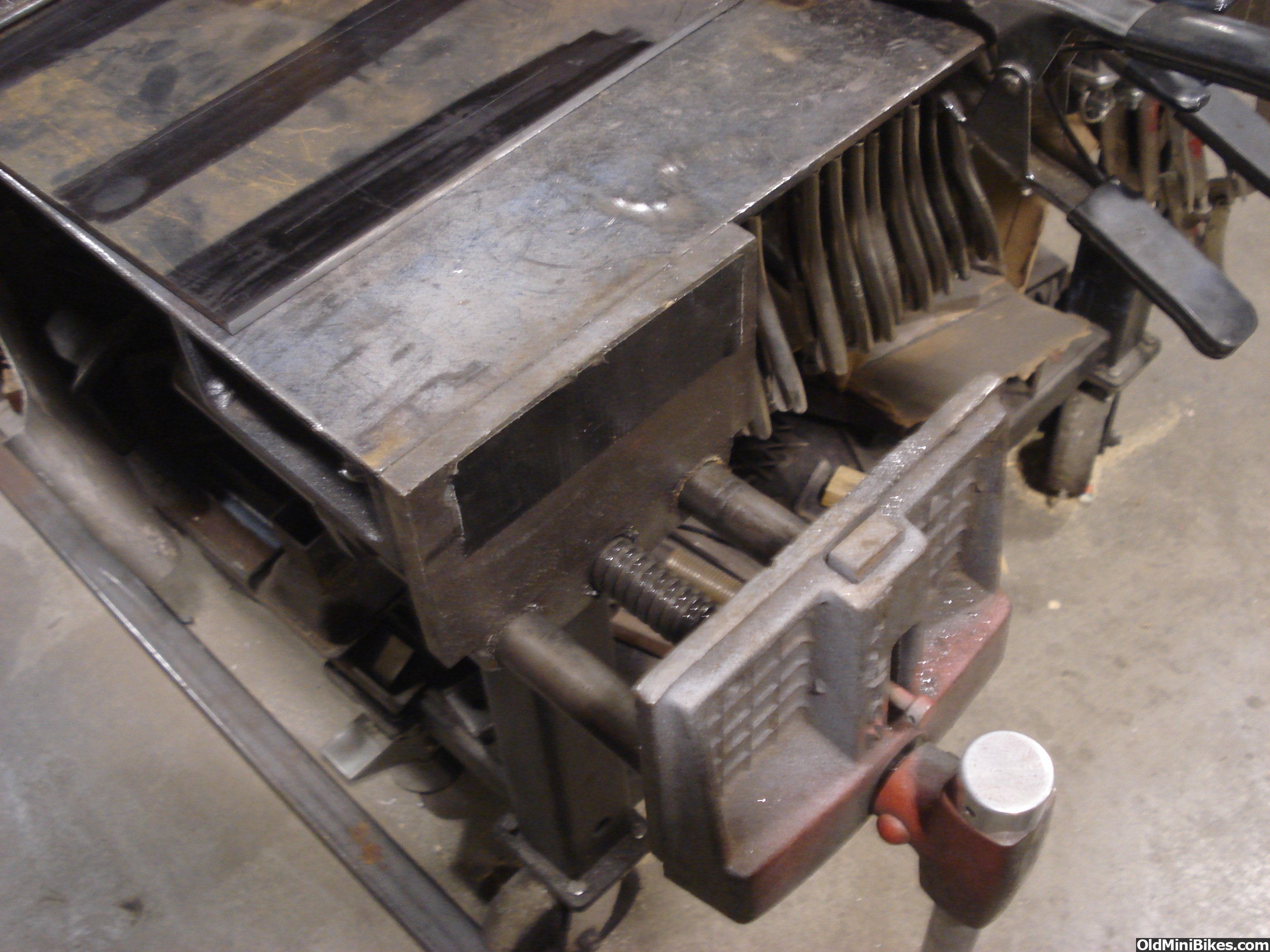

Here is what I use. A woodworking vice that is on my welding table. If the tire slips a little you just raise the tab and catch it right up against the rim and keep squeezing. The wider deeper jaws work better than a conventional mechanics vise at compressing the tire. Hasn't failed me yet but I am sure that there will come a time....
I do like the board cut to fit the rim. You could make that work in so many different ways. 2 boards and a threaded rod would pull them together and break the bead.
