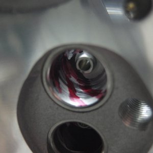

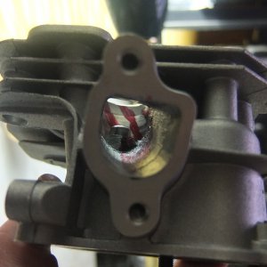

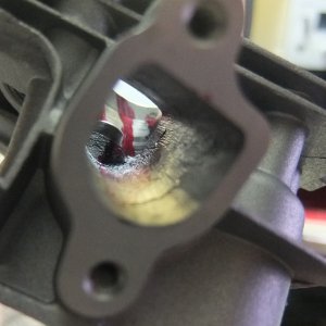

Tthese pictures are pre mod were i have plotted the areas im going to rework with black and red felt pen.
In this picture the port wall that needs to be opened up is shown, the veins in the bowl wall are shown aswell.
The Gx and clone head has a very poor port design so any porting is an improvement, distribution to the centre of the cylinder is poor so a swirl port design can nicely overcome this...

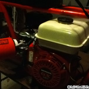

i was always trying to find a way to clean up a old motor good an could never get all the dirt an stains off the block so i cleaned the motor best i could an got some heat proof paint an it turned out great

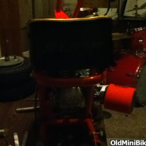

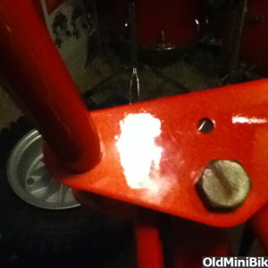

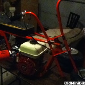

restored the frame dont know the make or age it was very old a beat up,,
named it alley boy or metro dont know what to go with
race toggle for kill switch an blue light toggle for lights
