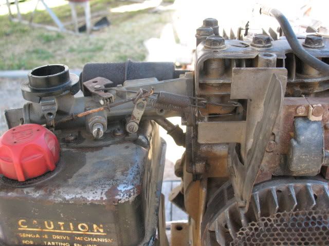

I picked up a 3hp Briggs, and the last owner jacked up the throttle hook-up. It will not return to idle, and I don't know how it's supposed to go. Can anyone post up a pic of where to run the return spring? I tried to search, but didnt find anything. Thanks

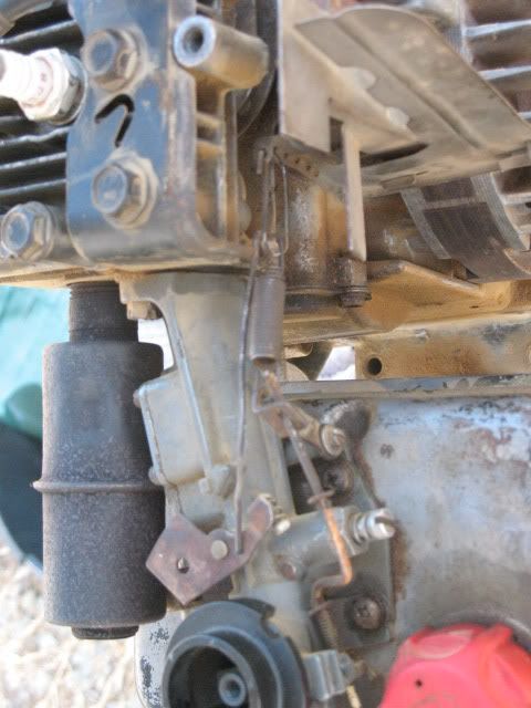

I'll go snap one. I forgot to note that the air governor is still part of the equation for now. Engine is going on a little kid bike, so I prefer to keep it for now. Back in a few with pic
I took off the throttle cable to run the engine and see if I can get it working. The cable was frayed and sticking, and I wanted to eliminate that as a problem area.
FWIW, the engine runs, but will not pull down to idle. I removed the heavier spring in the pic and tried it with just the light spring. I have another engine that only has the light one, so figured it would idle down without the bigger one. I did discover that the light spring wasn't seated correctly, but haven't tried to run it since correcting the.
Can I just disconnect the linkage running from choke to throttle arm? Part of the problem is that it seems to be binding up.
The choke rod was bent-I straightened it out and now it doesn't seem to hang up anymore. I may try to leave it.
Right now neither one of the springs will close the throttle-are you talking about the heavier or lighter spring? I think the heavy spring is in the wrong place. I have another 2hp motor that doesn't have it. From what I can dope out, for either spring to close the throttle one of them has got to pull in the opposite direction of the way they run now.
Yeah, I need it to keep a newbie-kid rider's speed in check. I think if I run a spring from the throttle arm to something solid (shroud maybe?) behind it I can get that to work.
I still need to make the governor return to idle. It wouldn't when I ran the engine earlier, but the light spring is mangled a little and wasn't seated on the governor blade -I think it was still under tension and pulling at idle. Will have to put cover back on and try again.
Got engine idling now, I pulled the heavy spring off and fiddled with the lighter spring. The heavy one didn't seem to do anything as far as I could tell. Now I just need a return spring to pull the throttle arm back to idle. Any suggestions on how that should be run? I'm suspecting that the PO that futzed with the springs in the first place was trying to get it working and put the heavy spring (top spring in pic) on in an attempt to get it to close the throttle.
