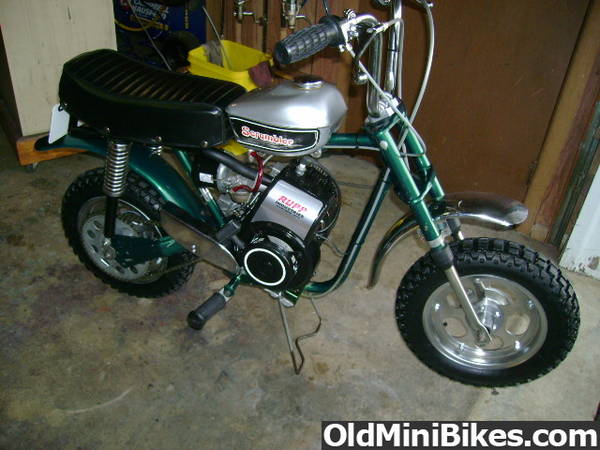

Here's the HS50 I just did for my Scrambler. This is a '79 engine. This one has a bearing PTO. I put a HS40 aluminum flywheel on it so I could use the older blower housing. I got a repop intake from bobco, to look at it you would never know it's a 5 horse.
you know a guy could be sneaky and show up at windber and hit the hills all day with that.....:scooter:.........:thumbsup:
It's pretty impressive:thumbsup: The power difference between a H35 and a HS50 is really unbelievable. This was a good indicator of that, with everything else being the same and just changing engines.:scooter:
