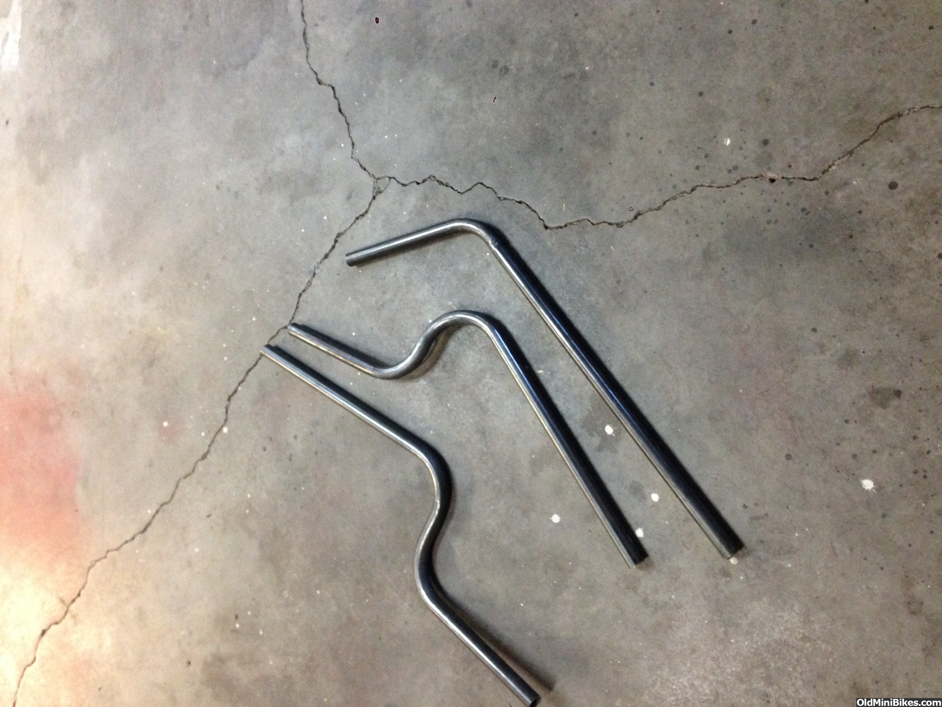

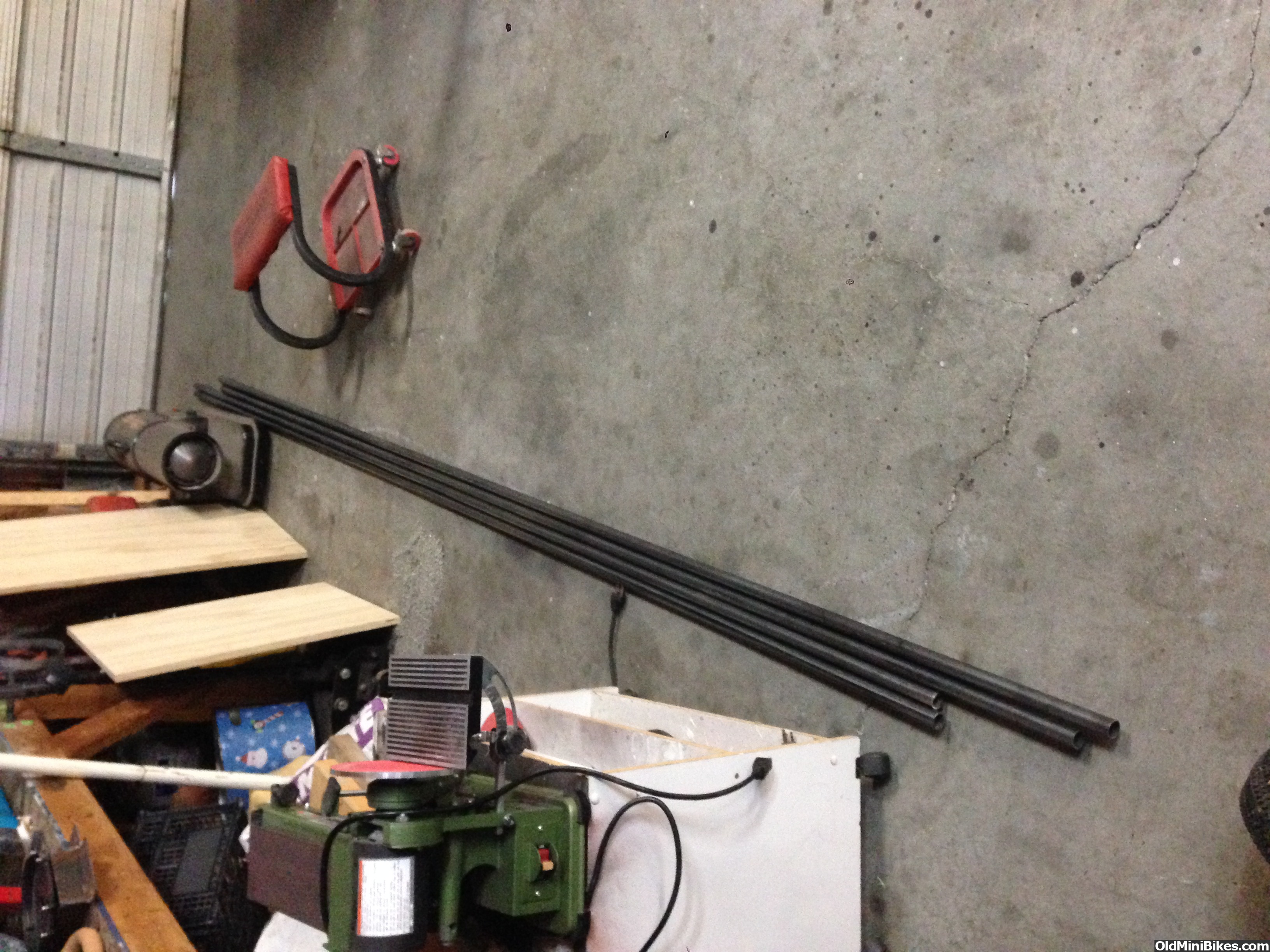

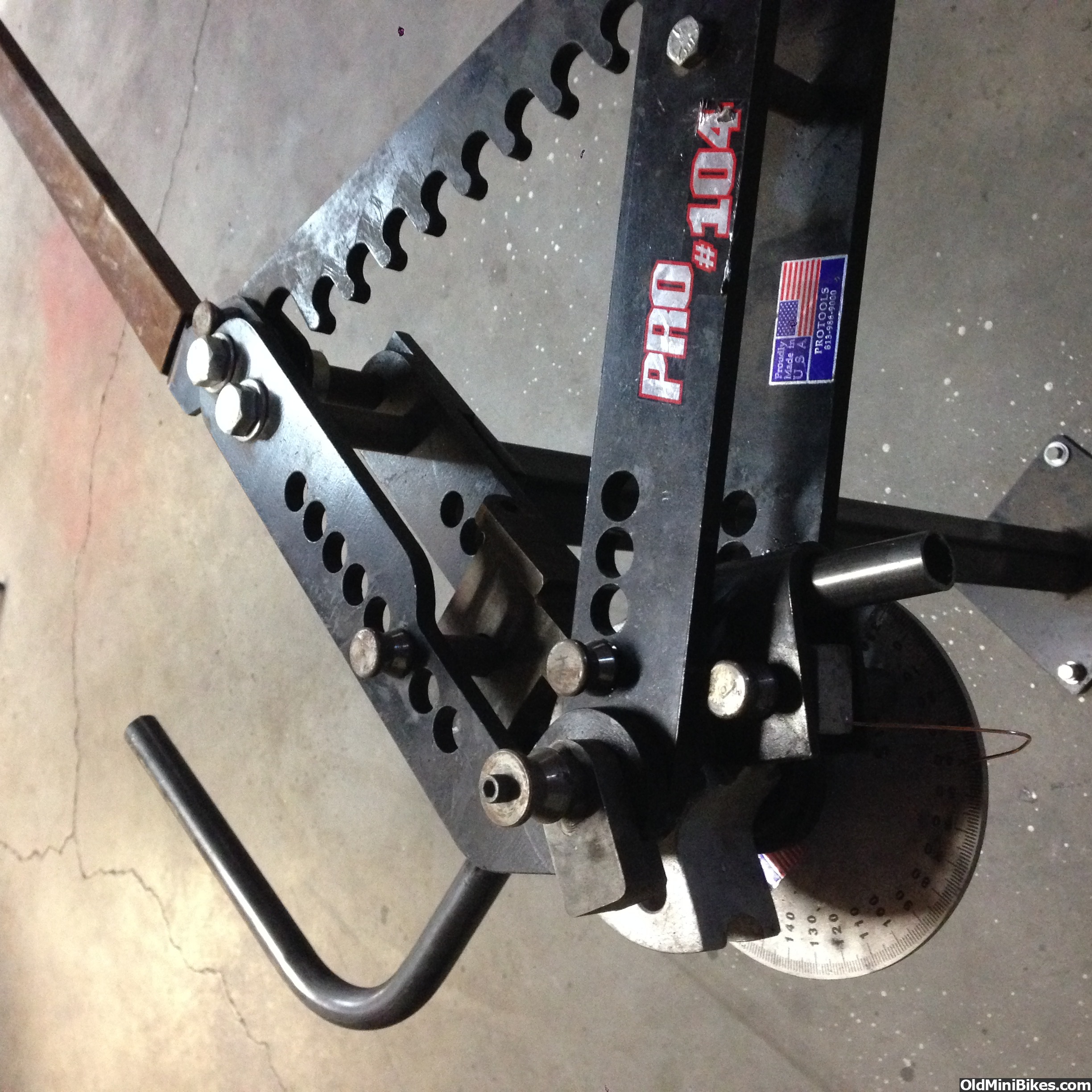

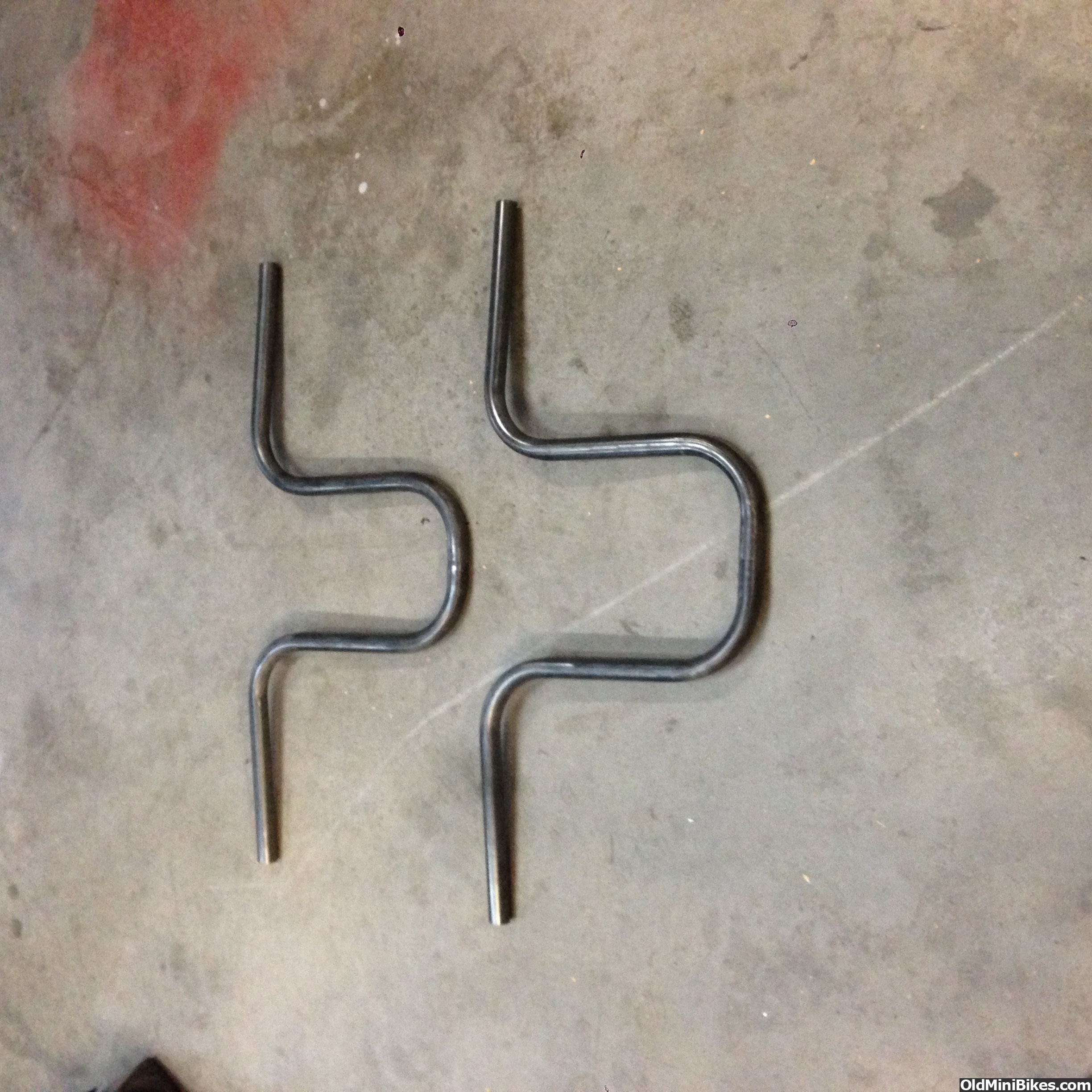

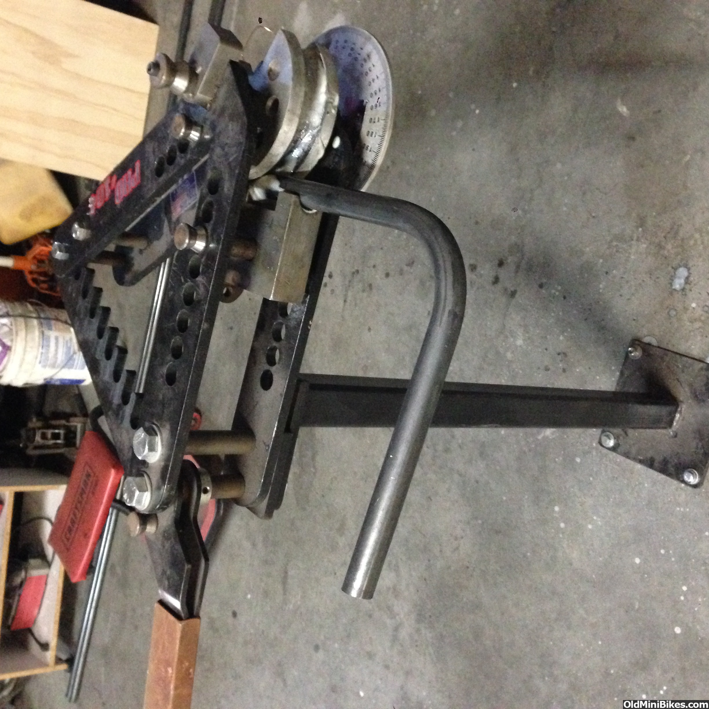

Today I went and bought some tubing , two 24' sticks of 1" 0.83 wall and decided to try to build handle bars for my bike . I've had a pro tools model 104 bender for awhile now , but never bent much .

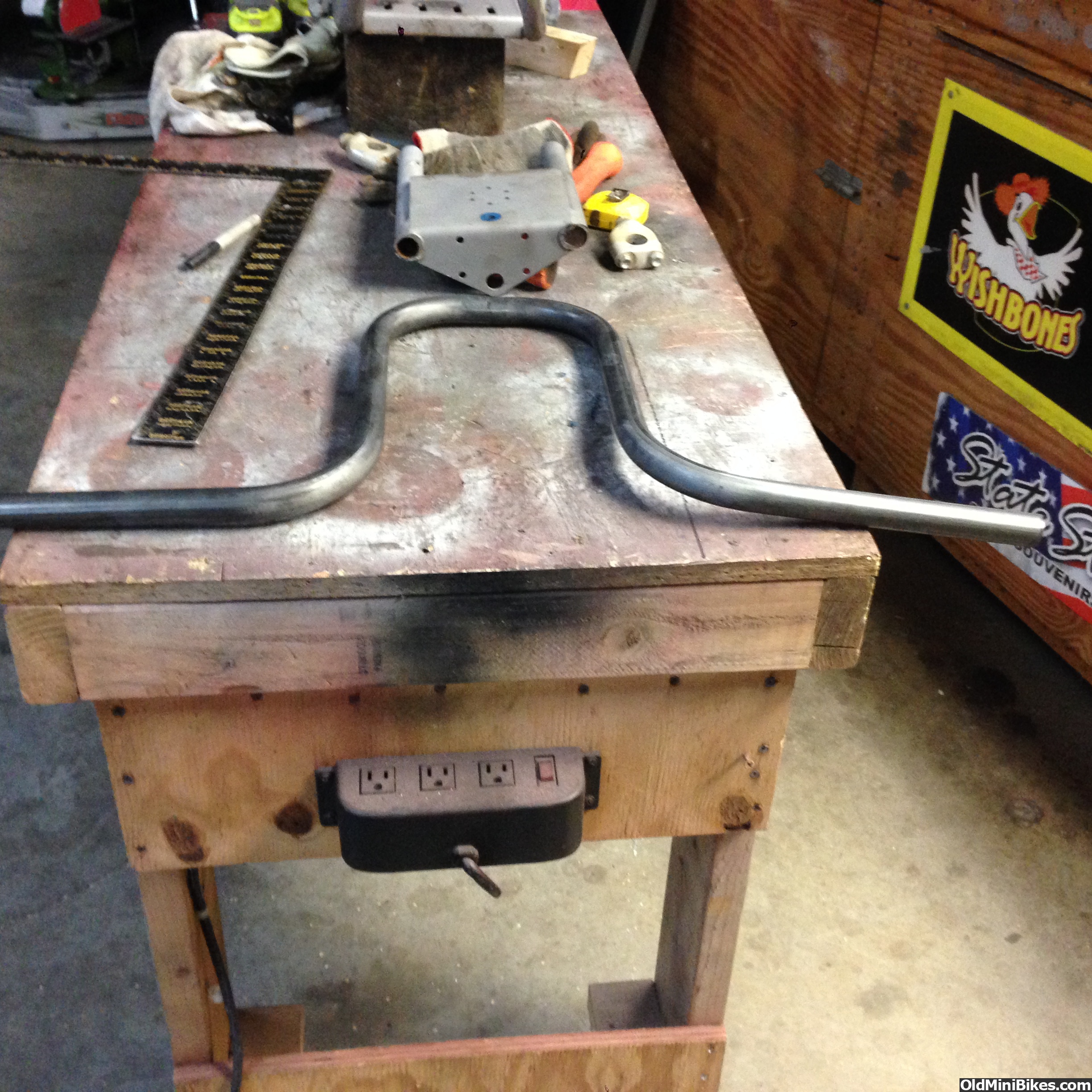

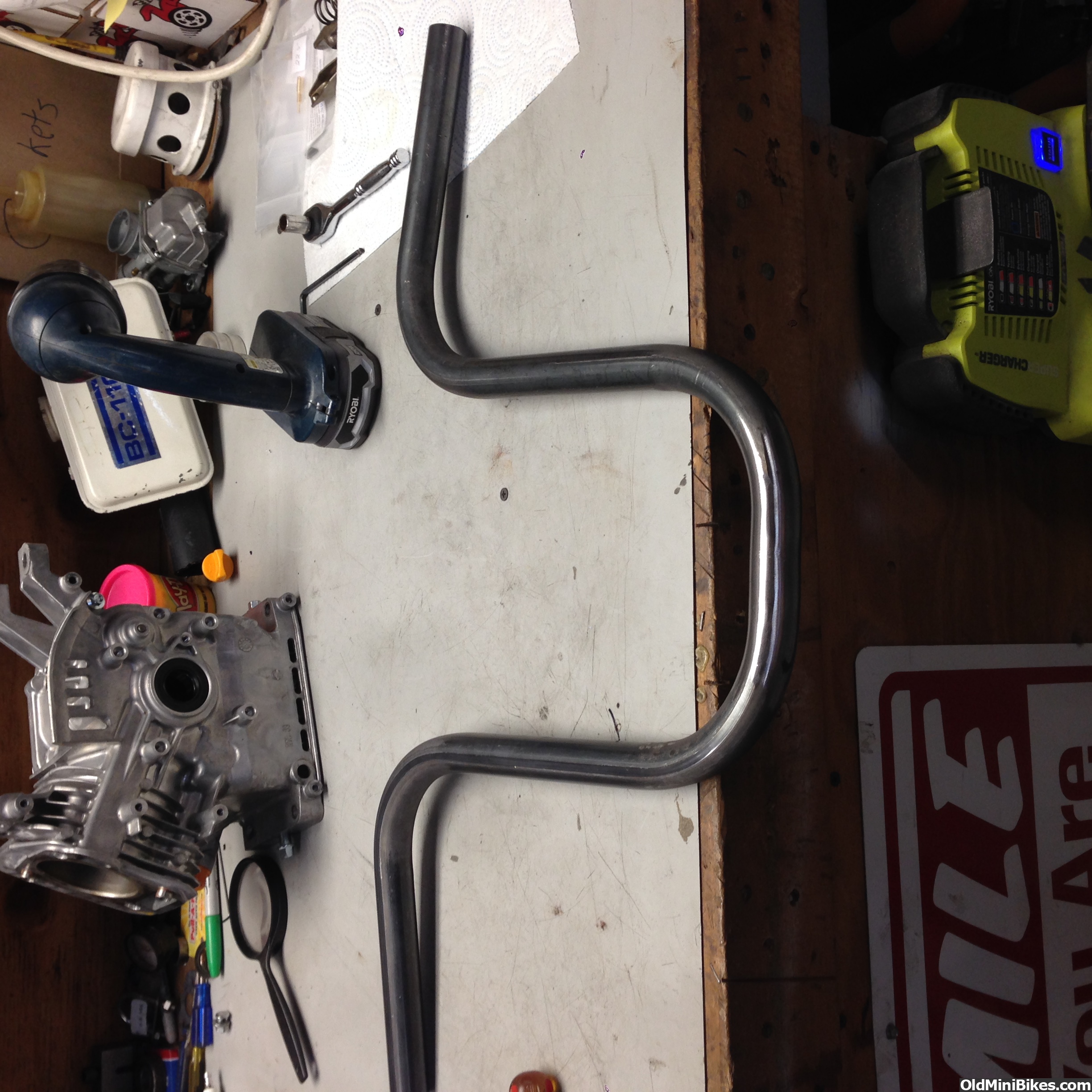

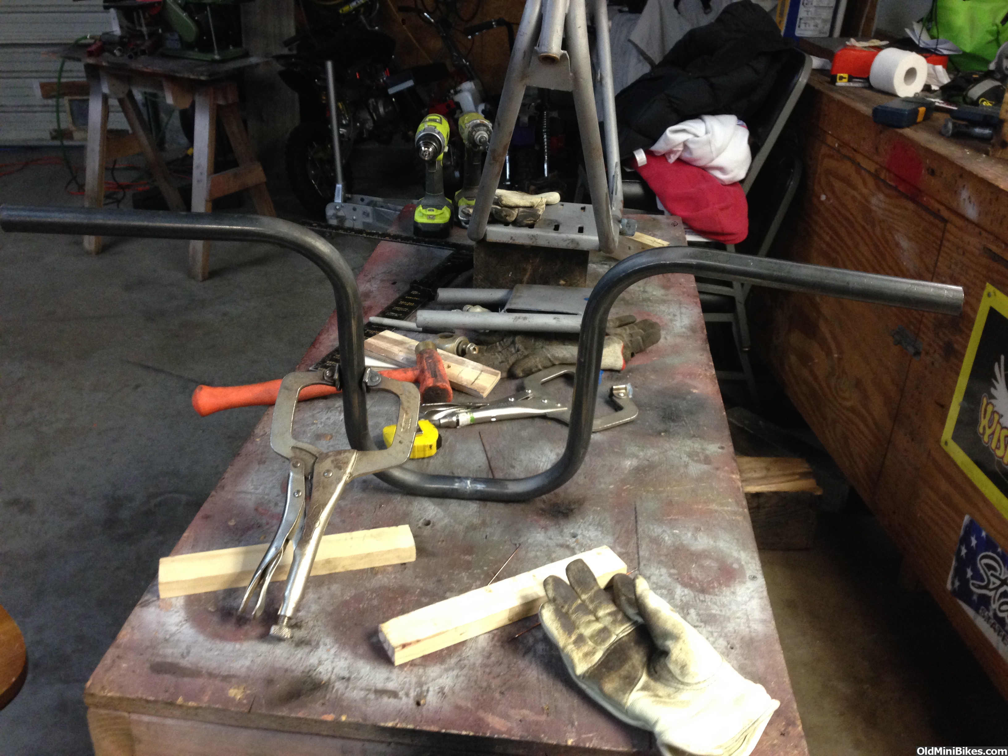

So after wasting 10' of tubing today I have figured out how to use my bender . I end up making two handle bars because I made two halfs the same . The upper section has 10 degrees of swept back , so one side goes up in the bender and the other goes down . Both bars are about 15 inches tall and one is 9 inches wide the other is about 10 1/2 inches wide .
Not sure what bar I'am gonna use yet . Also made the overall width big for now so I can cut them down if needed .
