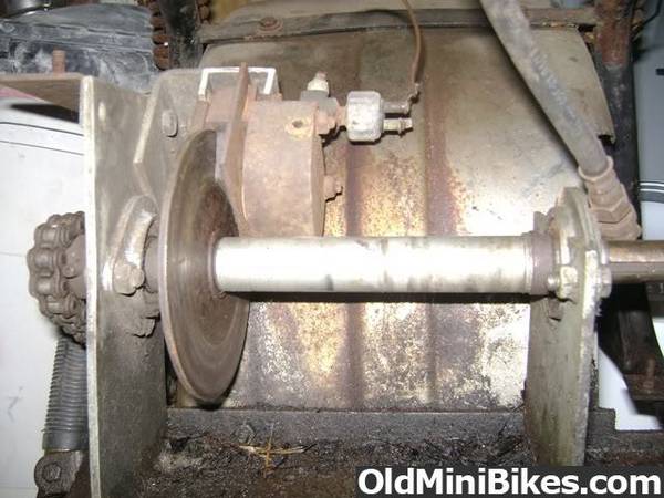

My VT-1012 came with a disc setup on the jackshaft (see below) and no brake on the front wheel. Some SB's came with a band brake and some came with an internal drum brake on the front. If you search the photos of this site for photos of Super Broncs you should turn up a lot of photos showing these various setups.
