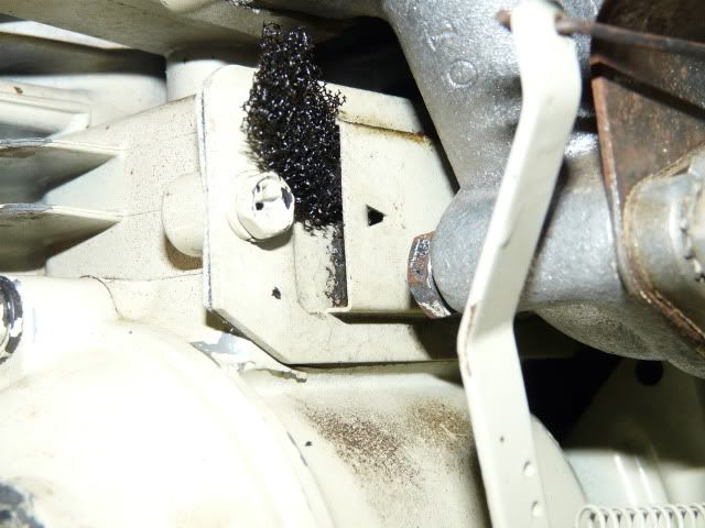

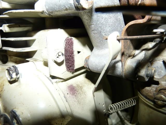

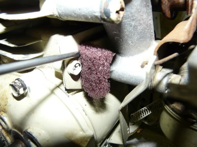

A simple fast way to replace the block breather foam, they always seem to be missing or just deteriorated away. I like to use Scotchbrite it seems to always be around my shop it wont deteriorate from the oil and the lock tab seems to get a better hold of it.

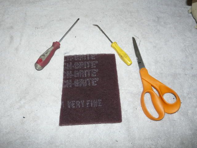

You need a couple things some Scotchbrite, If you do not have any look in the kitchen... scissors, pocket screwdriver and a pic tool.

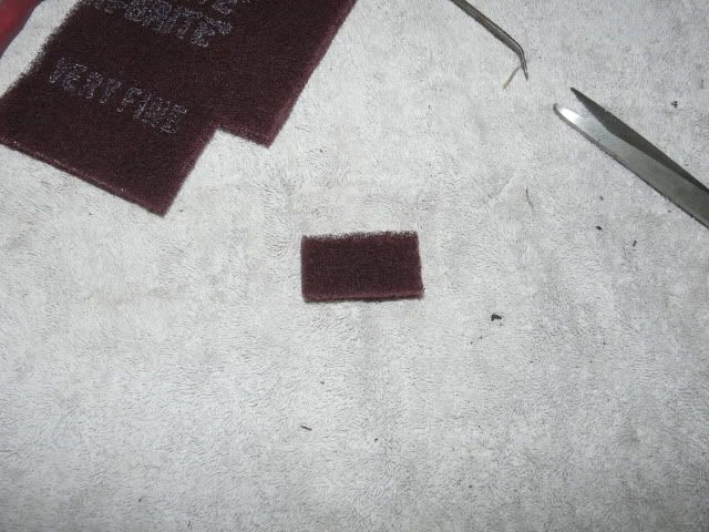

Cut the Scotchbrite about a 1/4 smaller than the raised portion of the breather.
Use the pic tool to get what is left of the foam out.
