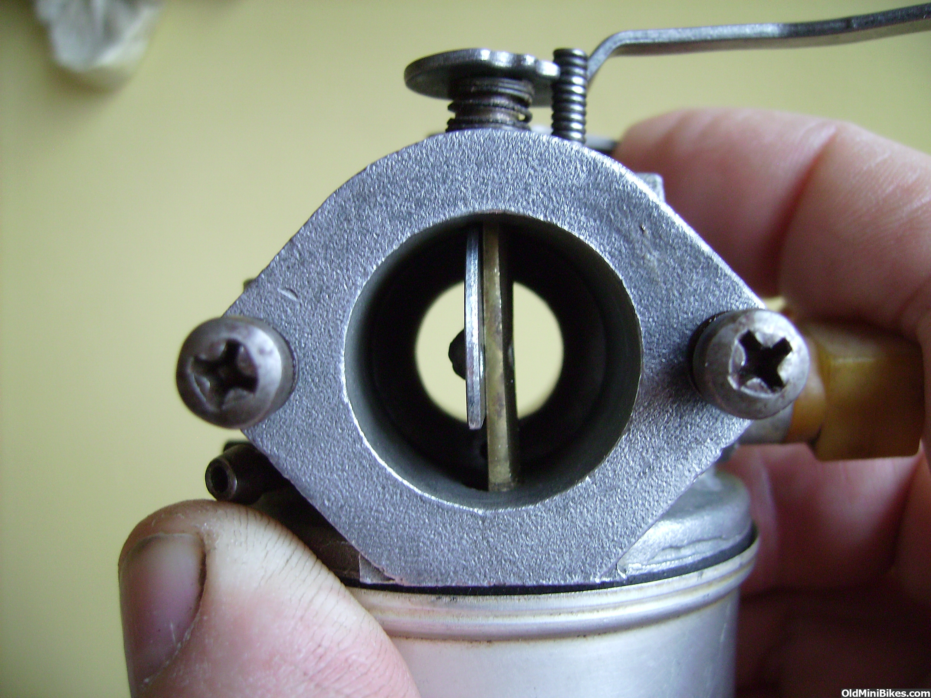

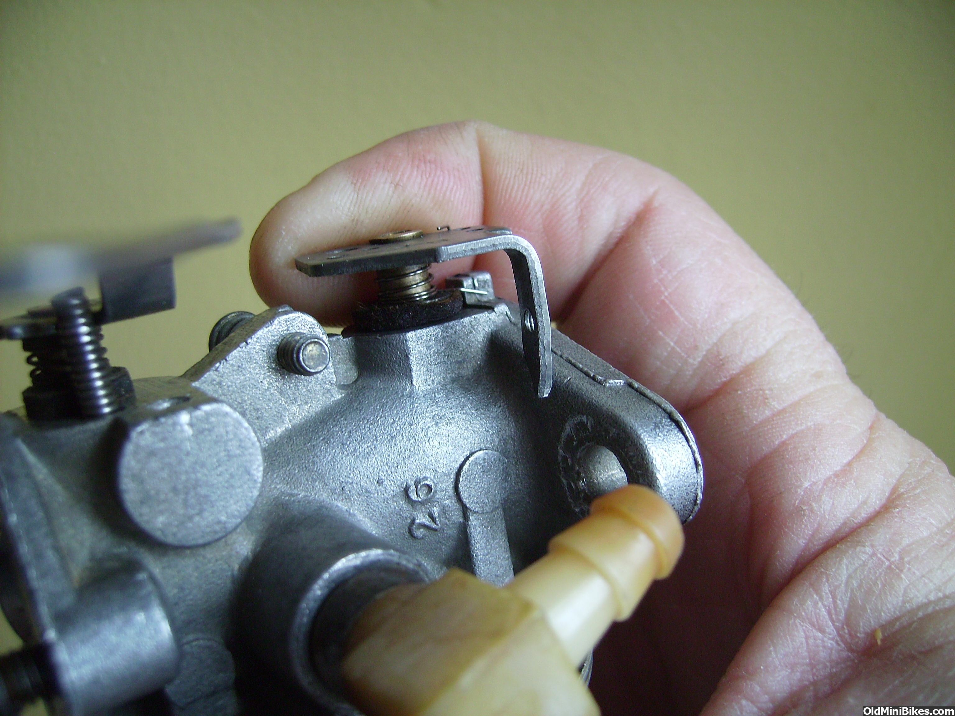

I bet everybody does this, bend and file that little tange on the throttle to make the HS carb open all the way.

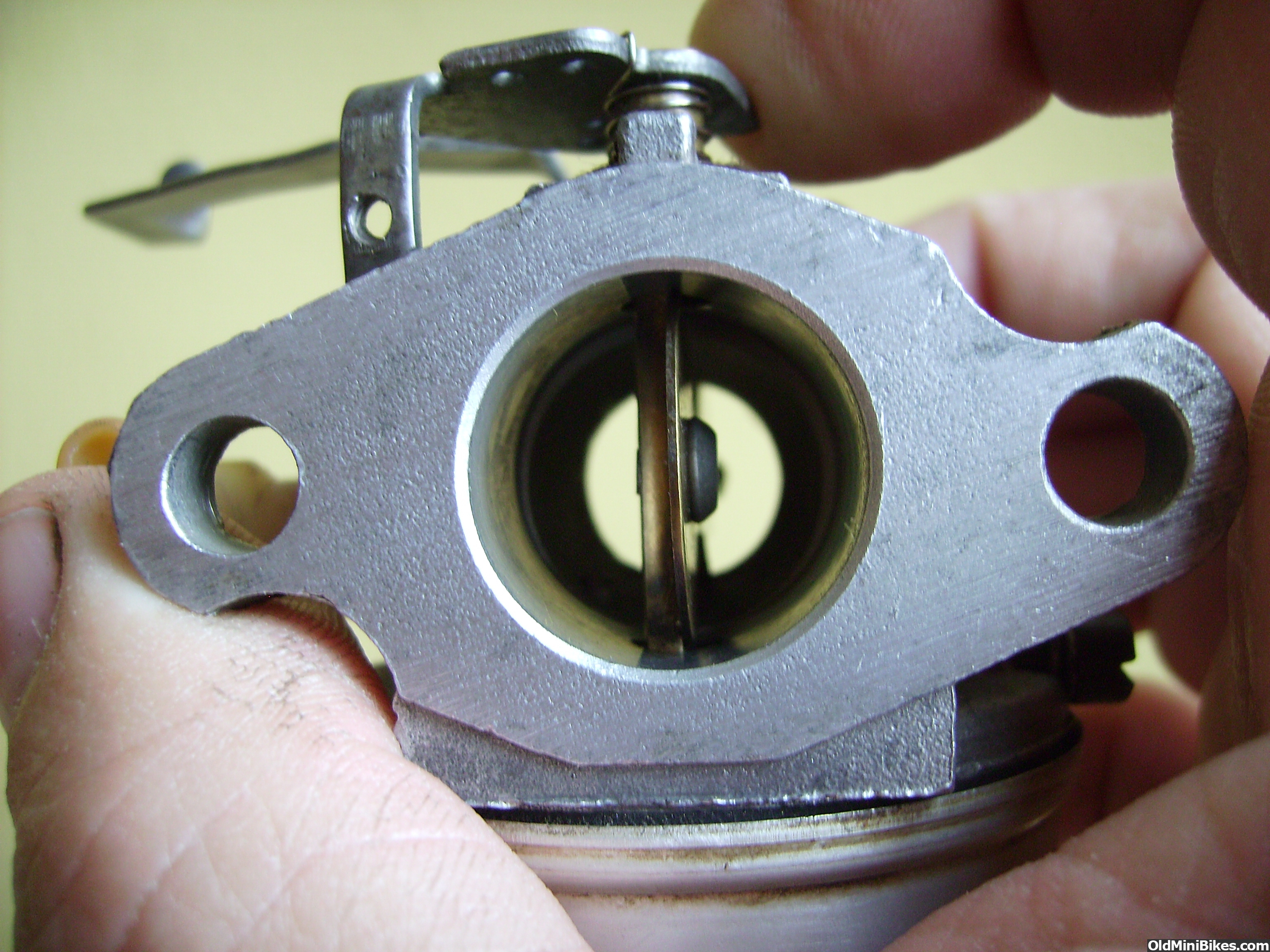

I take out the throttle and choke levers and file them thinner so the carb can flow more air.

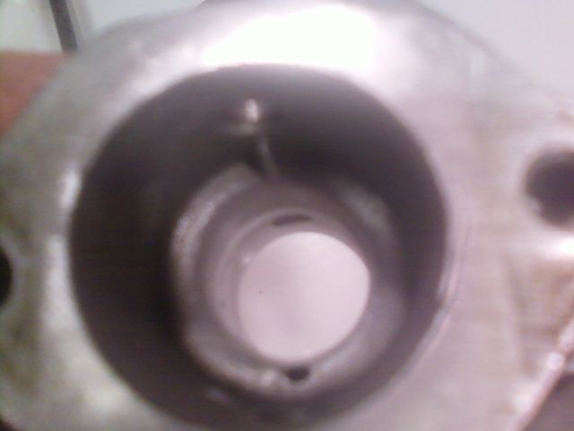

You can't see it in the pics but @ the venturi location I take a small round file and smooth this area up.(it usually has parting lines that slow up incoming air through the carb.
