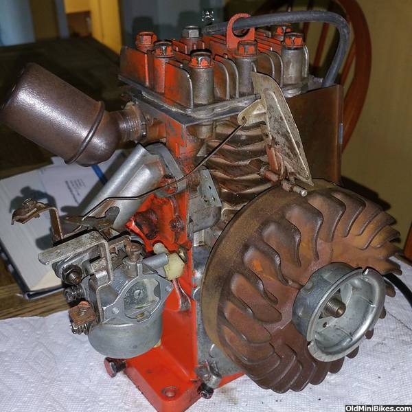

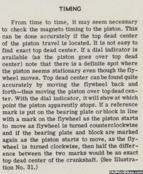

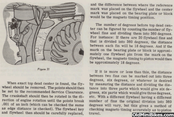

So I had no spark on this Clinton model 404. I changed the points, condenser and coil. Before I close it all up and give her a tug, i thought hey I didnt time this sucka. I had to remove the magneto to get the new coil on as it would not slide on so close to the fins. But it doesnt turn the way a Tecumseh stator plate would left and right until you get the tone generator to go off when the points open. The magneto simply bolts down on nonadjustable mounts. Does this mean the timing is fixed? I somehow doubt this.
