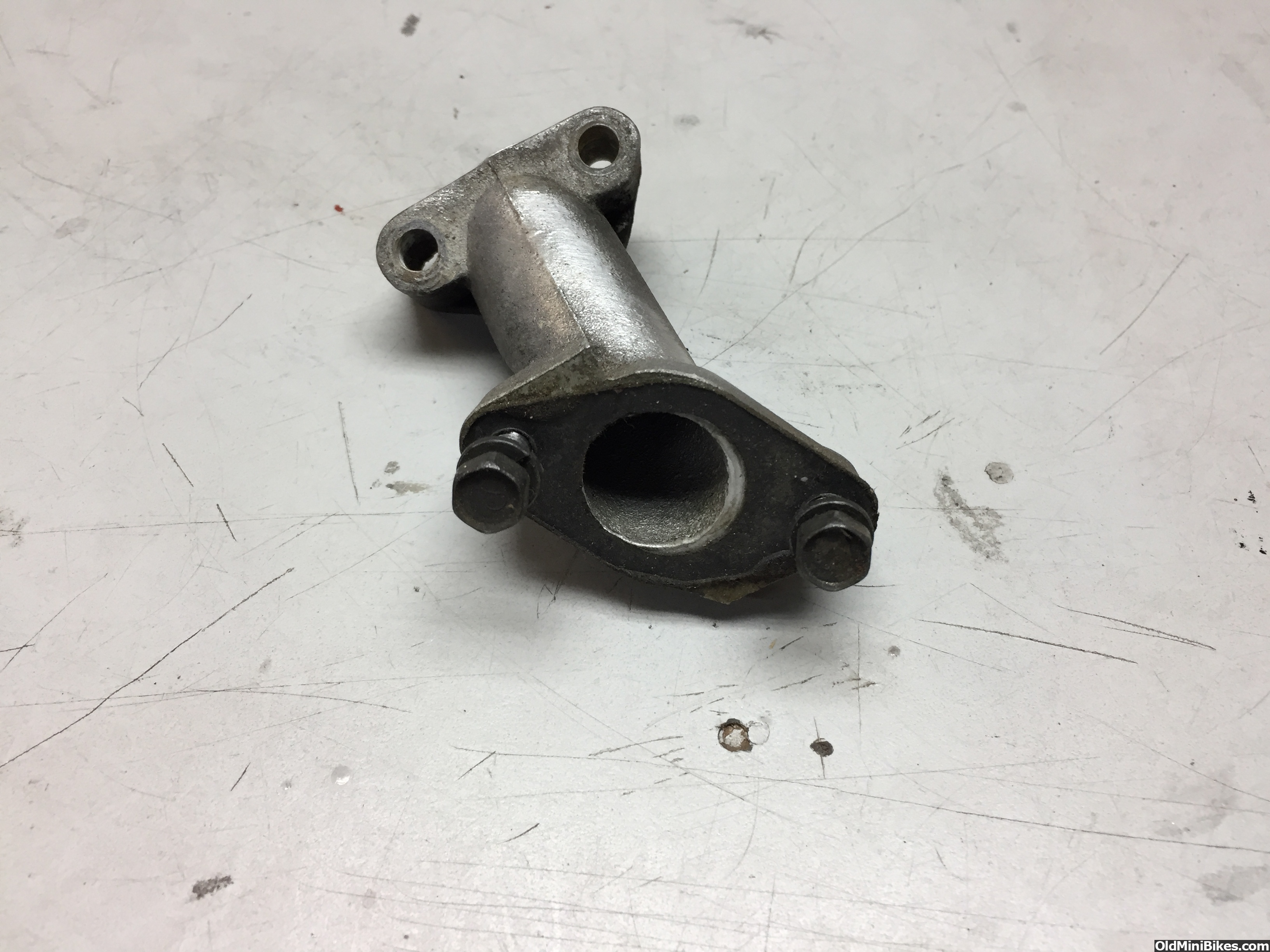

Heck I don't know . It came off an HS 40 rupp motor I still have , the one with the long crank shaft . When I get home next week I will see if their are any numbers on it .

The repops are spot on to the original hs40. The only difference is the outer casting is rougher than the original hs40 slanted intake.
David's price is great for an original part. Someone needs to grab that
