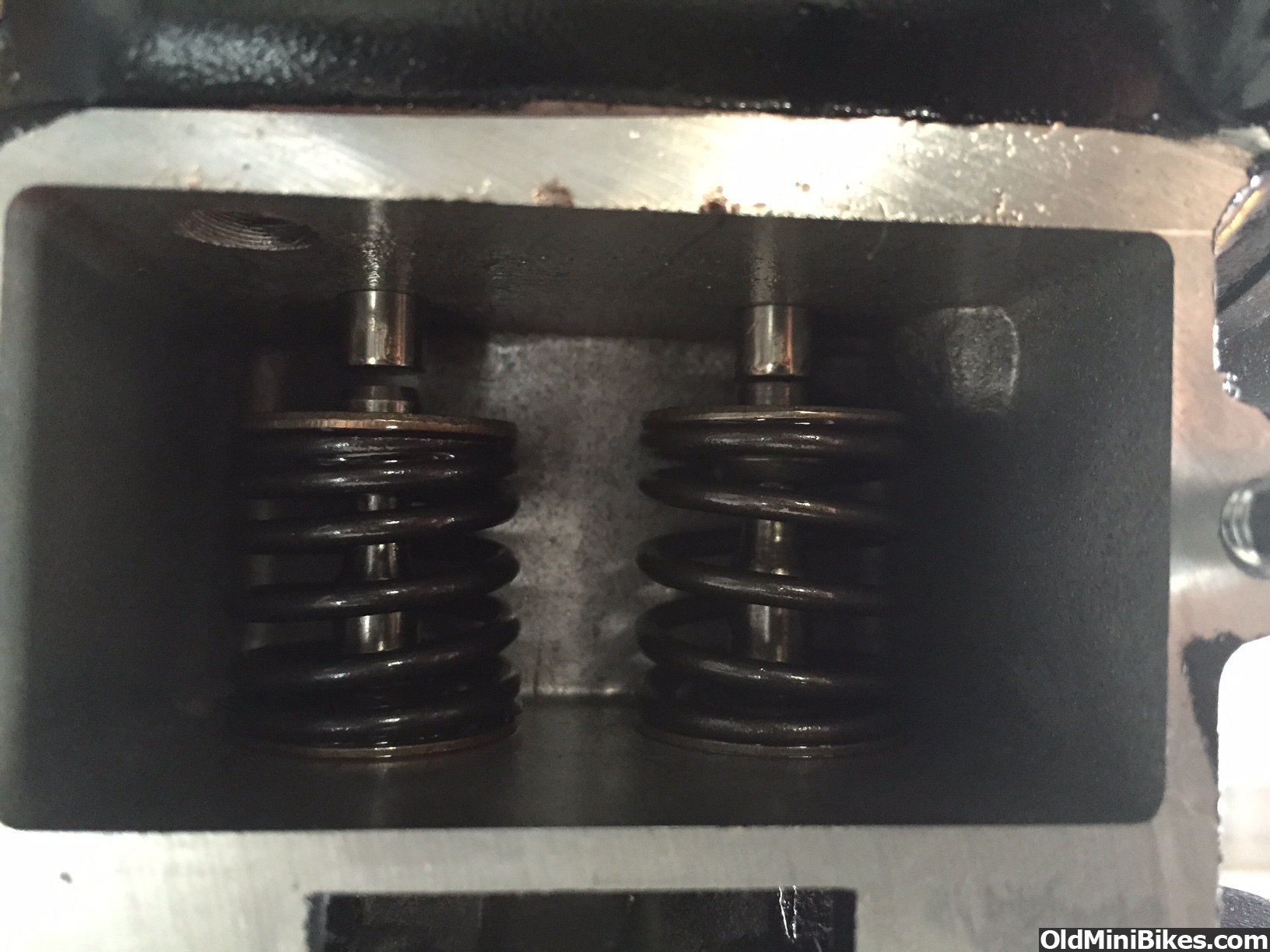

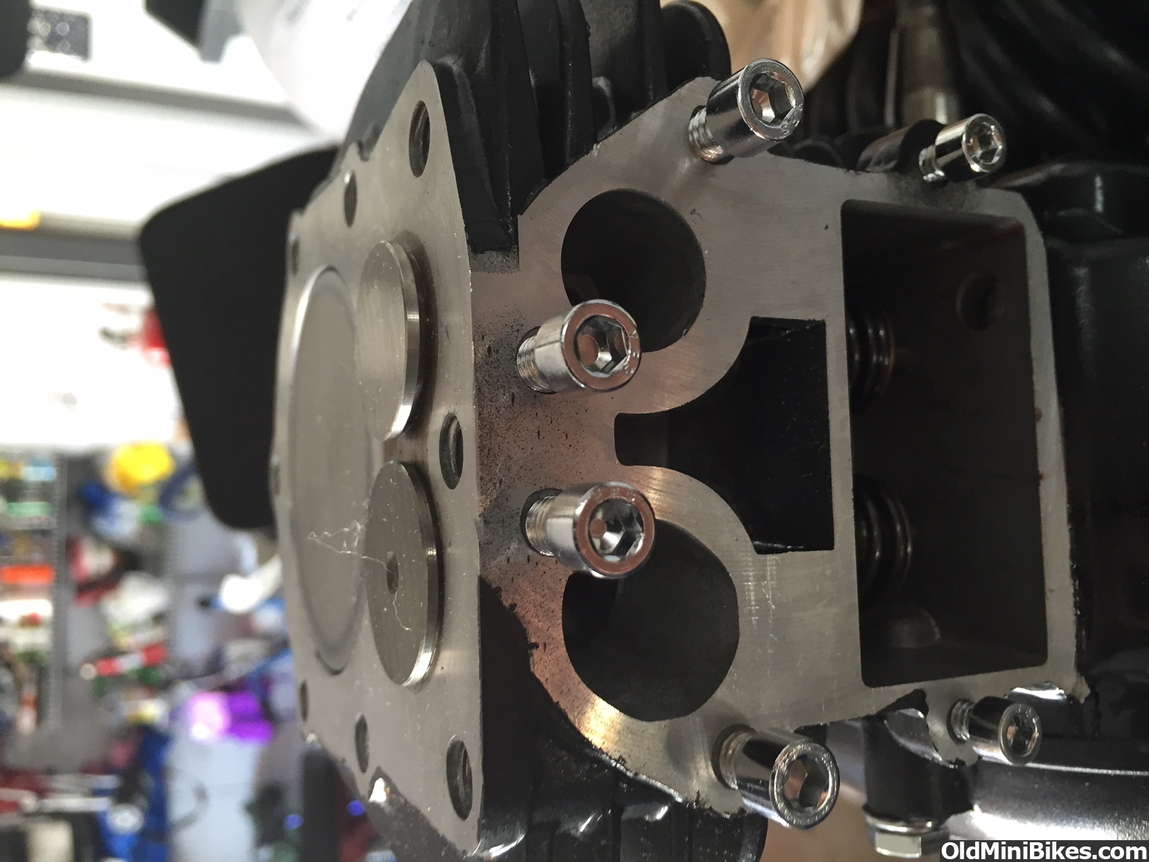

Doing my first complete engine build on a HS40. Do these valves look right. The valves are new,engine block is new but the lifters are not and neither is the cam. The space seems to large. I will get a larger feeler gauge set tonight but wanted some opinions. Thanks-Mike
Almost looks like the exhaust valve is sitting above the seat, or the seat's not ground. If these are the correct valves, someone is going to have to cut the seats. Those lifters/cam don't wear "that" much. Almost looks like the wrong valves.
