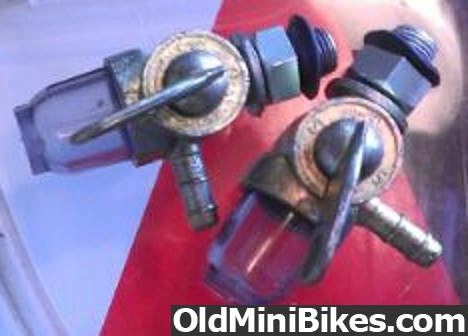

Anyone know how to fix these gold fuel petcocks? I have 2 unused NOS valves from different suppliers. Both leak like crazy through the fuel path, resulting in a big mess the next day.
These valves have a small set screw on the side that lets you remove the one-piece lever and shaft from the front of the valve body. There's an O-ring inside on the shaft that keeps fuel from coming out the front. That works great. The problem seems to be that there is no replaceable seal inside to seal the cross hole in the shaft. Fuel just flows around the shaft and right through to the outlet. Each shaft is covered with a thick transparent goo. Hard to tell if it used to be grease or if it was some sort of plastic sealing sleeve that broke down over the last 40 years. Each valve came from a different reseller, each one was unused, and each one is bad. I would have expected to find a replacable seal between the shaft and either the inlet or outlet.
Any suggestions for repairing these? These are the petcocks that belong on my '71 & '72 Arctic Cats but I can't have gas running through the valve even after shutting it off. Plus, I'm out $30 otherwise. :doah:
In the mean time, I had to go back to my old trusty 40 year-old and well-used Rupp-style petcock. Not correct for this bike and no sediment bowl, but at least it's functional.
