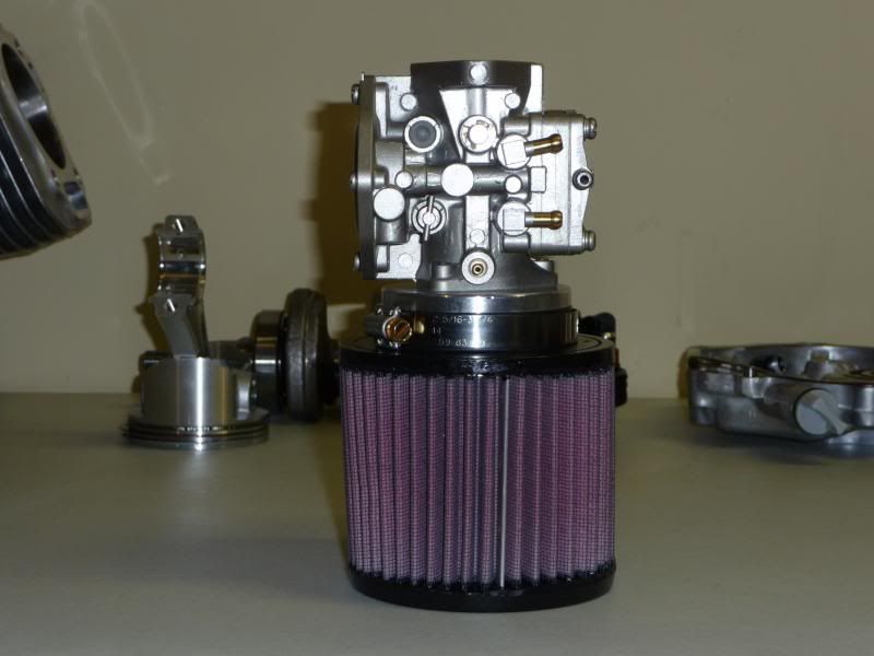

So work is progressing and Im looking at this thing
Looked at the manual online and mentions nothing of this
But looking at the picture below
The carb has a built in pump, and will get its pulse from the carb adapter
The small barb at the bottom is for a primer, and will be plugged/capped
One of the larger ones is the fuel IN
The other one is a fuel RETURN
Whats everybody do with that one?
Cap it? Return to the gas tank? Tie it back into the fuel in line? Run a line to the bottom of the bike?
Thanks in advance guys
