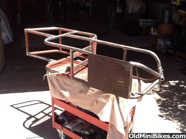

My frame was hacked by the seller, his son was going to put the HF Predator 420 cc engine this. I did get the 212cc to install for $99.00 on sale at HF. I will be cutting off the 1/4" plate that was welded in and re-bending some new tubes for the bottom of this frame.
Still a bit up in the air about the drive chain setup, I'm thinking about a TAV torque converter with a single jack shaft gear reduction. These originally had a 40:1 reduction with a top speed of 8 mph, I'm thinking I want it just a bit faster and can achieve a 25:1 reduction thru a single jack shaft setup. This will allow me to put a nice disk brake onto the jack shaft as well. I've heard these were a bear to stop when going downhill and the old brake system was a friction belt around a pulley, it's probably safer just to jump off before hitting a tree.
The monster rear tire is on a 15" wheel and tire diameter is 28"". Gonna remove tire so I can sandblast and powder coat the wheel, I'll determine the bias of the chevrons upon re-assy.
Cool project and a fun find, thanks to you all for helping with input and pics.
Pics of tear down and sandblasting.
#15
Hi George
I have studied your photos many times over the past two weeks, thanks for posting them. Its hard to find good photos on these. I'm cutting the frame up this wknd and re-welding in two bottom tubes to bring this back to original. I do have an issue with the fork tube being tweaked from the prev owner cutting the frame. Ill be able to pull this back int place before weeding in the new tubes.
My plans for a single gear reduction jack shaft will flip the tire around and put the final gear on the correct side of the frame. I'll also be able to install a disk brake into this setup.

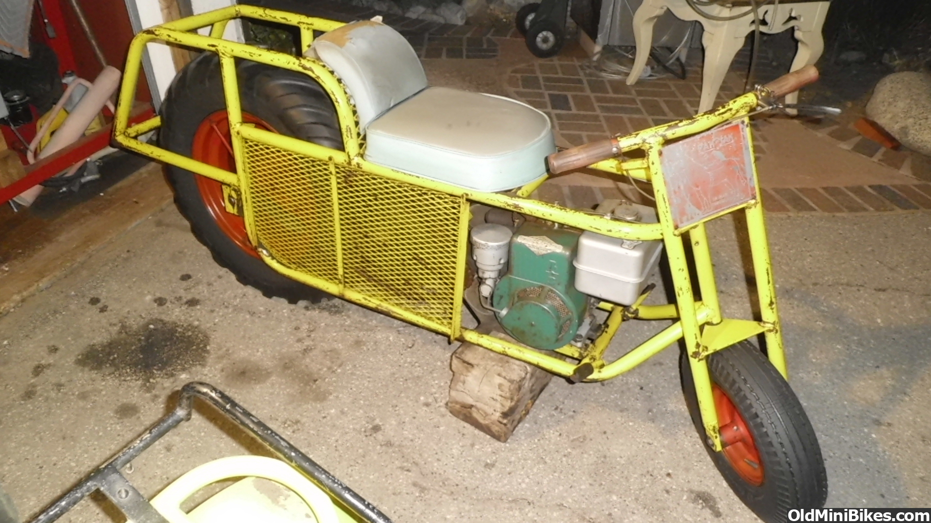

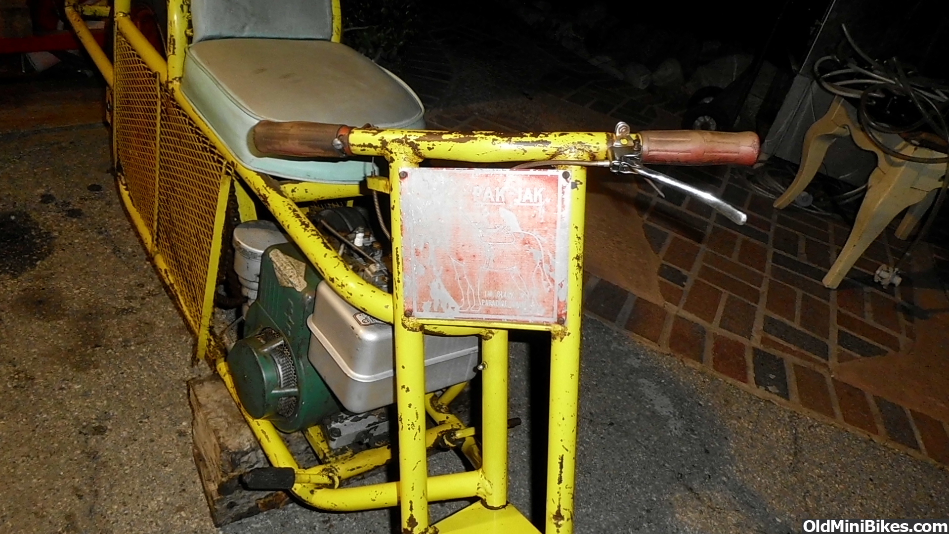

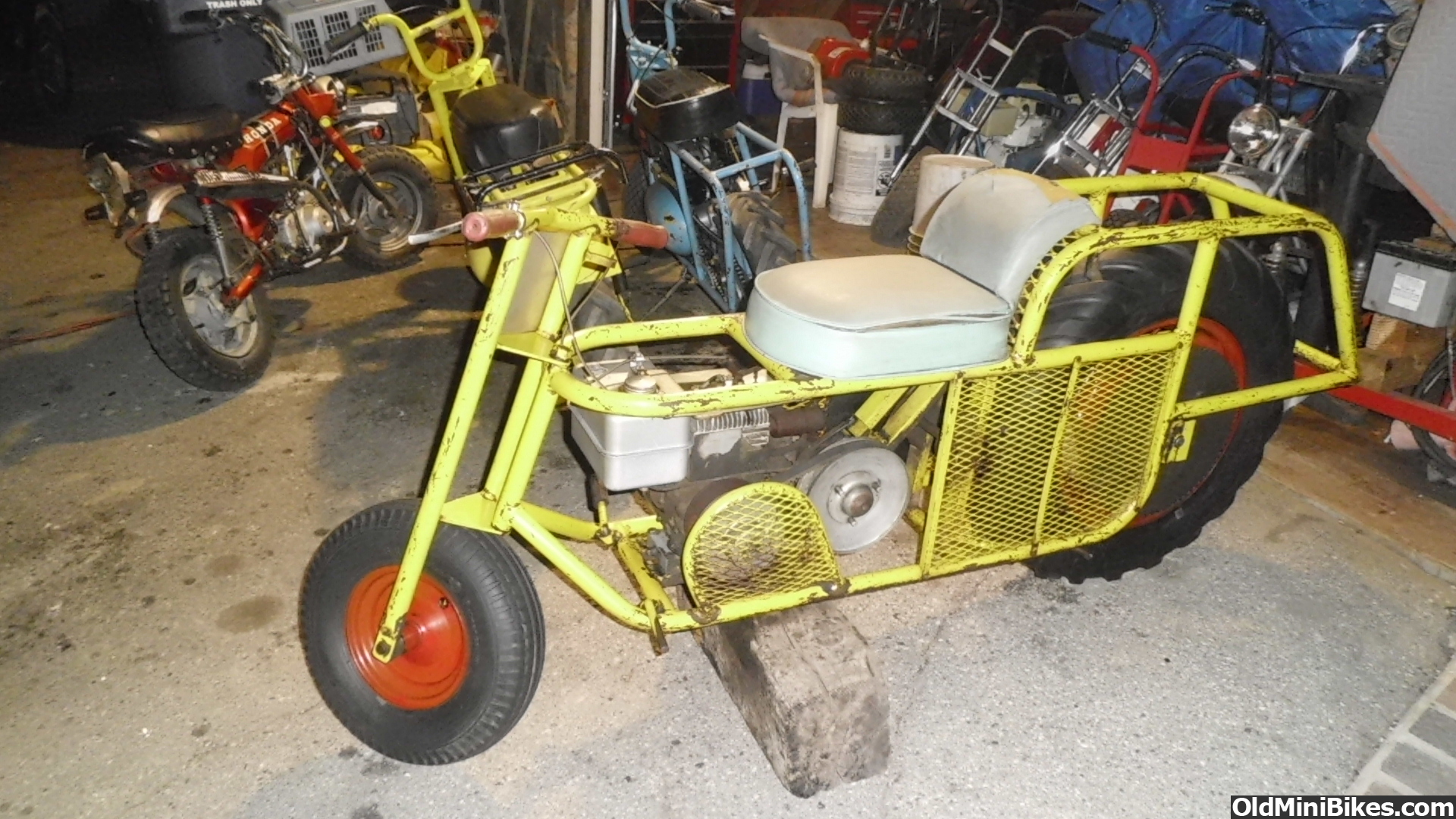

ive got one, they are pretty cool, good luck with your engine conversion, it should be pretty cool to see a high hp bike
here is another bike i owned, its called a burro. pretty cool bike
