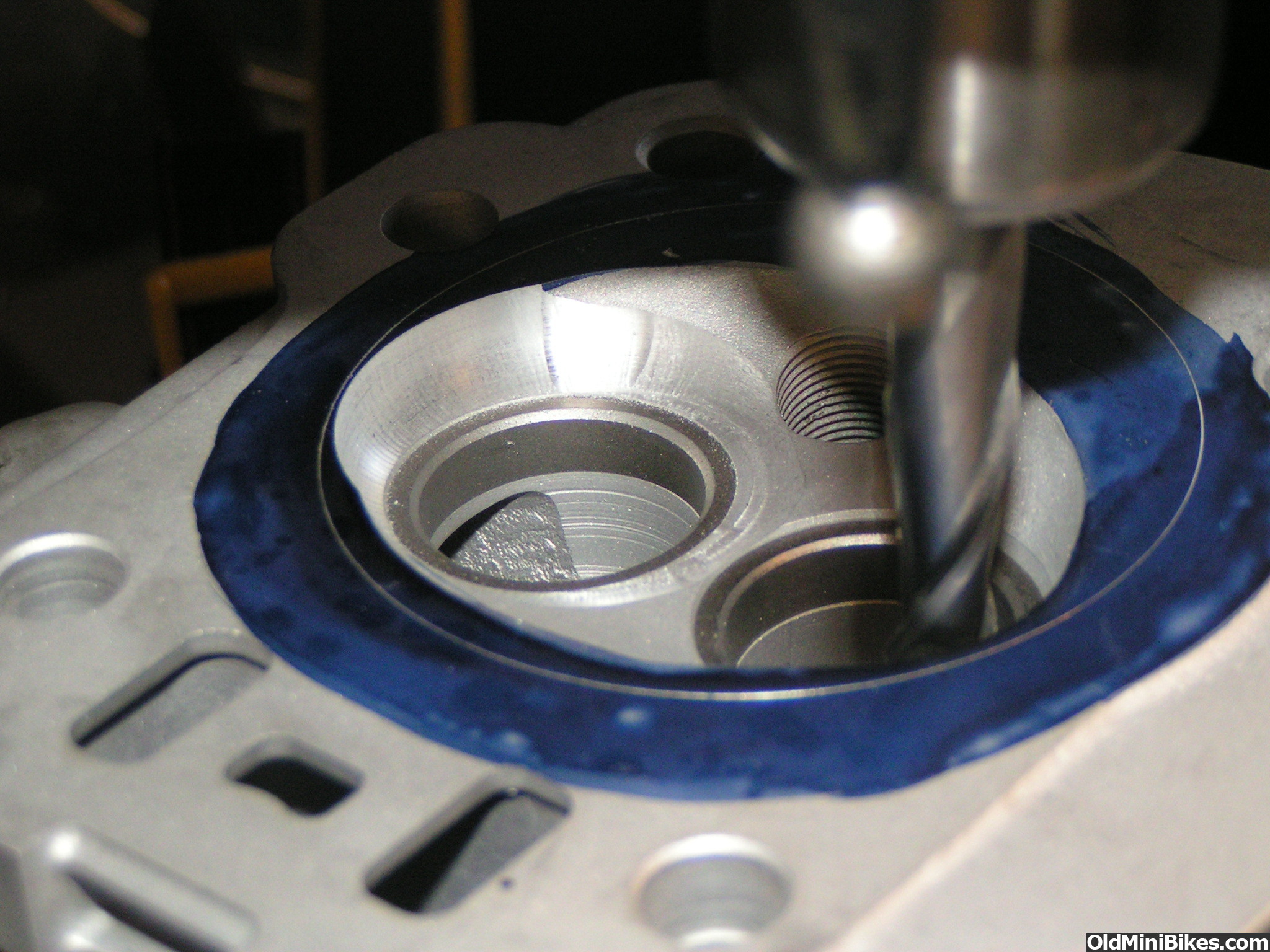

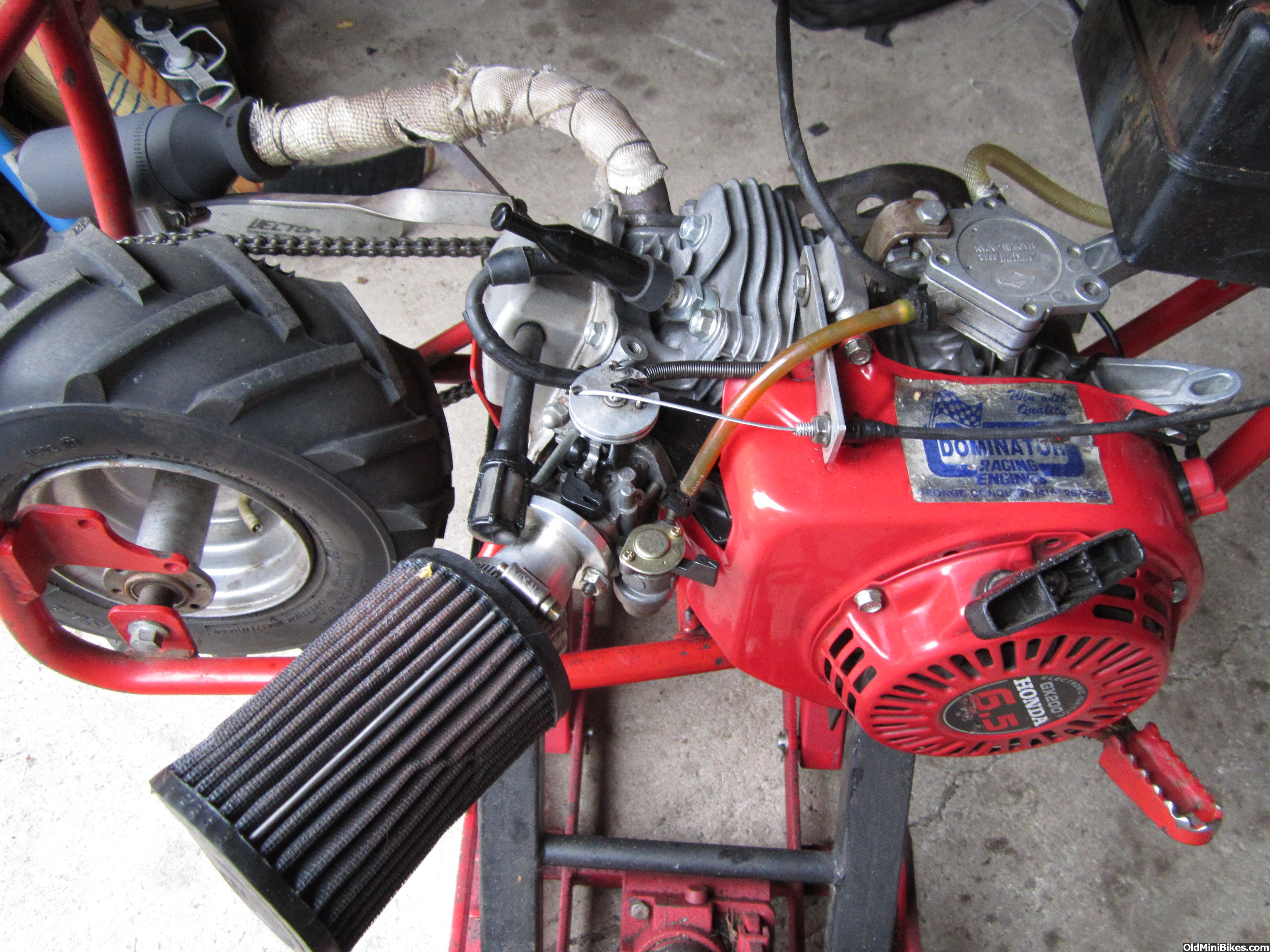

I ordered a bare 14cc head for my gx200 from affordable go karts and i got stock size SS valves, 18lbs and 26lbs springs heavy duty aluminum retainers and keepers and to go in it but im having it milled down .065 and fully ported by ajax racing engines. Now my question is am i gunna run into problems milling that much someone told me i have to unshroud the valves i dont know what that is and what springs should i use. The gx200 was a blue printed motor built by dominator race engines. Iv done more work to its since i got it. It now has a straight header with rlv muffler, ngk race plug, 3 degree advanced timing, mikuni fuel pump, velocity stack with knN oil type filter stock carb with 90 main jet and 140 etube thinner head gasket and what is being done with head above.
