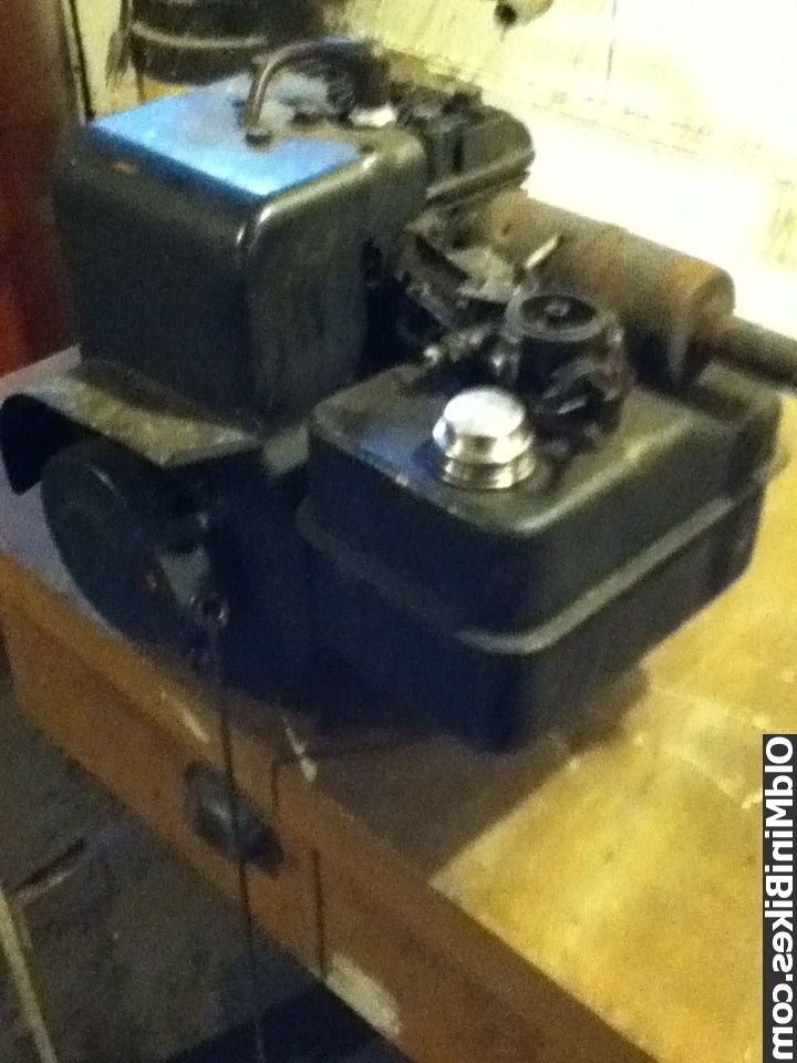

Hey guys.....I know my old 1976 B&S 5hp will run now. I just can't get it to stay running any longer than a couple of seconds. Tank is clean and full and the diaphragm has been replaced. All passages in carb look clean. pour gas in carb or use a little ether, and she starts on 1st or 2nd pull and runs for a second or two and then dies.
Apparently the old Pulsa Jet carburetor needs a rebuild beyond my technique. In case it matters, it is the one with the pull slide choke. I also thought about getting a new one (maybe a high performance if there is such). Would that be ok for my engine? I'm doing a restoration (not rebuilding engine unless I have to) of the Minibike, so I want this thing to be spot on.
