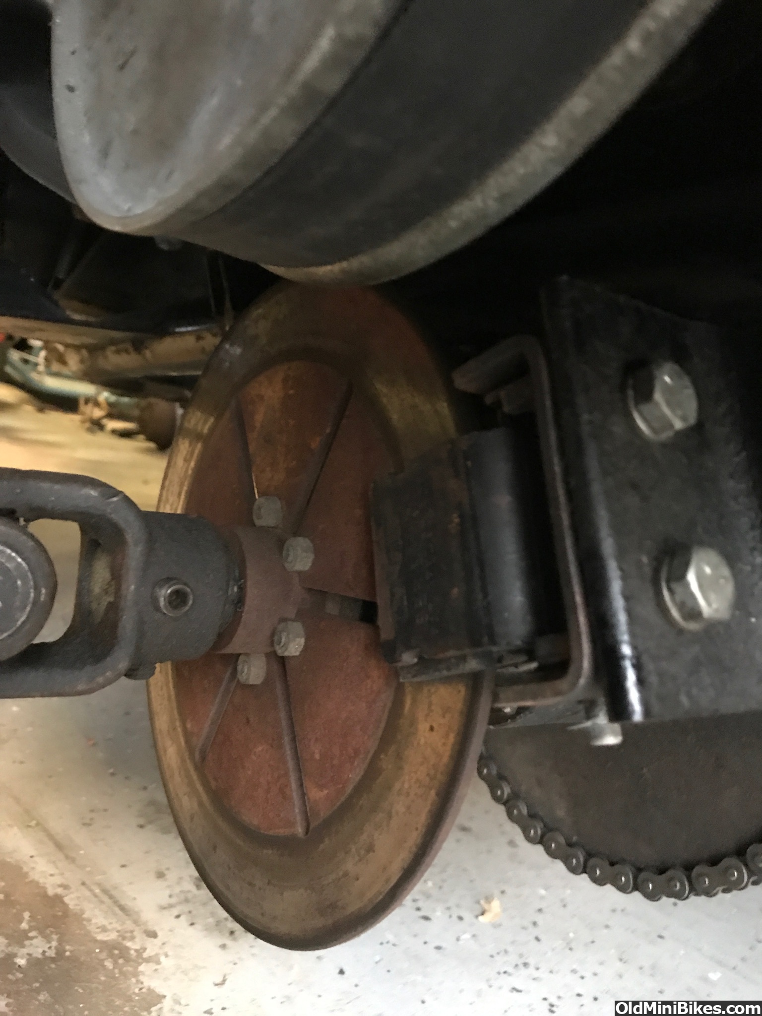

I purchased a 1974 rts sl 340 and it has no rear brake calipers does anyone know where i could get them or see a picture of what they look like they are hydraulic have two bolt hole mounts and have plastic hoses not metal lines any help or pictures would be great

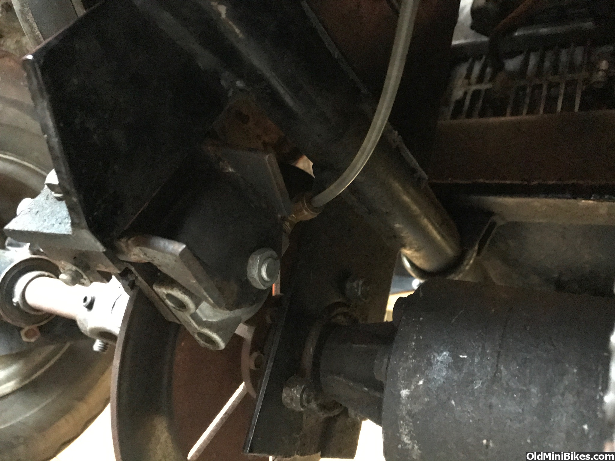

Well about the brake lines they are nylon and will work great and always have. Because of age it would not hurt to change the lines. As for mounting calipers the hard part is to make them float with the disc. The original calipers were made by Borg Warner and they didn't hold up as well as the should of. I went with Wildwood Calipers and they worked great. I used the original master cylinder and just replaced the O-ring You have to make your own mounts for the caliper.

I can upload a pic of original set-up if you need.
