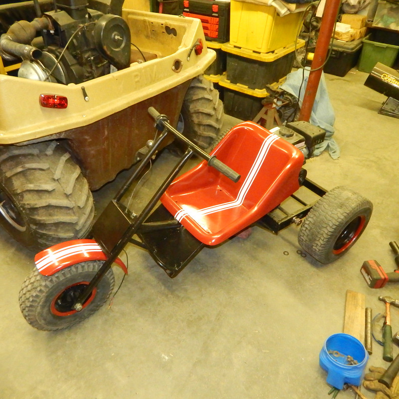

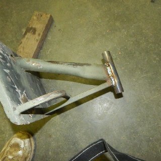

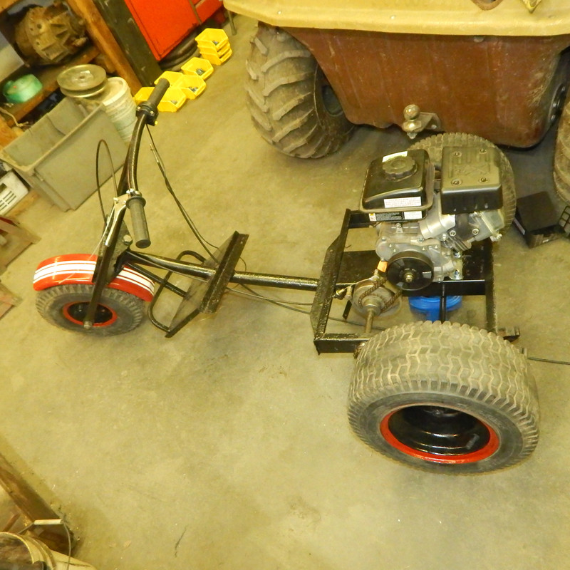

Almost have this one ready for the grandkids. Thanks to Smudvapor for finding it for us and picking it up! Once the controls are done and we tweak the jackshaft a little, we will put up a vid of the youngsters testing it out. The steering pivot was worn out, so we cut the old tube off and welded in a new one, added a grease fitting and gouged the bolt so the grease will travel to the ends of the pivot. Hopefully it will last a little longer.
