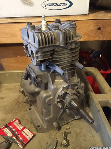

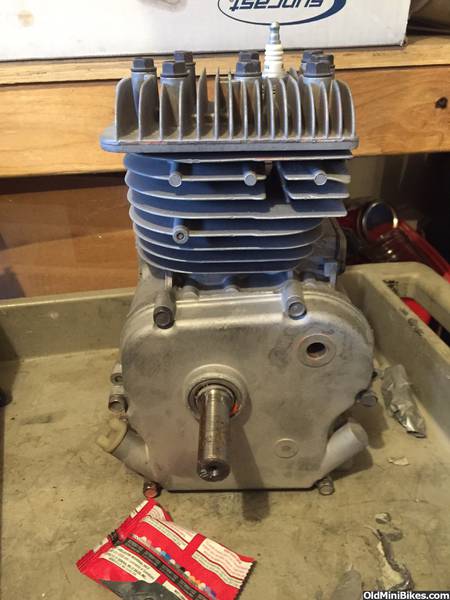

stripping paint on an engine

I did that on this engine. Plus elbow grease.
