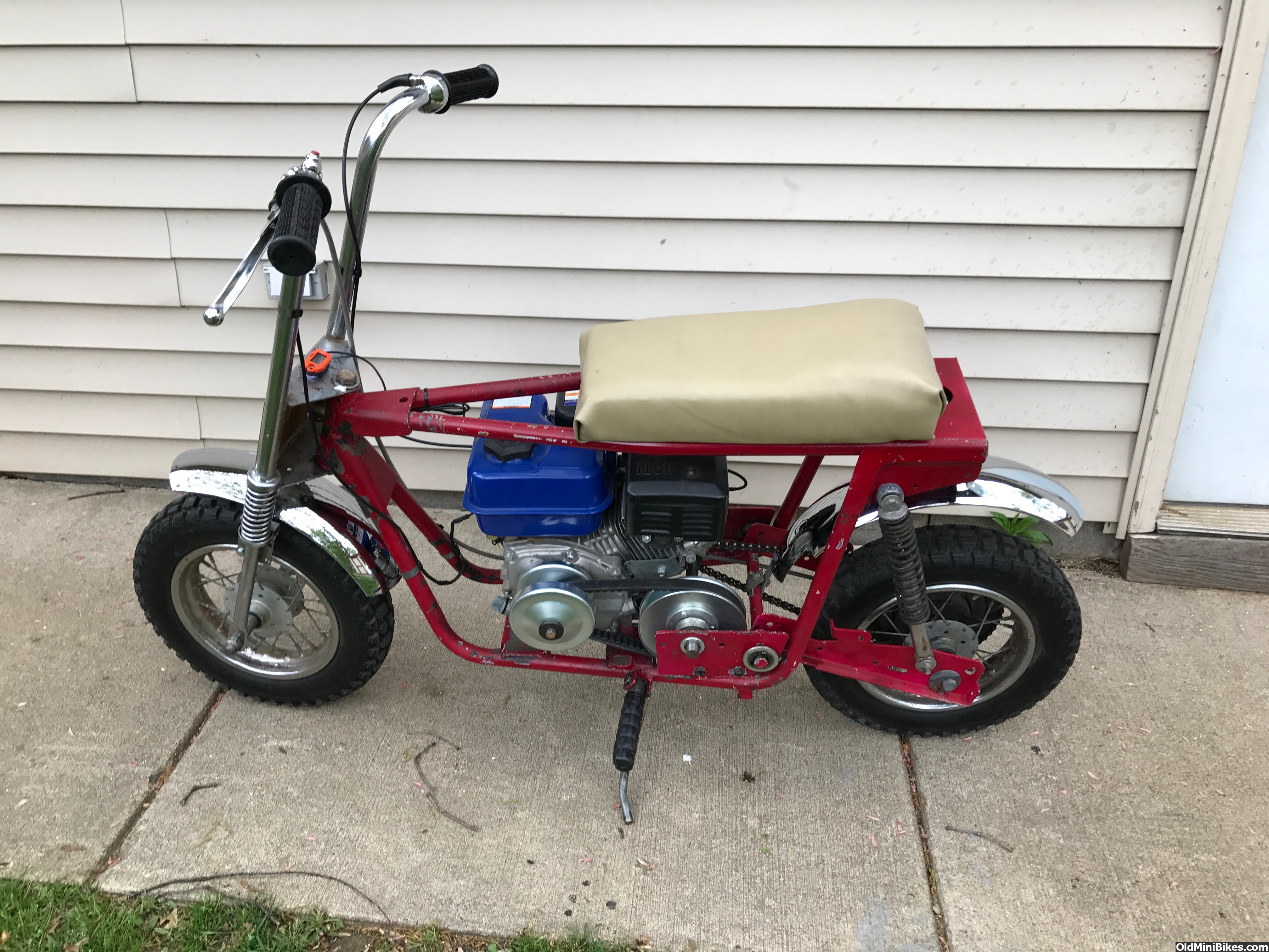

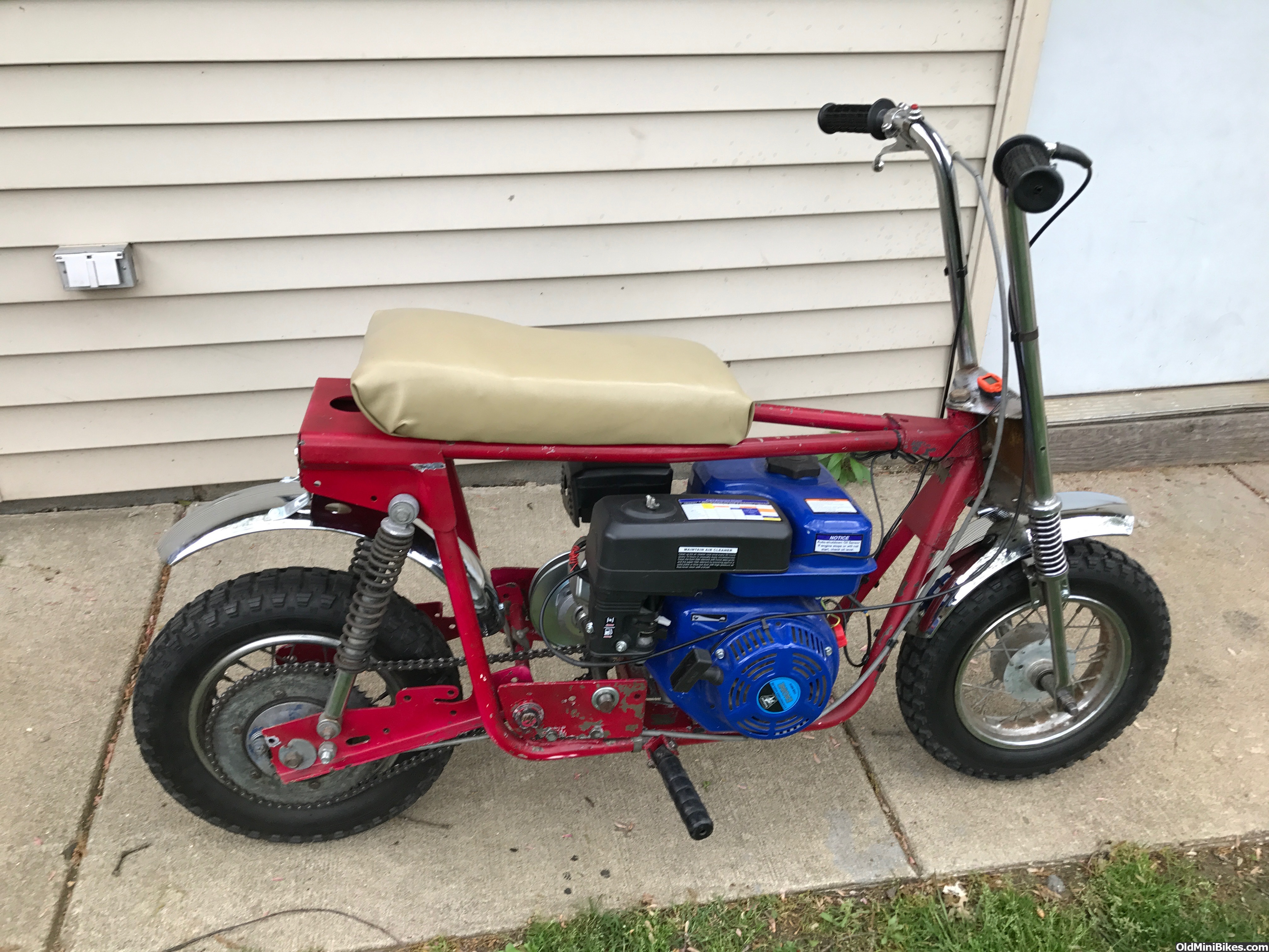

I'm a little late to the party, but I'm finally back to working on this fella. Do I still get to be one of the cool kids?
P.S. I got some help today
It's getting a predator 212 and a 3D manual clutch. I'm doing #42 chain from clutch to jackshaft and then #35 chain from jackshaft to wheel. I'll try to get the band/drum brake on the rear wheel working, but it's not the original rear wheel, so it was kinda cobbled together. I'm sure I'll figure something out. I added the rear shocks. Should ride nice now.
