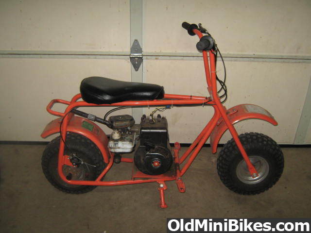

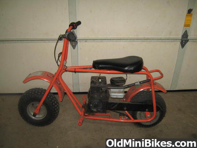

This is my 7yo daughter's DB, it has a 1976 3hp briggs with a 2hp vacujet carb to detune it some. With a pulsajet it really goes plus it will soon get a 70 tooth sprocket where it now has a 65 so it runs great for a kid but her confidence is high so she wants more "go". The engine was $15 on an old edger and the seat is from a fitness machine found on the side of the road, it keeps her forward and from sliding back. She rides it like she stole it as often as possible, she cut her minibiking teeth on a DB and I got her a Bird Wren and she hated the scrub brake. She wanted her DB back but I had already swapped a clone into it for her 15yo brother, I bought the next one I saw for $100. This is the perfect DB, it starts every time and is ridden for a couple of trouble free hours four or more days a week.
