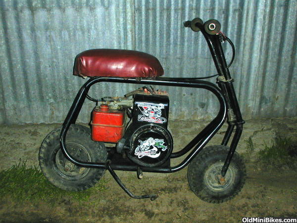

This was given to me earlier today by someone who had it sitting in a barn. I have never owned a minibike before, but for free it might be a fun restore. I have no idea what brand this is and couldn't find any quite like it. I took a few pics, hopefully one of you guys will know. Has a 3 horse Tecumseh engine.

A pic of the bike in it's entirety.

Question: All the I've seen have the bars more vertical and then the bars going from joint to wheel at a forward angle, which makes sense. These seem to be the opposite, is it possible the handlebars are on backward?

The forks are bent....bad!

It should be a Bird Wren made for Sears Roebuck...the forks are called "high speed forks" because someone hit something bending them. They should look like this

"High speed forks" Like hitting a curb or wall at a high rate of speed LOL! Maybe you could bent them back with a lil heat and some elbow grease lol

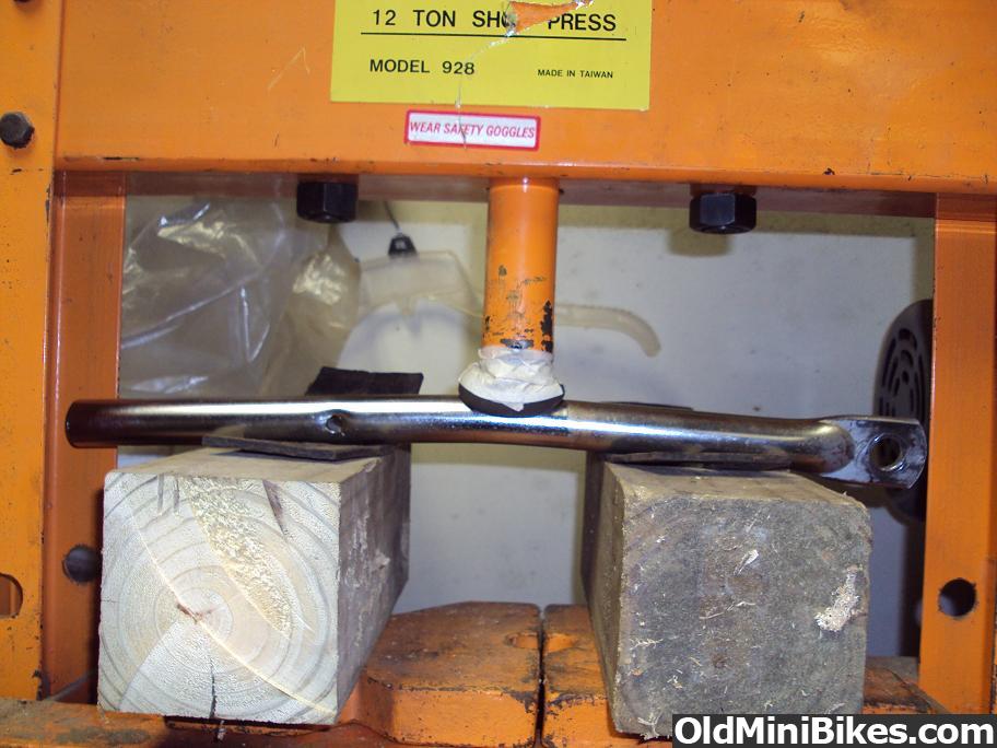

Well, may as well attempt to straighten before buying replacements. Heating shouldn't weaken them...I may heat them and get them back into shape, then let it air cool or bury it in sand. If I can get it to bend fairly easy under 1000º it shouldn't weaken it...I don't believe.

The easies way to fix them is with a shop press like this. Don't take a hammer to them because you will dent the tube. I don't like to use heat because it could cause problems like cracking. That's a nice complete survivor bike,
