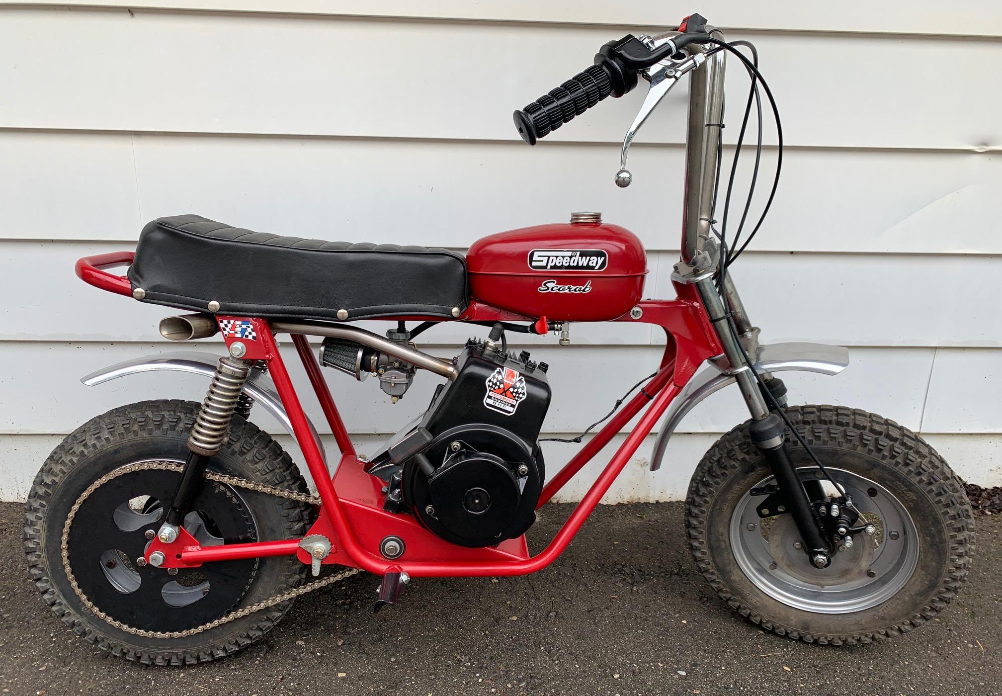

I make exhaust all the time for my Tecumseh powered flat head mini bikes. I use 7/8" stainless steel tubing with a .065" wall thickness. And a bender as was shown above. TIG weld everything with stainless steel filler rod. It works great. Also use 1 3/8" tubing on the end of the 7/8" to create a "Harley" end to the exhaust. I have a 12 ton harbor freight press and a Die i made that narrows the 1 3/8" to about 1", and then fill weld it to the end of the 7/8" tubing for a nice look. I do not argon fill the inside of the exhaust to prevent "sugaring". If you keep the temperature low, and move fast, there's just no need for it. Also it's on the inside of the tubing, so if you get a little sugar it's really no big thing. A die grinder can take care of that if you think it's needed.

Here's an example of a stainless exhaust i've done:
http://www.pinrepair.com/minibikes/p/speedway1972scarab_mine5.jpg
http://www.pinrepair.com/minibikes/p/speedway1973scarab_mine3.jpg
I like doing a slight bend on the end of the exhaust with the "harley" end (1 3/8" tubing) and come out the side, as this breaks the sound up and makes the bike less loud (for an open exhaust.)
