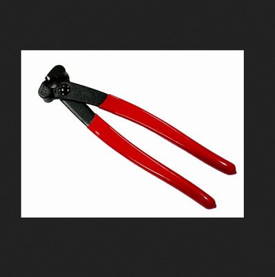

I've had the ones on the top photo for years. I also fly R/C planes so Z bends are an everyday thing.
Wire can be your friend or enemy with that tool. As stated, you have to be careful what you use. Some wire is brittle and instead of bending nicely tends to shear at the bends. Or you will get a piece that is so hard the pliers can't bend it correctly, and you end up with a lazy Z bend. Not good, as the angle lets the rod move slightly back and forth, which can change your setting, be it carb or control horn.
Honestly I now make my Z bends with a pair of dykes. Needle nose pliers are a pain. Quick,easy, and you decide the size of the bends, not the tool doing it.
Pretty simple, insert wire about 1/8" or so into the pliers and bend 90 degrees. Now stick the wire in further to the width you need to fit the linkage, and bend 90 degrees again. Grab the now formed 2 90's and twist it. Bam, you have a perfect Z bend.
