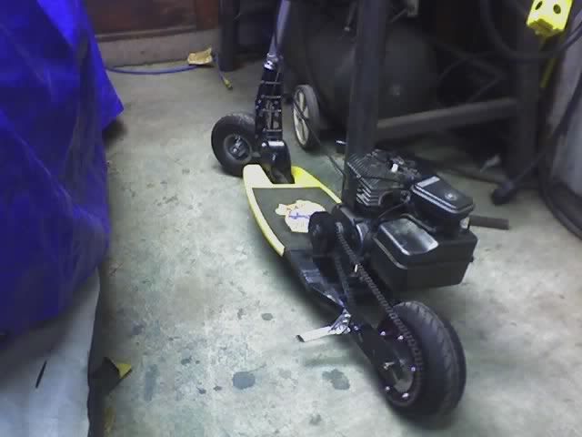

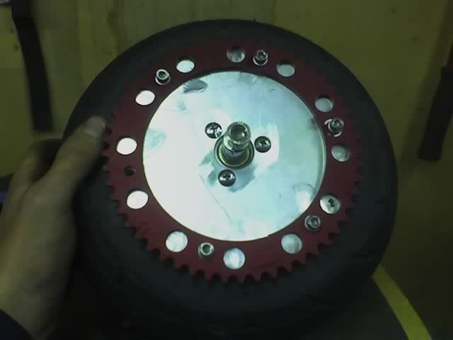

I'm not really into mini bikes very much, more into old hot rods and motorcycles. I just started college and needed a way to get around campus fast and have the torque to get up some insanely steep hills. I had an old scooter with a 1.5 hp robin engine on it. I cut the scooter in half and remade the rear section to accept a 5hp briggs motor. Milled a flange to mount a 53 tooth go kart sprocket. Nothing too special but works really good, does around 30 with the governor in place. Built in 2 days.
Before i put the exhaust on.
