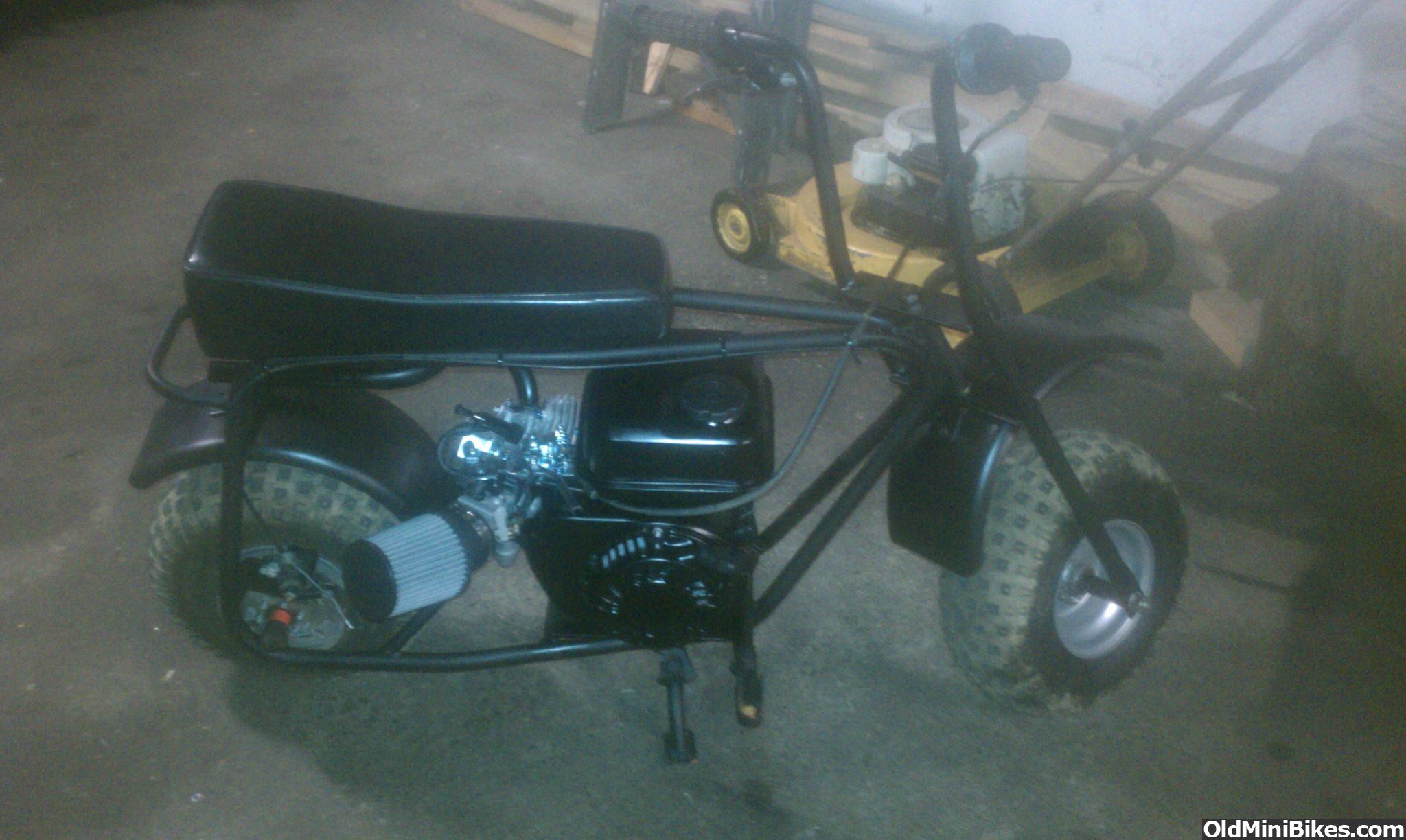

ok just recieved the adapter plate to put a predator on a doodle bug, gen 1.
slots in plate measure 80mm centerline original slots on bike 62mm....ooops! will call on monday, anyone else come across this?

I still have the plate sitting on a shelf haha. Took the whole doodle frame to my friend and he made me new slots to fit the predator on the engine mount. Figured its only a doodle frame haha
When I found out you had to drill holes anyway/it wasn't bolt on, I returned it and OMBW was really great about it. But, they did say that they were gonna change the description on the webpage to disclose that fact. I guess they never did?

Its not that big of a deal to drill the 4 holes. I did it in about 10min. The plate is a better option and has more maneuverability than just slotting it.
Here are some guide lines to follow. Scroll down about half way.
https://www.affordablegokarts.com/DoodlebugBuildUp.php
If you have to drill holes anyway, why bother with the plate? It's not that big of a deal to drill the holes and mount the motor correctly without the adapter plate.

I sorta wish I didn't make the OldMiniBikes plate work on mine because now the gas tank is so close to the frame it's a pain to get the cap off. :shrug:
I still like the plate, all you have to do is drill the holes for the bolts that mount the plate to the bike in a spot that will allow the most adjustment. It is handy for bikes that you swap motors around on often and makes adjustment easy. I am working on getting one for all my bikes. :thumbsup:

:scooter:I end up drilling two new slots on the plate on the bike,then reverse the clutchso the motor would be centered up with the foot pegs
