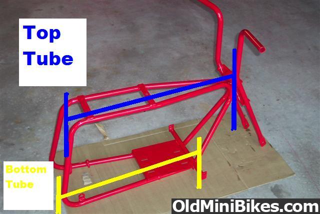

Can somebody give the the dimensions of a newer Azusa Frame (the length).
If I could get approximately length of the top tube from end to end (outside of the bends) -and- the bottom tubes from the outside bend to the front edge of motor plate.
Blue=?
Yellow=?
29 top and 23.5 bottom.
And there's about 1.5 inches from the front of the mount to the outside of the bottom front bend.
Got one fresh out of the box if you need anything else measured.
