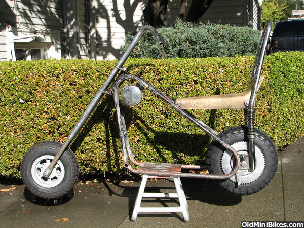

Picked up this cute little guy today. It had a 5" steelie on the front and the wrong seat. No number tag, and there are no rivet holes either. I'm not an expert on these bikes so I've got a few questions.
This bike has a jack shaft....Is it true that only the Hodaka bikes had this?
There is a mount for the brake cable on BOTH sides, and they both look factory. is that right?
The cylindrical tank that goes on the frame, what size is it? I've heard 4"x7", but I've also seen the smaller 3 1/4"x7" ones. Did all of the chopper frames get the tank bracket, even if it came with a engine mounted tank?

Congrats on your frame! Bonanza changed the frame a little bit, adding the jackshaft mounts and adding additional slotted holes to allow for the Hodaka engine. But I think all the frames eventually were made this way, and the Tecumseh powered CR400 version didn't use the jackshaft. Because the Hodaka uses the jackshaft with the wheel sprocket on the opposite side from the Tecumseh rear wheel set up, they had to be able to set the brake up on either side, hence the cable bracket on both sides. Look at your engine mounting plate for the wear pattern where the engine would be, even under recent paint, this will tell you if yours was a Hodaka powered or Tecumseh powered bike and which model it would be called. The cylindrical gas tank was an option for the Tecumseh powered model. The tanks were 4 X 7 and were the shorter of the two that Bonanza made. All frames came with the little box shape flat bar mount near the headstock of the frame. Good luck with your restoration. There's a guy on this site who makes reproduction Bonanza brake drum sprockets and ones that will fit the Azusa Astro wheels if you want the "Torque Thrust" style wheel. Also Bonanzamini makes reproduction parts but are pricey, but excellent. I'd use the rear wheel that you've got, but you could use almost anything up front till you can get a kidney bean wheel. I have an extra used seat in fair condition if you need one. Even a bare fiberglass pan is hard to come by to have recovered. The exact reproduction seats are quite expensive. Here's a picture of my second chopper with my spare seat. My avatar picture is the chopper I've had since 1970.
Hodaka
Looking more closely at your pictures, I see that you have the smaller diameter rear sprocket and the jack shaft and I'm thinking you may have what was a Hodaka powered CR 500. You also have the newer style Carlisle tread rear tire that came with the Hodaka era frames. I have been gathering some Hodaka motors and parts to put a motor together for one of my bikes. You can actually still get a new off shelf Hodaka Ace 100 for your bike, but it's two grand to get what you need. Check out the pics of Bayareaburrito's mini choppers, he's on this site and is helpful with minichopper info. He's got a great CR-500 in this picture, I find it inspirational.

I believe bonanza offered the Scout CR-500 with either a 4HP tech or the Hodaka ace 100
Not sure about the brake adjuster being on both side's of the frame though? I'll have to check mine the next time I visit where I have it stored.
Also not sure why it is that you do not have an ID tag or the holes where it should have been located on the frame.
The round tank was a optional item if you had the 4HP version.

Thanks for the info guys. I happened to have a NOS seat I've been saving and a spare kidney bean front so I'm set there. A little brakleen on the motor plate and it looks like a Tecumseh footprint to me. HS40??
I have a sweet 4x7 tank that came off of an old Jacobsen mower, only thing is the petcock is on the same side as the filler opening. I know on the other Bonanzas (non choppers) they are on opposite ends, but other than that I see no difference. I'm still perplexed about the lack of ID plate, or even holes. I looked on the underside and there are definitely no holes....Hmmmmm...
The rear sprocket and brake are in real good shape with minimal wear. The back tire is a no name, as in there is no name on the side, just the size and MADE IN THE USA on it.

Don't forget...there was a CR 410...Tecumseh powered with a jackshaft. The motor plate on your bike looks like it had a Tec on it.
Cool, CR 410- thats what I thought, I saw that brochure but it was a little hard to see the details. It looks like that one has the mounts for the jackshaft, but it's not used. There's a frame on ebay right now, but the motor plate is different than mine. Plus there is a funky bracket otn the top tube under where the seat mounts- is that for exhaust??
