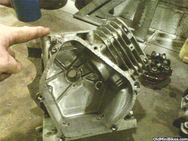

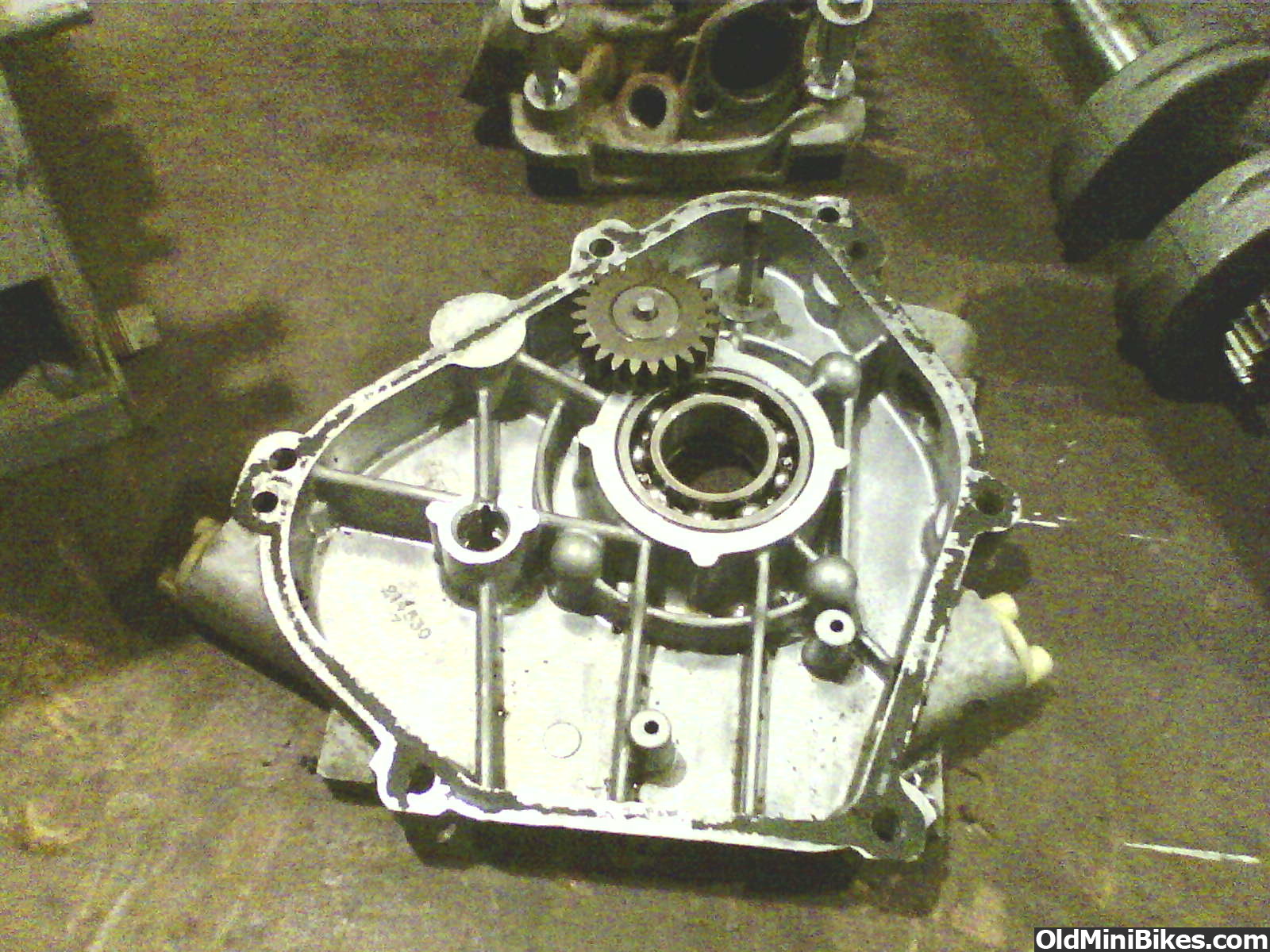

so i took it all apart today everything looks good :thumbsup: i think :laugh: now i have another question on the crank case cover there is the gov. gear and another metal gear that mesh with the crank timing gear after changing the crank bearing , crank ,cam and rod do i need to reinstall the metal gear if not using the gov. ?
this is the one i am talking about :thumbsup:

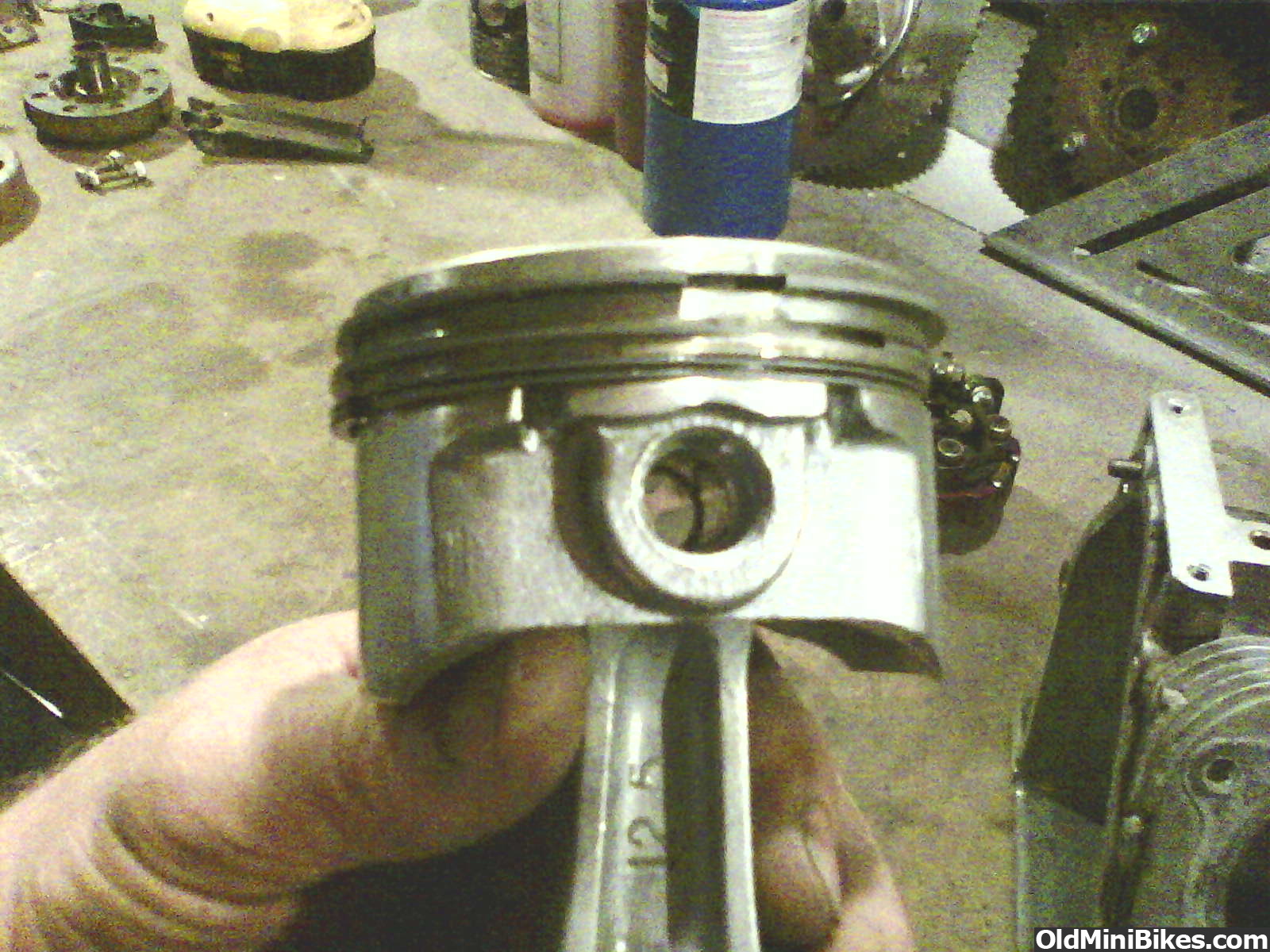

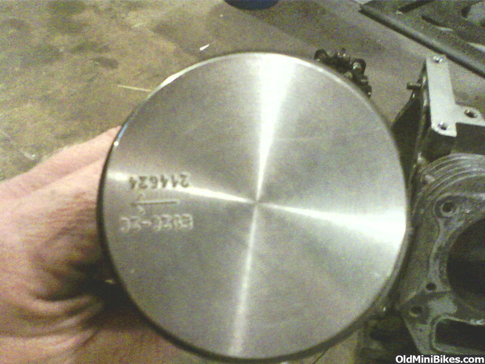

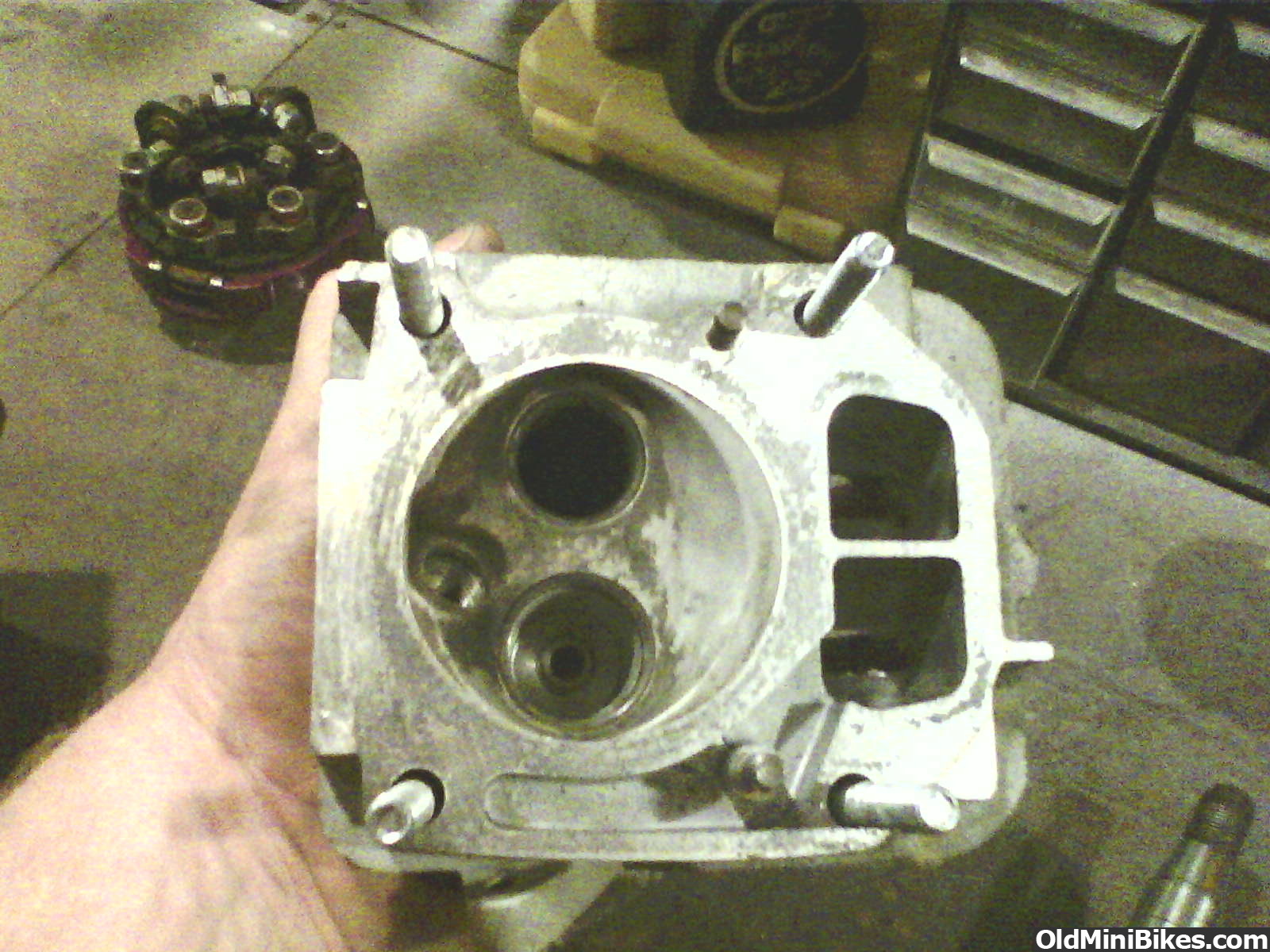

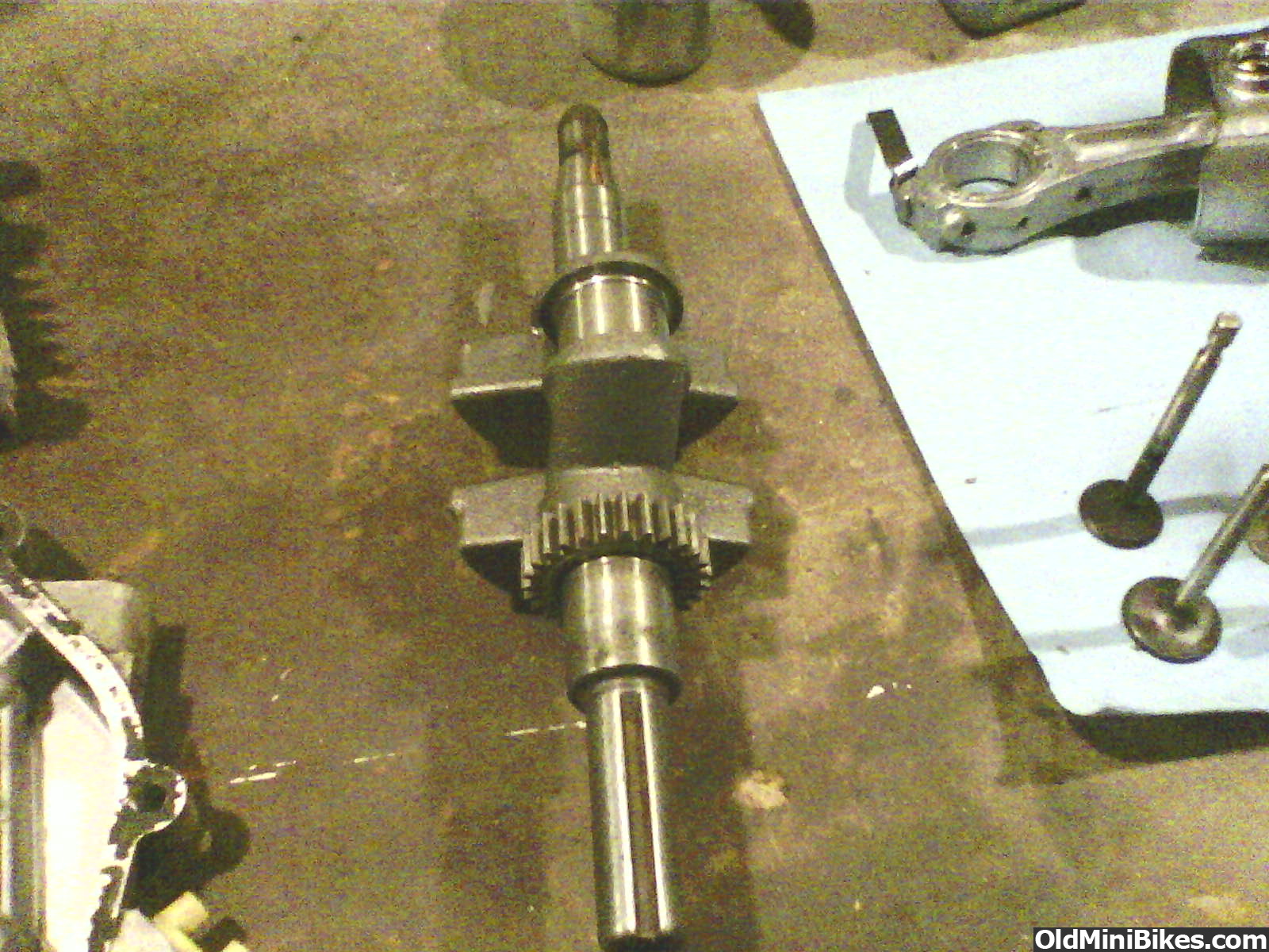

here is what the rest of it look like. bore shows no wear scratches etc. and after cleaning piston looks brand new so it should be alright to reuse with arc stock length animal rod :shrug:
