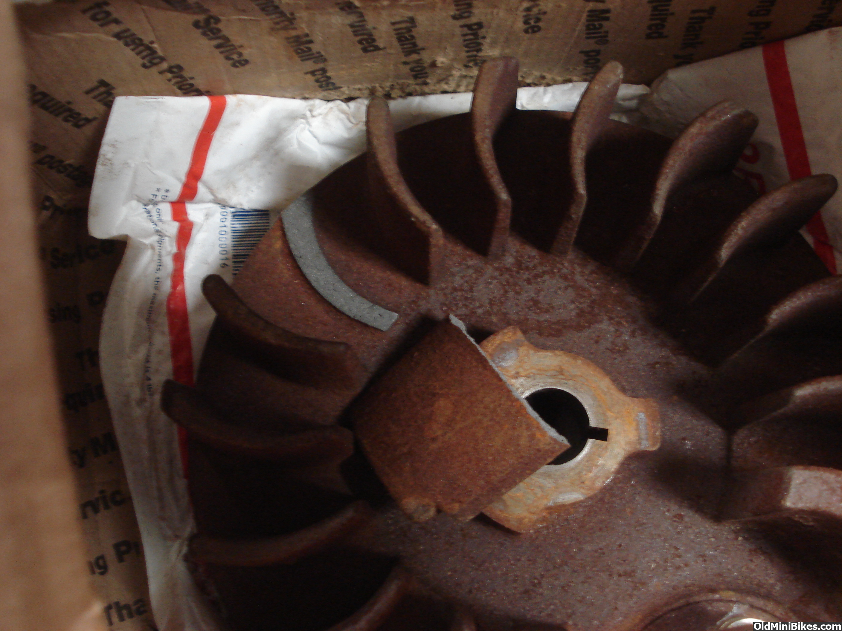

Can this be fixed???
I don't think so but I wanted to ask. This arrived in the mail today and in my opinion due to laziness it was ruined. Absolutely nothing in the box to protect it and it rattled around like a marble in a tin can. Box was way to big and it had lots of room to move around. The box looked like it had been in a fight all the way here. Sad, just sad...

My pseudo-professional opinion is no. I don't know how anyone could braze it back on and keep the fins balanced. Some guys run 'em with broken fins...but it's a sure sign that you probably have another fin that's cracked, given how it was shipped. Only magnaflux will tell.

guys, I had one explode on me on a 12 hp tractor while manually reving past the gov......It ain't pretty,it punched a hole in shroud & almost came thru! I wouldn't chance it. there are too many around. Mick
#6
If you've ever seen a rotating part explode, it's likely you wouldn't want to see another one, unless it was at a safe distance. Having it rotate between your legs is not a safe distance. :)
It's a cast part. It sees thermal stresses and constant velocity changes. It's junk.

Can you return it to the seller?
You did not pay for a busted flywheel!!!
Return it to the seller..if he doesn't take it...start a case with Pay-Pal
Ed Zachery!!! I didn't buy a broken flywheel.
I have already sent a return claim through Ebay for it. So we will see what happens.
And I have to agree that there is no telling with out magnafluxing it if any of the rest are damaged. It is a clean break so it happened since it was shipped. I started to express the desire for extra box filler so that it wouldn't get damaged but forgot to ask in the notes section.... I doubt it would have come any different.
