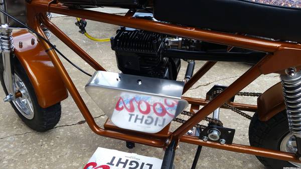

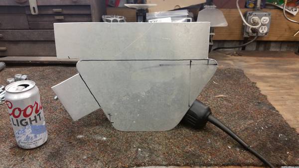

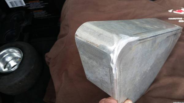

Looking for some custom home made clutch cover ideas to bolt up to predator motor , these are all different ones I have made , all aluminum ! Good luck , I use a piece of angle iron to bolt to engine and I drill holes in the top and weld 5/16" nuts on bottom side to attach the guard , they will work on Briggs , Tecs or Clones
Dude! Those are sweet! Did u make them out of aluminum? Tig weld?
