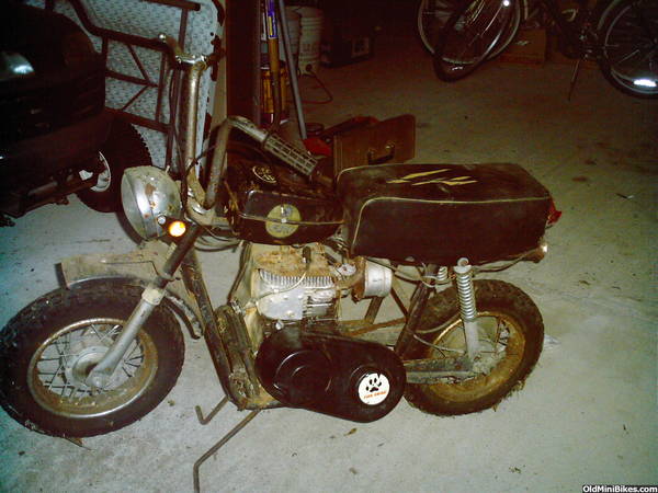

I recently found a Rupp It has a Silver H Tec motor on it. I have seen white and black but not silver. Now on the HS motors I have seen Silver Tecumseh. Can anyone confirm? This one is off a Goat.

Not on vintage mini bike models as far as I know. I think there was a sliver h50 later on in the 80's on lawn equipment.

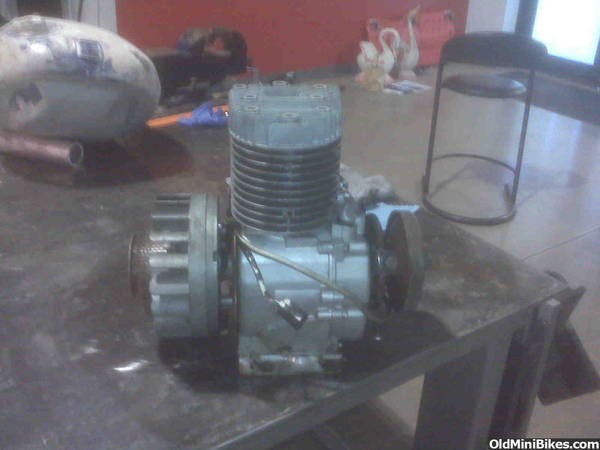

Do you know if a Rupp goat would come with or could be ordered with a H60? The number on top of housing is pitted and it looks like a 5 or 6 hard to tell. I will get a pic. Someone can tell if there is silver original paint on motor.

they did not stamp numbers on the shroud in 1969 so there's your first clue-Not even from the mini bike era.

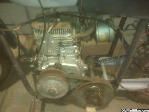

That's the motor. Did that fox come with an H5 or an H6 or either? But it looks like the H that were on the Fox was lighted. I have probable have a blower motor. but what company sprayed their H motors silver other then mini bikes. Ex. red/white toro and blue sears etc....
