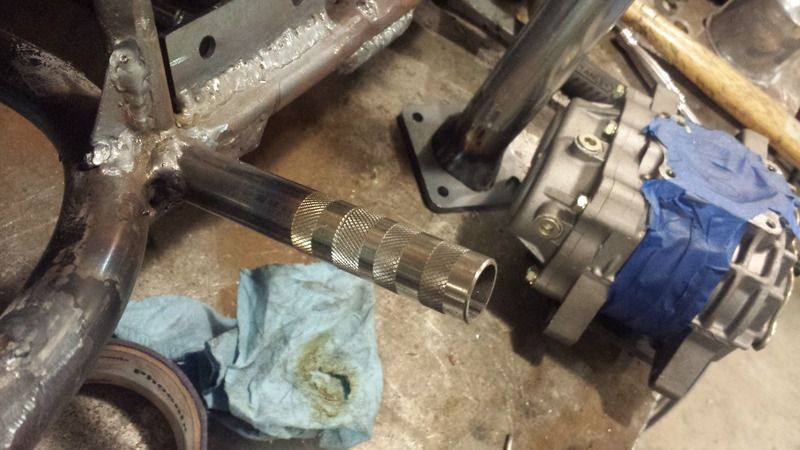

Thought someone might like to see the bike I'm building. Started out as a new-style DB30 that I cut up and grafted on the rear-end of an aborted chopper project. The bike is going to be used in 100ft drag racing, and will be powered by an AMR300 supercharged 342cc Briggs engine. I lost a bunch of my photos with my old phone, but here are a few that I have now. The frame is just about done, and I'll be working on the brakes, engine, wheelie bars, and supercharger components in the next few weeks. Still need to come up with a paint scheme too.
Original frame after stretch:
New rear-end mocked up:
Final placement before welding:
Aluminum engine plate, exhaust and jackshaft fabbed:
New front wheel, drag bars modified, rough tank placement, frame final welded.
