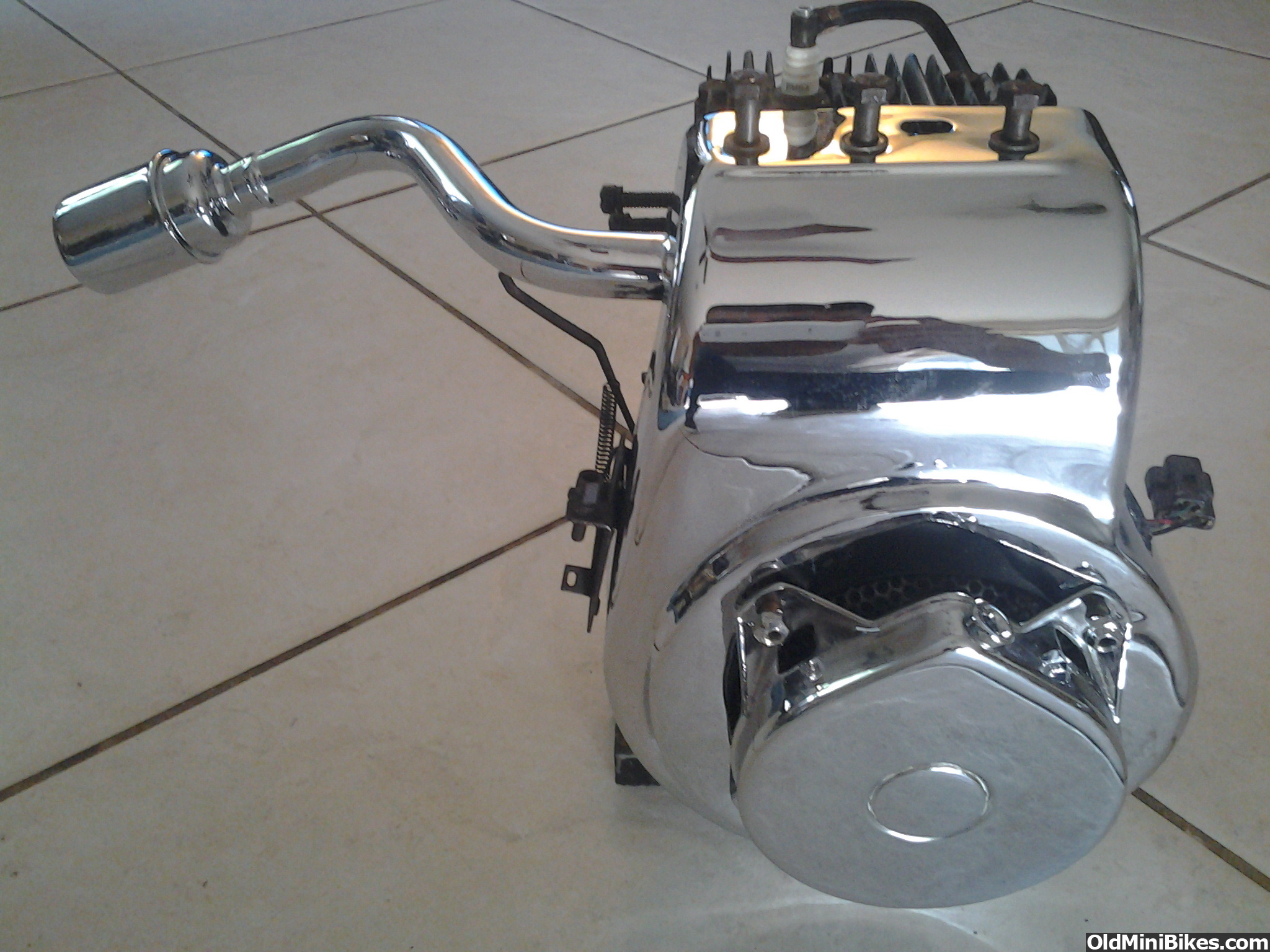

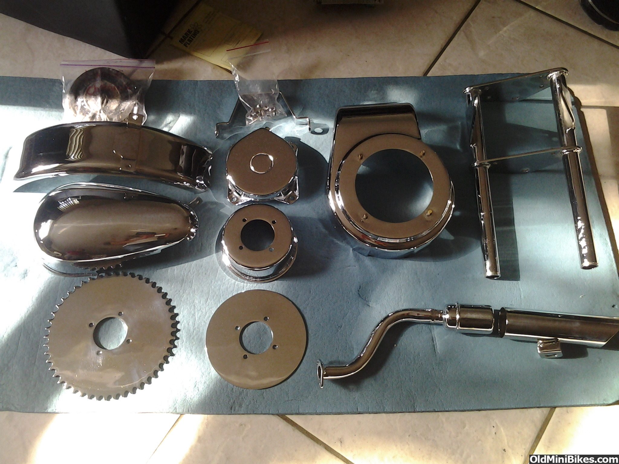

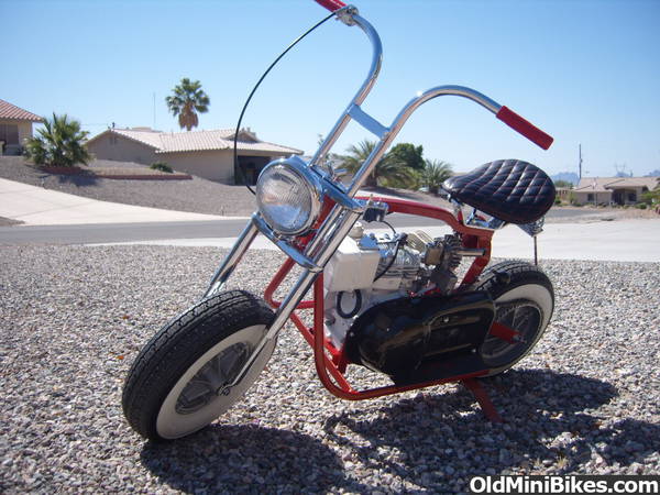

Go with chrome imperfections in the metal will be welded up then polished out . Chrome plating will cover nothing , if they leave a scratch then you will see it . Although the more they have to repair the more it cost . Here a pic of a rupp front end I had done here in Knox Tn .
