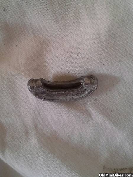

Get home and decide to strip the motor on the cart. Valve cover comes off nothing looks wrong. Then i removed the head - and what do I find - A bent washer.
This motor has never been opened or worked on - stock out the shop.
There is only one litle impact mark, must have been on the first pull to start the motor. The only thing I can think of is during assembly they dropped a washer in the carb or exhaust port and the really rough road and the valve open could have shaken it into the bore.

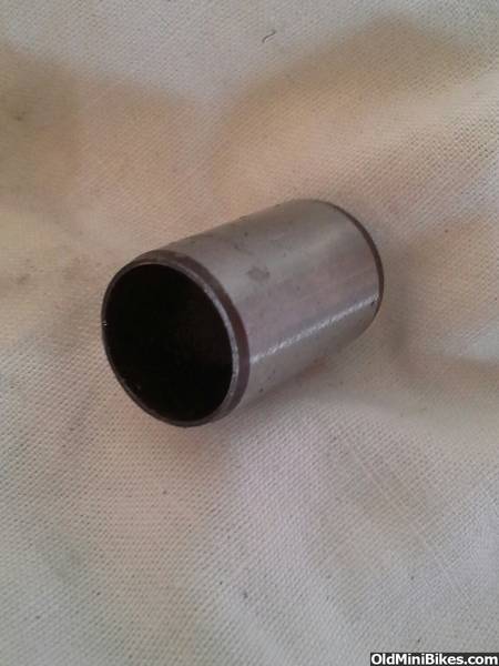

Oh engine is running fine only I have this bit left over, do I have to strip down again and put it back or am I ok to run.
What is this and where does it go
