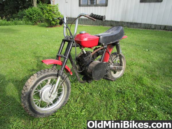

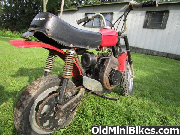

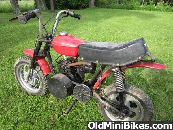

A Rupp specific H35 will be a ball bearing 3" crankshaft engine, if its off just about anything else its a bushing sidecover and like 2 7/8" shaft length sometimes 3". Since your working with kind of a Mutt bike you cant really tell until you pull the driver off the shaft to see what the seal looks like.
