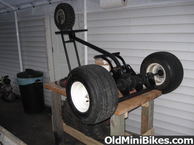

Well hell... That's a 3 wheeled death machine. :eek: :scared: :lol:
Pretty cool looking trike you have there. Looks like it might be a real wheelie-machine. Be carefully trying to turn. Might be a bit light in the front end & prone to skipping instead of turning.

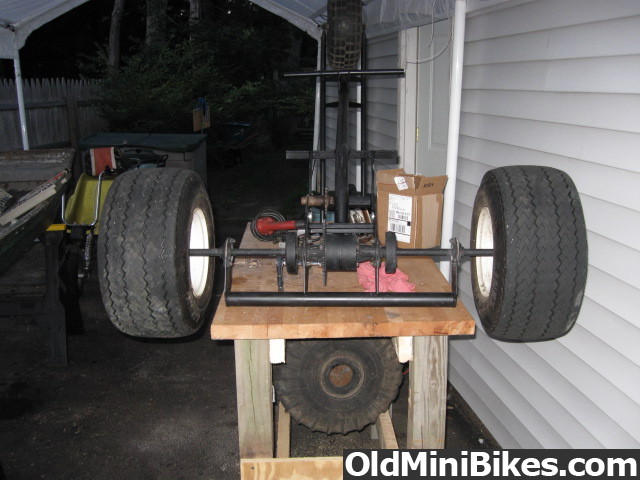

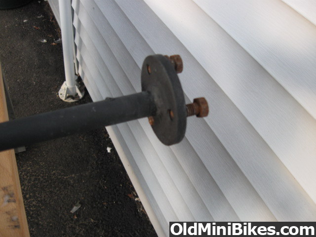

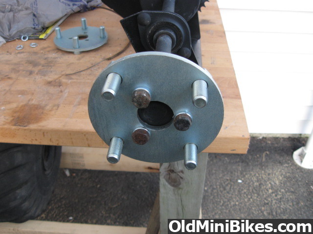

I also believe the rear end was flipped so the person could make it a direct drive. (Sprocket looks like it should be on the other side).... I am sure it is not an origianl engine. The one on it comes up as a 6bs Briggs. 1.5 horse power made between 1955 and 1958... Gonna toss that one...lol

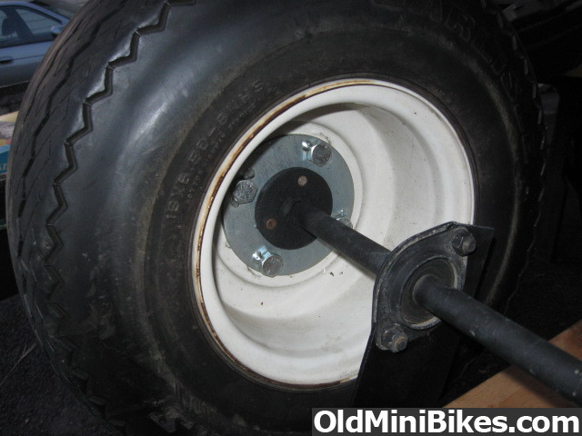

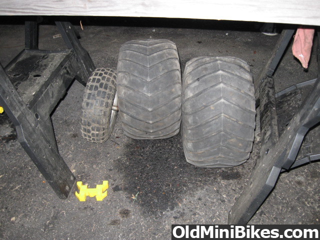

If those rear tires arn't junk and hold air they work good on sand might ebay or craigslist Dom't know what kind of tires you want but you might hit up mower repair shops for rear tires off blown up riders they come in all sizes should be reasonable in price or your local scrap dealer lot of old riders end up there scrap yards sometimes good source of used supplies for fab work
Actually it will turn on a dime. Most had a differential and two rear brakes "which yours has" You'll be fine.

I agree with Randy on that trike 90% of the weight is forward of the axle and it takes a lot of HP to lift the front end. As for turning with even just band brakes it should turn real nice. As for what tires to use that really depends on what your riding area is going to be. If your on a wide variety of surfaces then a Carlisle Tire with a Multi-Trac tread is very universal and comes in lots of different tire widths and diameters. The tires you have may be great for mud and sand but do have a lot of drag. So tire selection on a small HP machine is very important.
