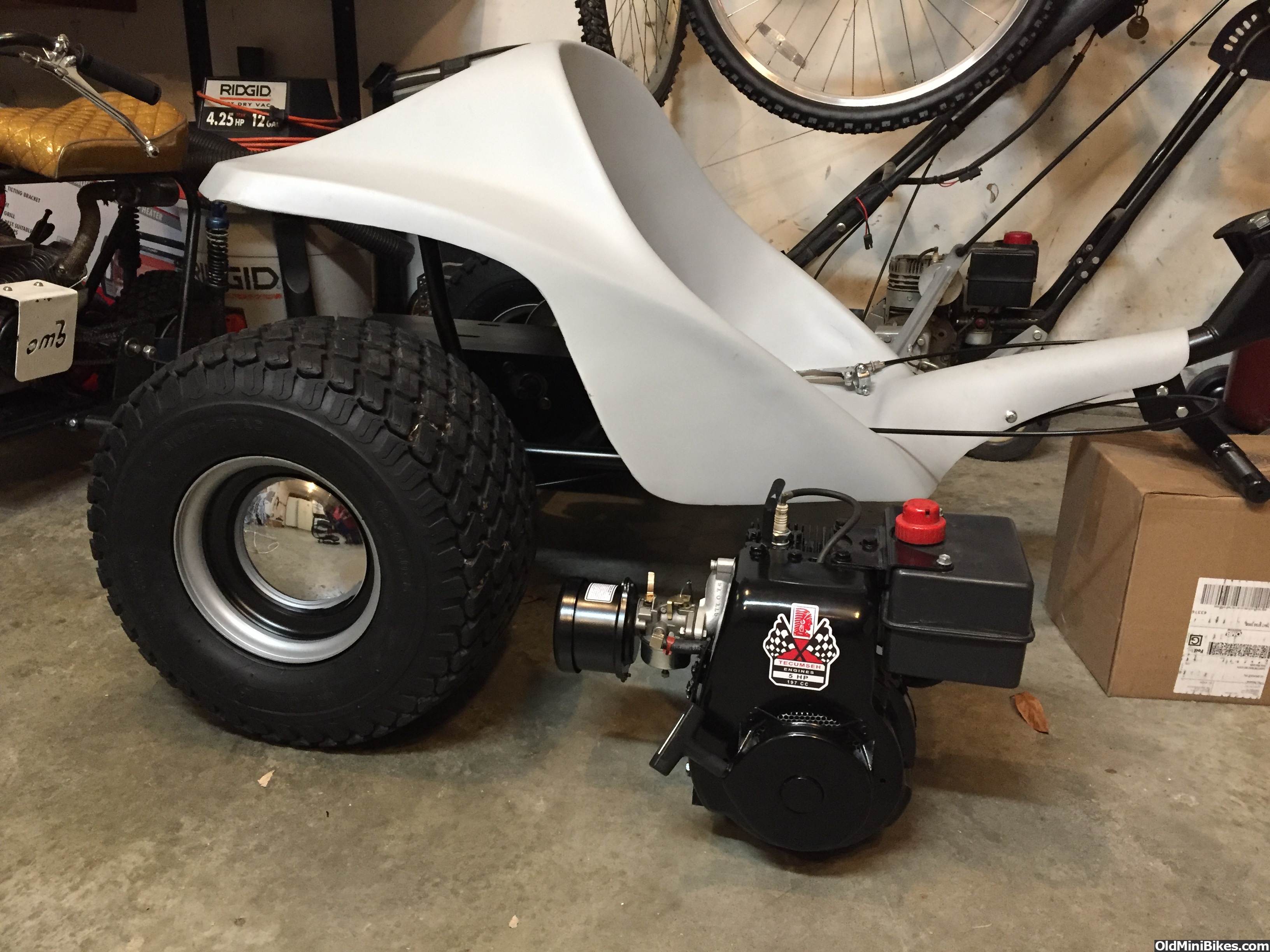

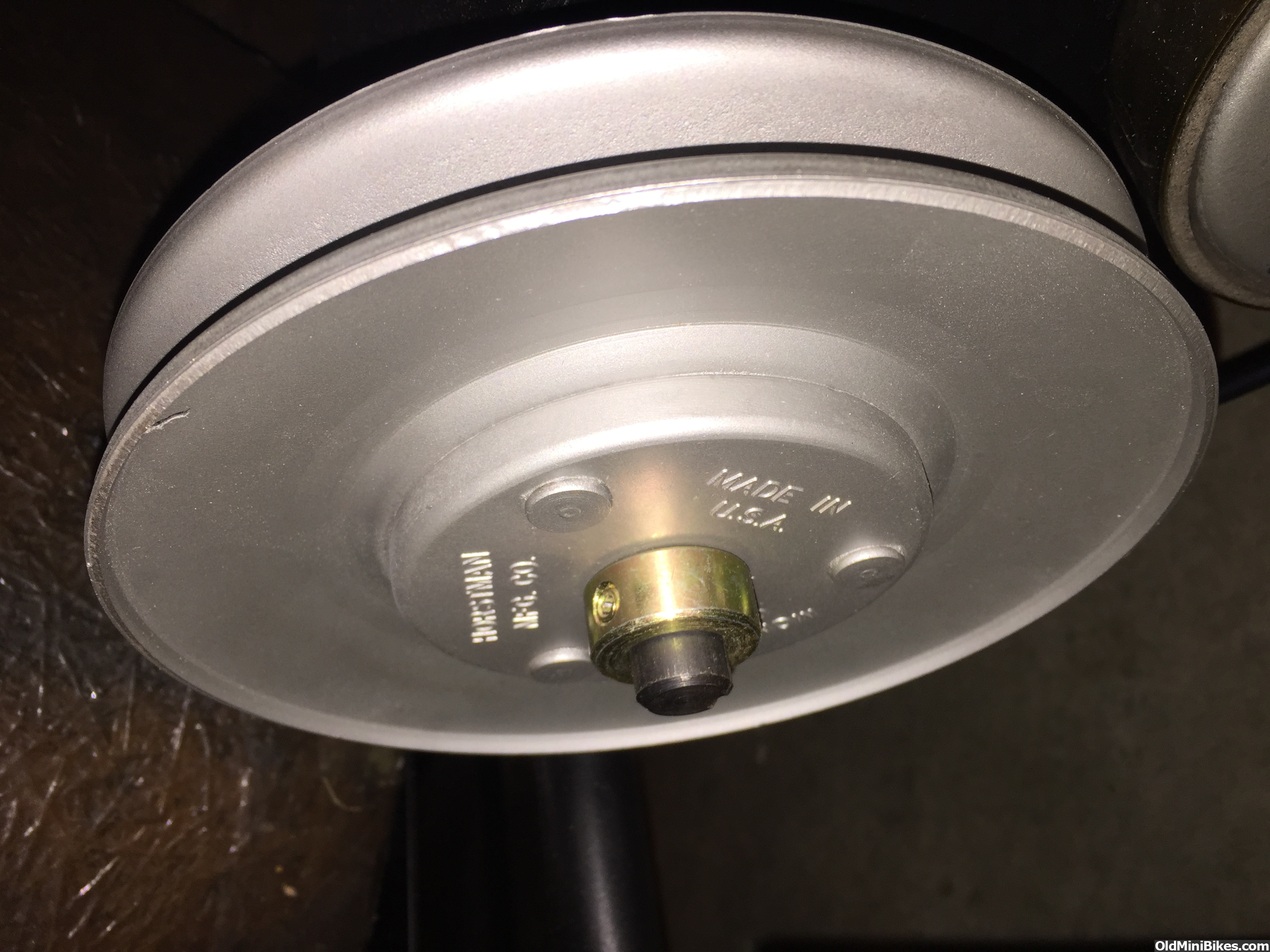

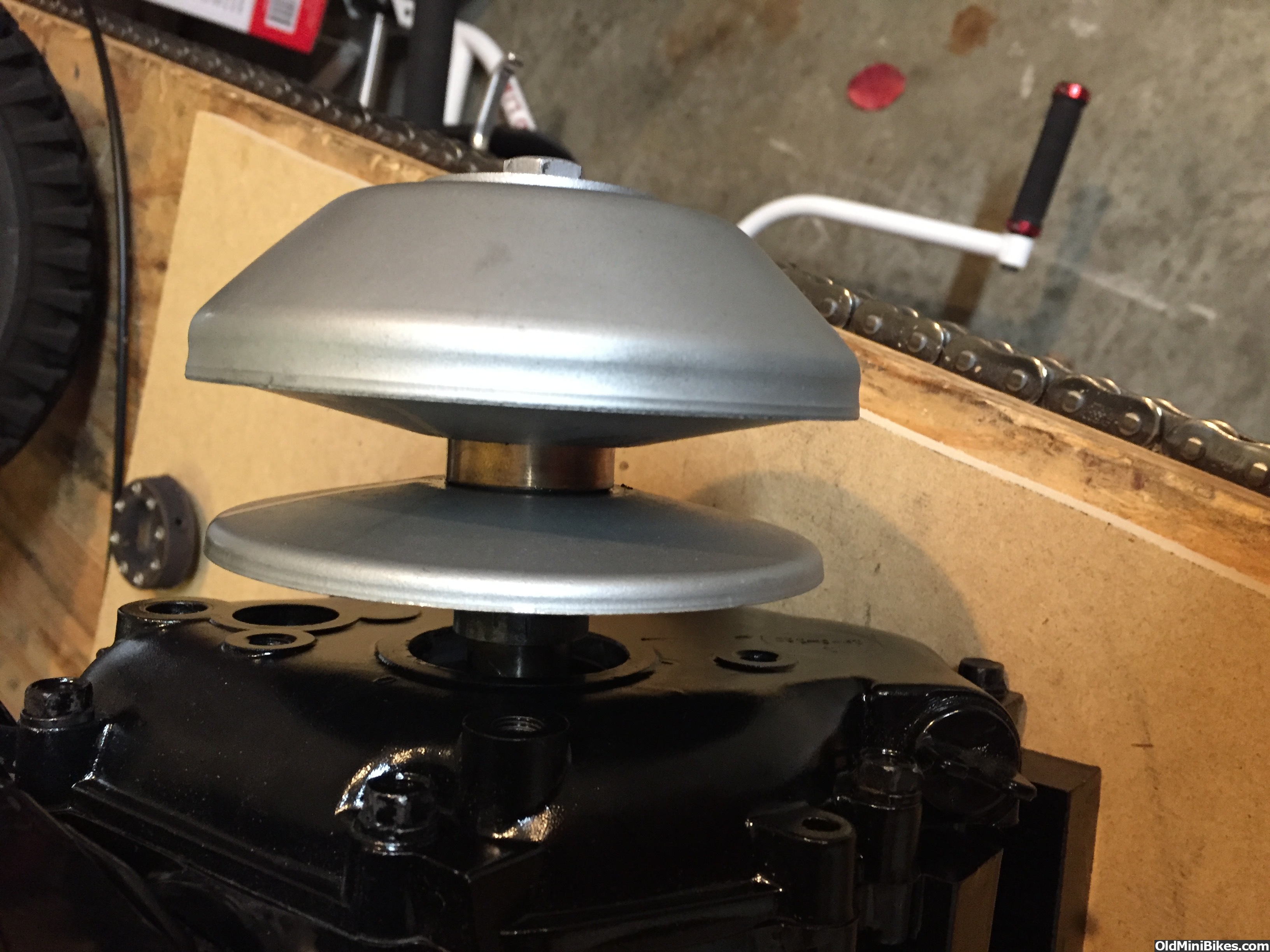

Okay, this is the latest project. Everything on the torque converter and motor looks to be original. I am looking to replace the belt. It is a Horstman torque converter. Driver unit is 4 1/2" diameter. Driven is 7" diameter. This is a symmetrical unit. Belt reads CAT MINI BIKES HPE MUSKIN 904-1042. Looks to be 5/8" wide at the top. Belt circumference is 33" measured with a circumference tape. Belt tension is set according to motor placement.

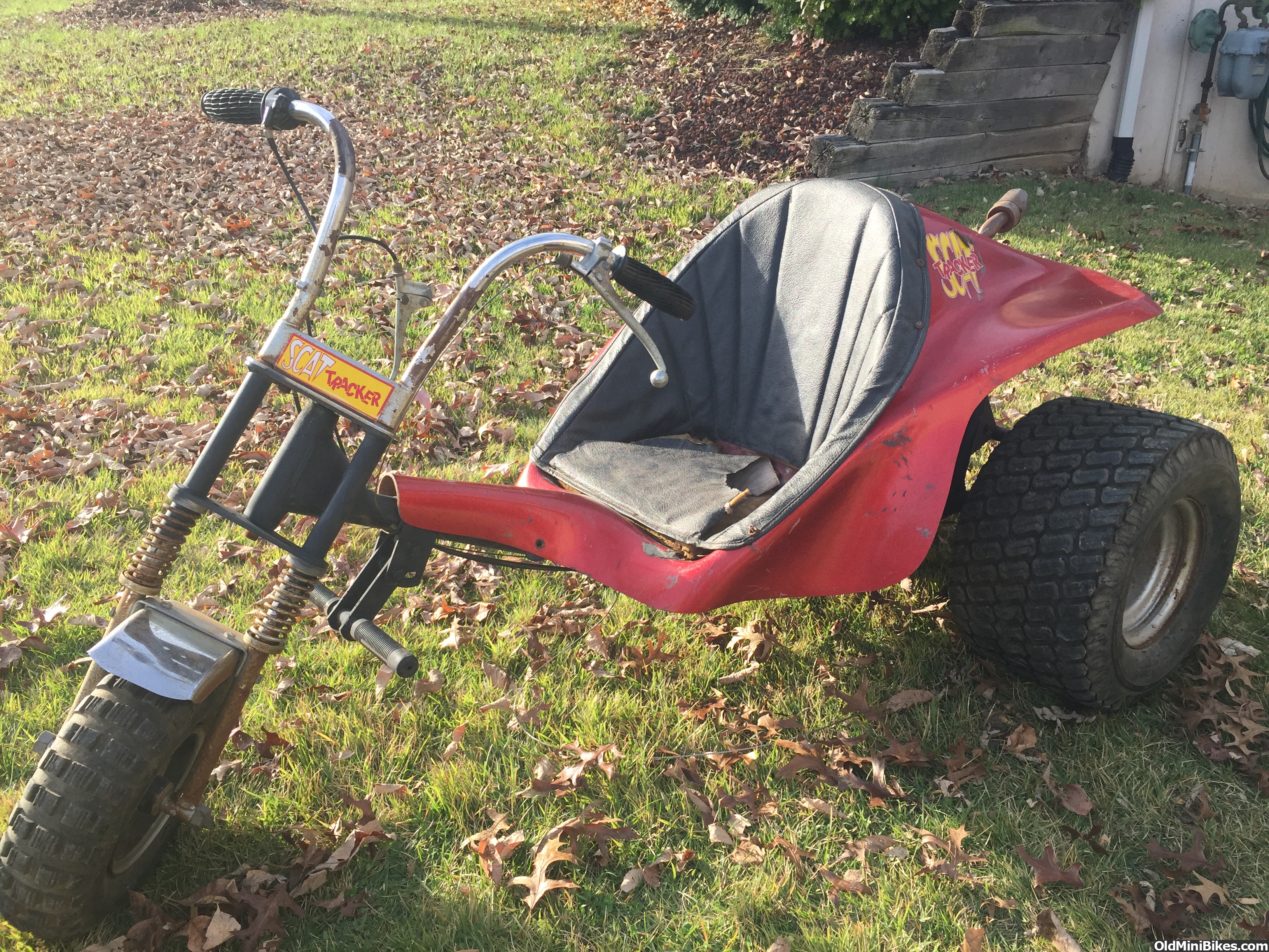

Looking if anyone knows what the center to center distance should be and any help with a replacement belt number would be fantastic. I included a pic of the project initially and to date. Waiting on chrome shop for the newly dabbed front end and Fresh chrome on bars, fender and exhaust.

I found my Comet belt & torque converter chart , your set up is close to the Comet TC-88 which uses a 5/8 top width belt. They list a 33-1/4" length belt and with a 7" driven unit you should be at about 8-3/4" from the center of the crankshaft to the center of the jackshaft according to their chart.

Hi,
Your Trike is actually a Muskin Tri-Cat.
And the "Sister" trike is the JCPenny's Scat tracker.
And Save that old CAT belt.!!
Ive never seen that before.

super1970 yes sir you are correct. I came across that chart this morning and it is very useful. With my motor mocked up with bolts in, it is exactly 8 3/4" C.D.!!!! OldMiniBikes does not have the belt, it looks like belt palace has it in stock as a common belt for golf carts, etc. Thank you for the input.
