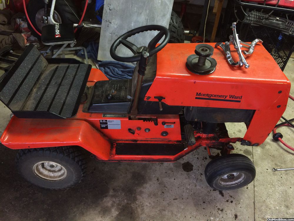

I have an early 80s 30" cut rider mower that I have owned since 1998.
I have had to rebuild the transmission (Forward, Neutral & Reverse only), The Transaxle, front end joints/replaced the axle assembly, made a seat ... well you get the idea .. I really like this little goober ...

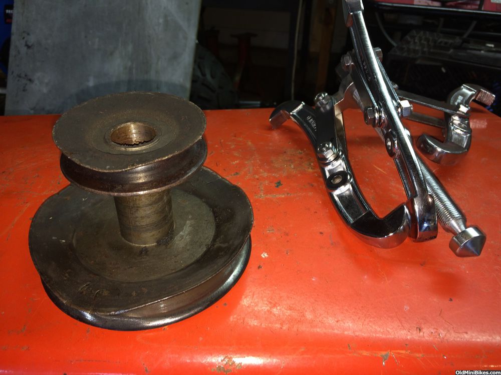

New drive and blade belts came in ... I needed to pull the 2-step engine pulley. Got a Harbor freight 8" 3-jaw gear puller and promptly bent the larger pulley :doah:
but it was still stuck on the shaft.
When I did get it off (but not yet) I noticed the smaller pulley was bent! Huh! I did not know that.
A quick check on eBay shows there is a replacement for $23 delivered.
My lovely wife Deb says, might just be time to buy a new one .. so I start looking new and used everywhere and decide that what I really want is my mower running ... I just need a mower to mow the back yard and pull trailers up and down the hill to my back yard.

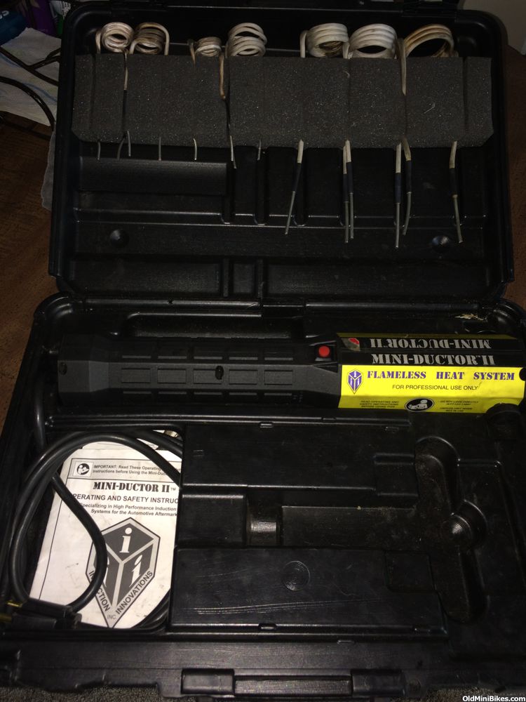

To get around this he bought this Mini Ductor 2 flameless heat kit ...

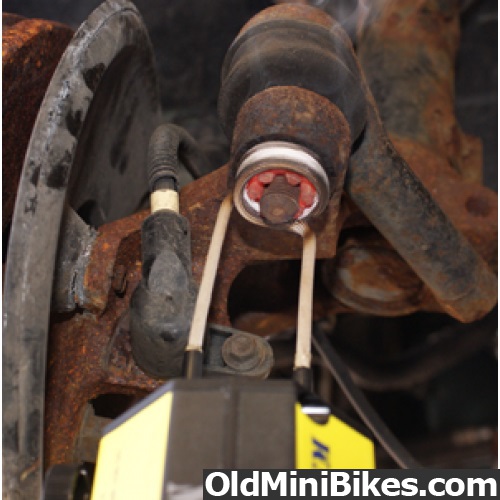

I works by QUICKLY heating what the coils are wrapped around like the pulley shaft and not the motors shaft, meaning I didn't smoke the crankcase seal heating the pulley off!! COOL!
The following pics were taken off the web and are NOT ones I took, they are to give a visual of how the Mini Ductor 2 works.
Notice how the bolt can be held so close to the cherry red nut ...

I'm told the kit Vinnie lent me costs $700
He sternly warned me NOT to use it around anyone with a pacemaker.
