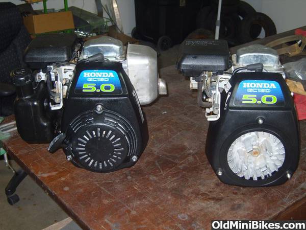

I don't know if you're interested, but I have an otherwise very good running GC-160 which needs a fuel tank and a recoil starter. (about $35 worth of stuff) (the one on the right) I will never use it. Pay shipping and it's yours.
